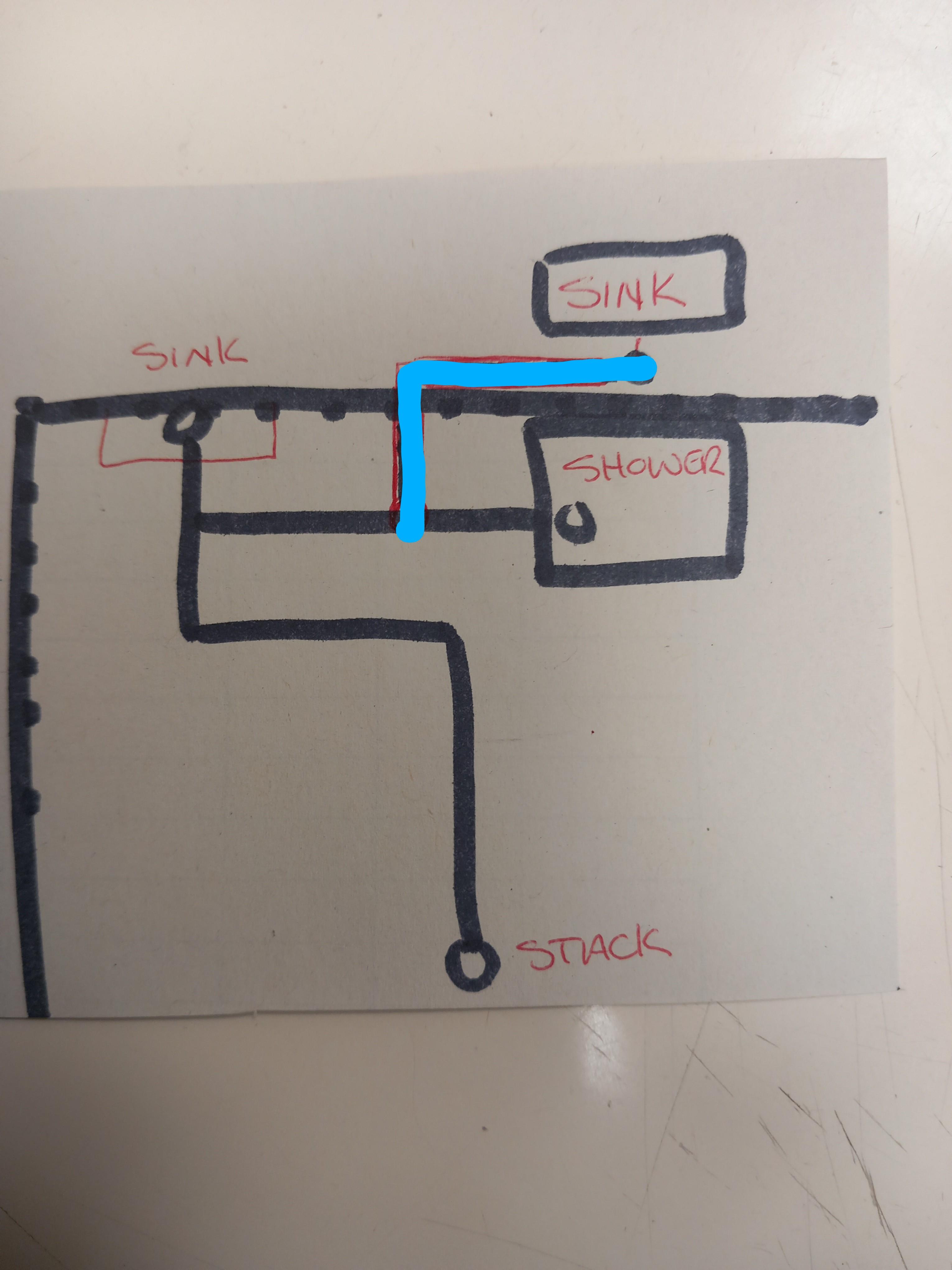

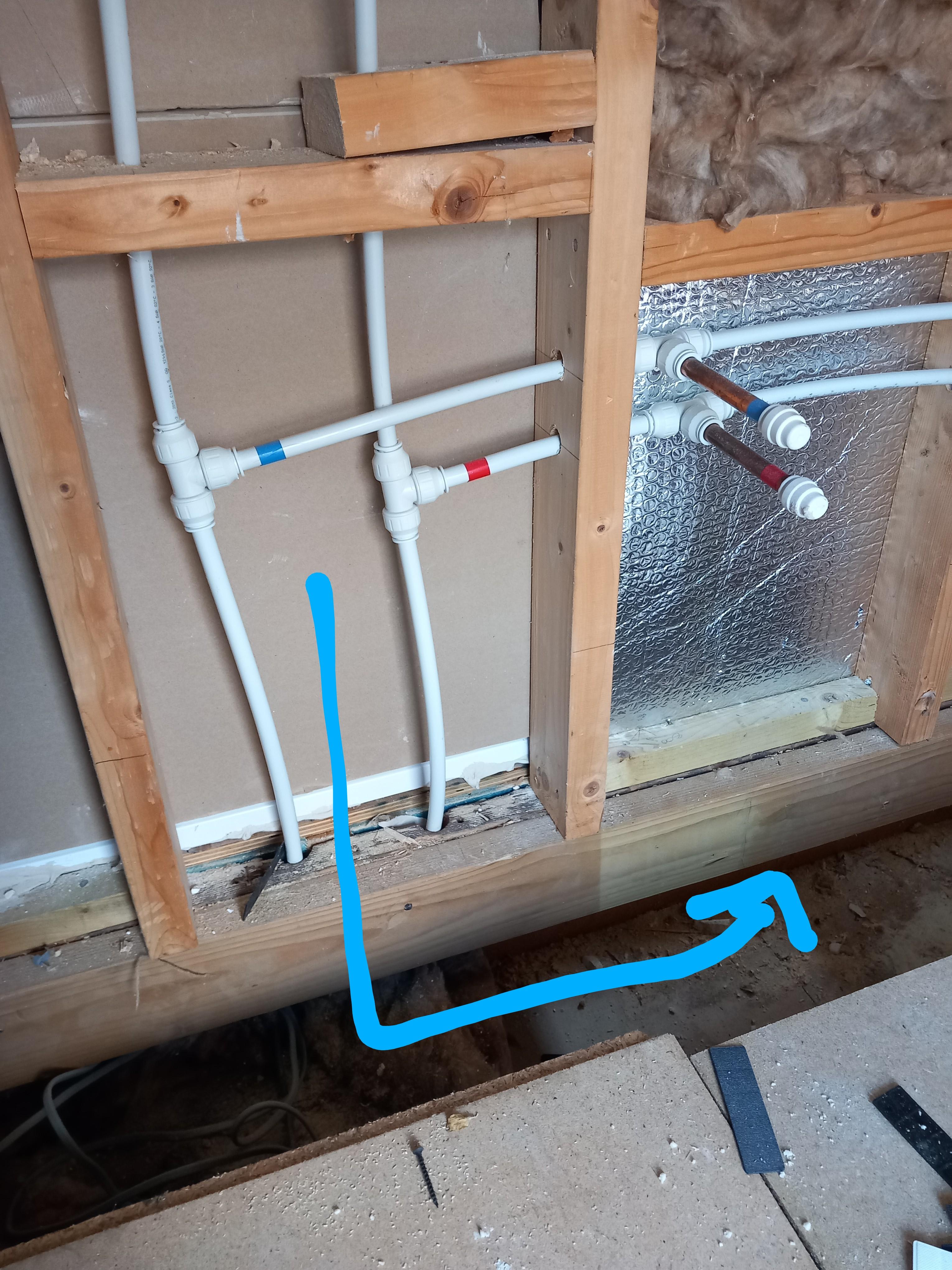

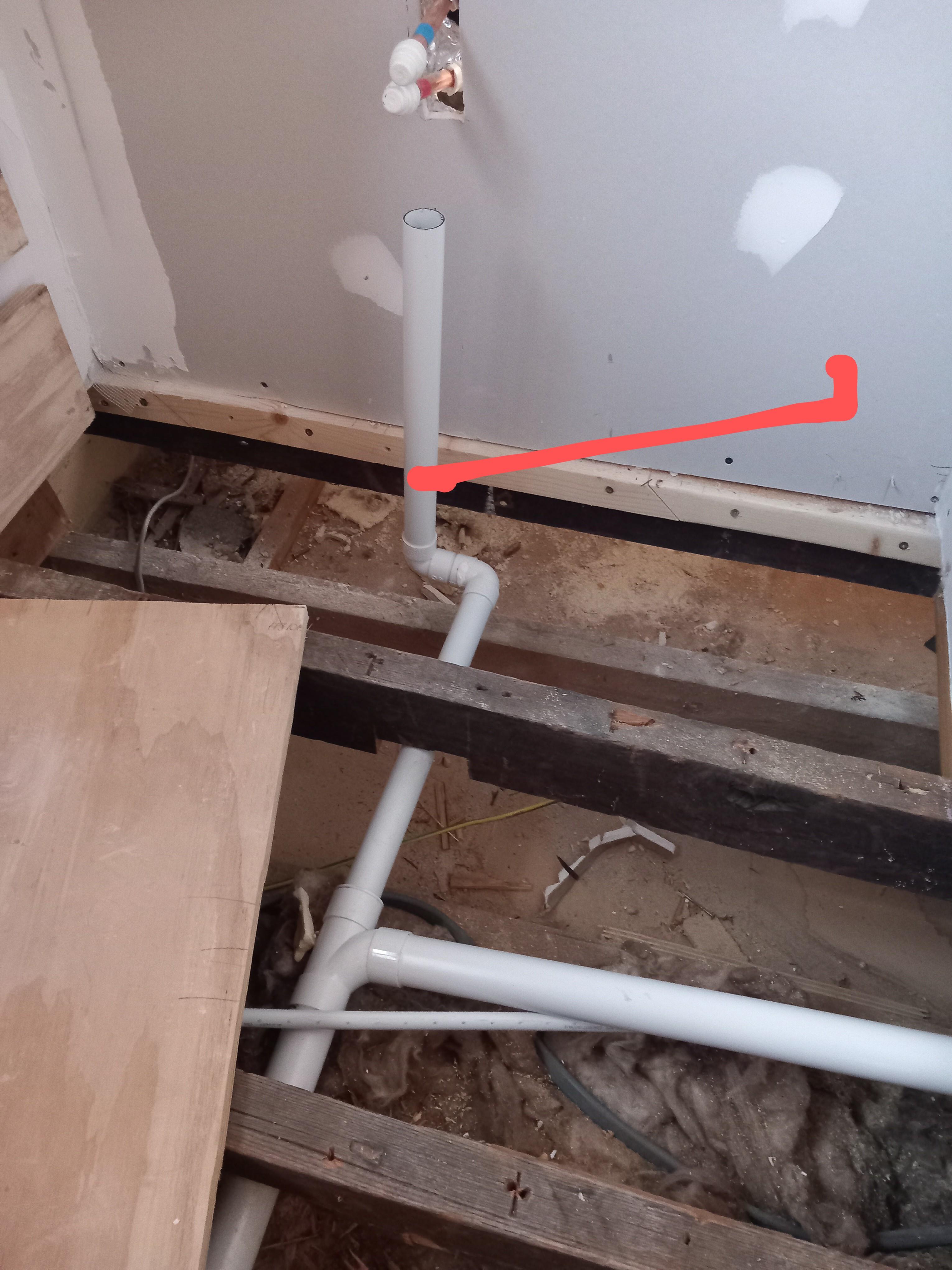

Dee Posted November 29, 2023 Posted November 29, 2023 Hi Ivm having to virtually replump the waste that a £¥([<!^¿ plumber did....'fall' went uphill!! Having corrected that I now need to connect a tiny basin into the shower waste. I have no choice but to route it this way but it was suggested I will need to vent it ??? Where would I put the vent? Picture please on what I need to buy..... I am clueless on this next step! See image of pipe run, the blue is what I'm adding. Also any tips on fitting a weld Y 'T' into an existing pipe run? Yours in desperation, Dee
markc Posted November 29, 2023 Posted November 29, 2023 You may need to vent it, if so then a air admittance valve (AAV) would go at the end of the run and above the sink level, however, you already have another sink on the line and if that isn’t having problems then unlikely the additional one would.
Dee Posted November 29, 2023 Author Posted November 29, 2023 Oh Marc thank you for being here! No sink is installed yet, they're both bathrooms are new installs, just pipe runs so far
markc Posted November 29, 2023 Posted November 29, 2023 @Dee I really can’t see your shower or any basin having enough flow to pull water out of another trap, certainly can and does happen with toilet flushes but in your case I wouldnt bother. Text book installs and reality are different things, if this was my house I wouldnt fit an AAV 1
Dee Posted November 29, 2023 Author Posted November 29, 2023 Thanks! One less job to do. Am I asking for trouble adding the blue line? I've never cut into a pipe before and added a joint.
ToughButterCup Posted November 29, 2023 Posted November 29, 2023 On 29/11/2023 at 08:59, Dee said: ... Am I asking for trouble adding the blue line? I've never cut into a pipe before and added a joint. Expand No. @Dee. Don't let it intimidate you. You need A small sharp fine-bladed saw to cut the pipe A tee joint ( push-fit I suspect) and a couple of 90s (also push-fit) gloves and an old towel a trap for the sink connectors for the taps and a sod-it-I'm-going-to-do-this-grin on your face Heres a good online resource to review before you dive in I searched for >How to make joints in plastic pipes on YooChube https://www.youtube.com/results?search_query=plumbing+plastic+pipe+fittings Detailed photos will help us help you. Look at @Onoff's or @Pocster bathroom thread(s) for examples of how to illustrate your work (cockups) There's not a person on here who doesn't review what's on YT before they start a job. You are not alone Have a look at some of the results of this search https://forum.buildhub.org.uk/search/?&q=bathroom&quick=1&author=Onoff&search_and_or=and&sortby=relevancy 1

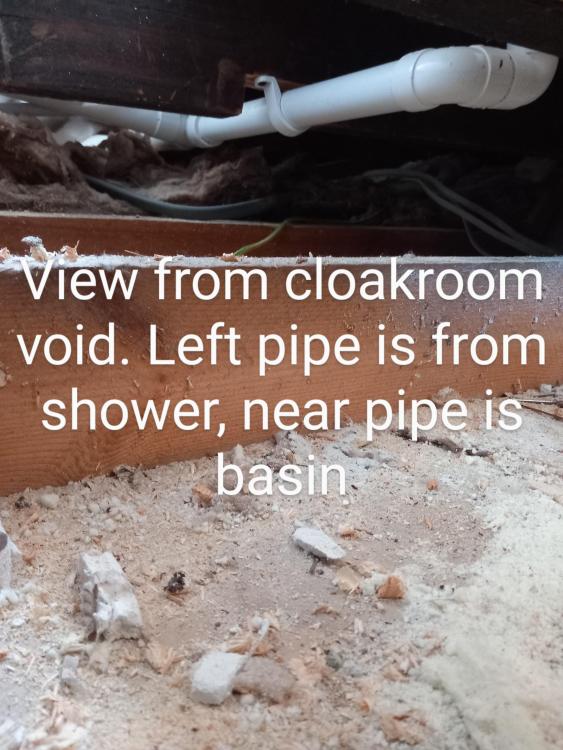

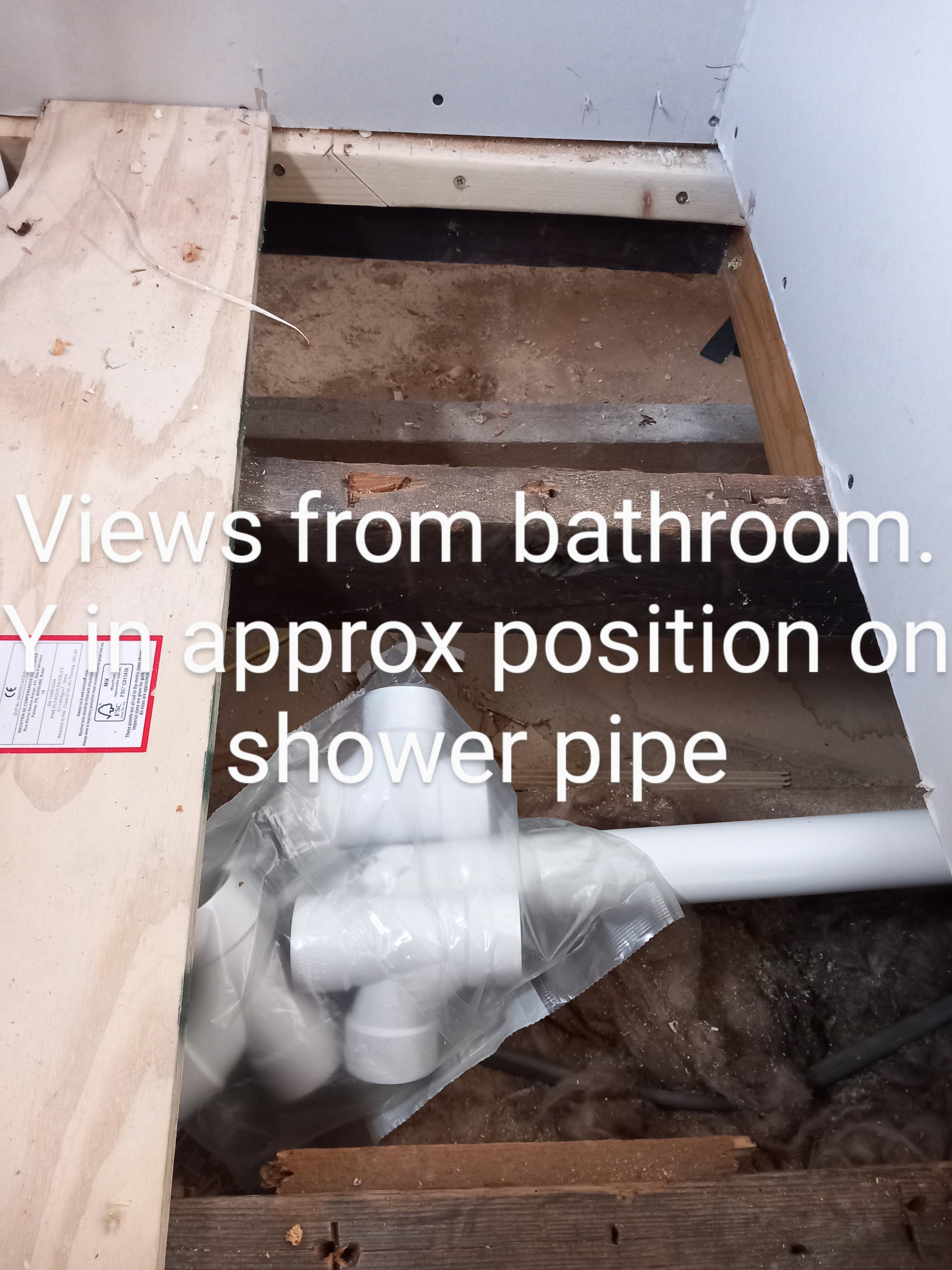

Dee Posted November 29, 2023 Author Posted November 29, 2023 Anyhoo, I've put some images up to illustrate the job. I think I would have to notch too much from joist to get 32mm pipe through into cloakroom.
markc Posted November 29, 2023 Posted November 29, 2023 Don’t notch the joist. Go right (looking at the pic), through the stud and then down through floor plate. 1

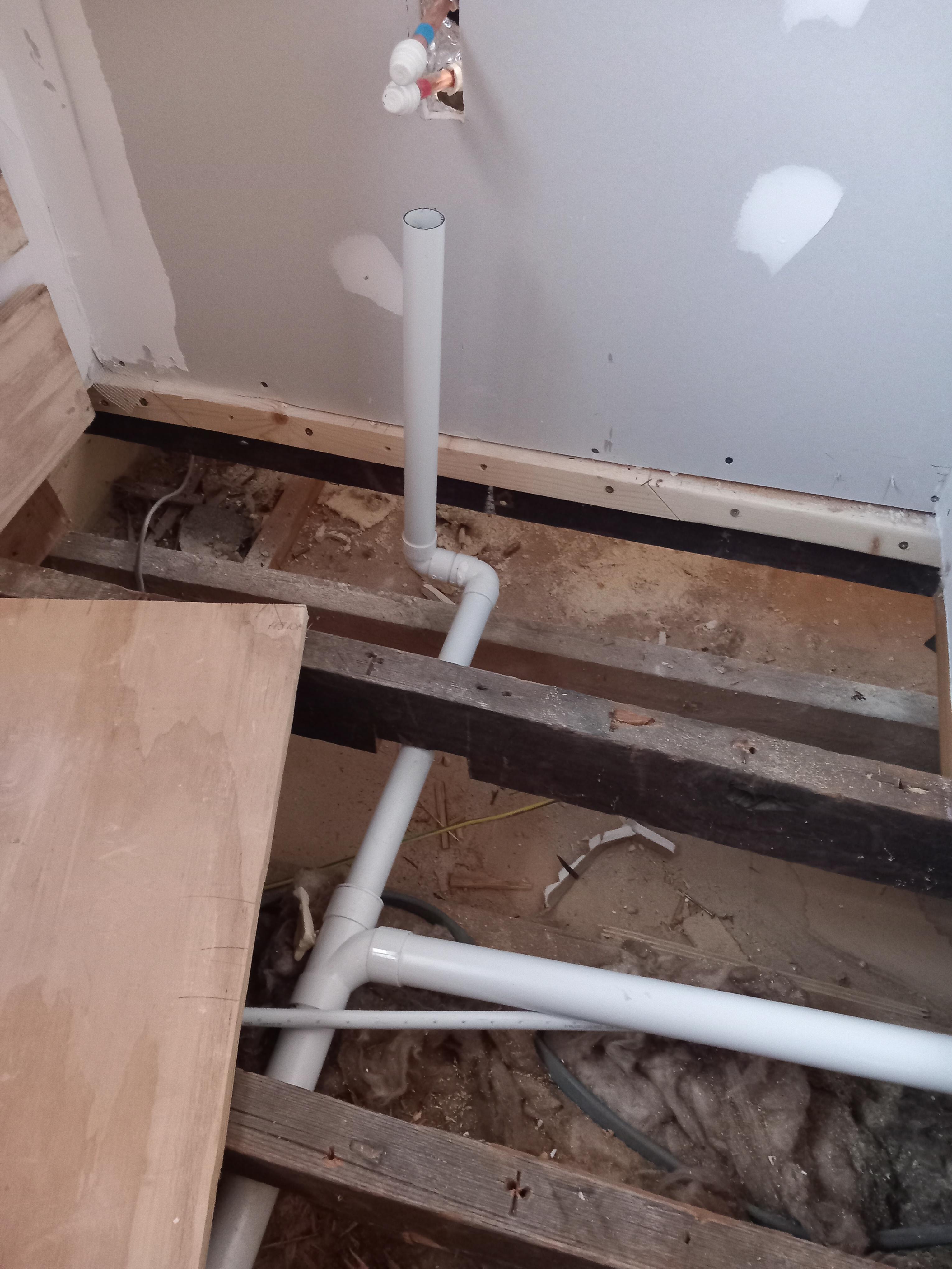

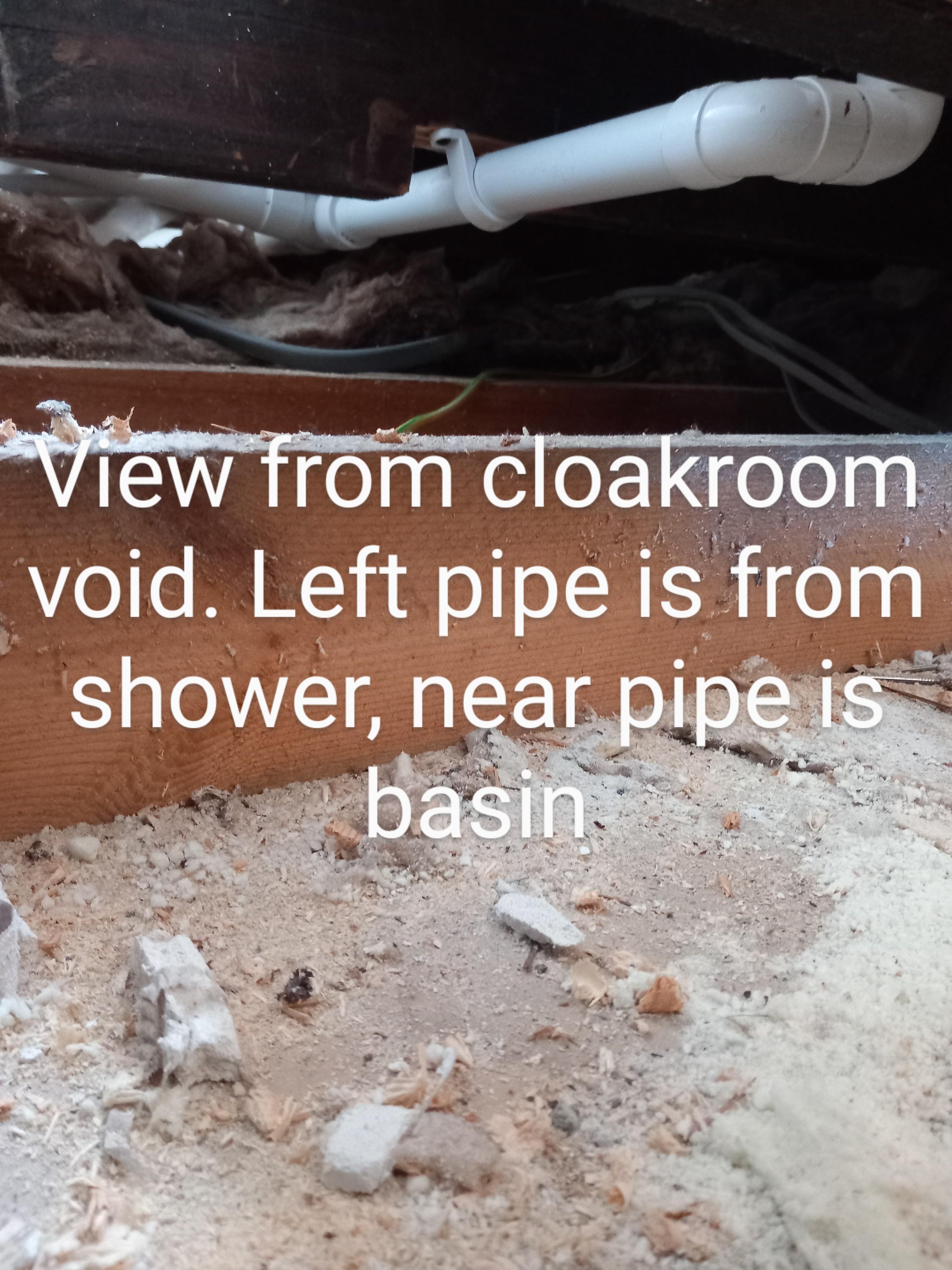

Dee Posted November 30, 2023 Author Posted November 30, 2023 Have I been over thinking this?? I was focusing on connecting the basin on the others idea of the wall into the shower waste....can I instead connect into the basin waste as per the image? If I can, where would I connect to?
Dee Posted November 30, 2023 Author Posted November 30, 2023 Ps. There's barely any fall on the 33mm waste seen in the image but I can't gain any more
markc Posted November 30, 2023 Posted November 30, 2023 (edited) On 30/11/2023 at 15:24, Dee said: Ps. There's barely any fall on the 33mm waste seen in the image but I can't gain any more Expand That’s looking pretty good, fall on a shower or basin isn’t as critical as a soil pipe so any fall is ok. basin waste through wall and into other basil waste is fine, if the basin is on a pedestal then anywhere that works (and is out of sight) Edited November 30, 2023 by markc 1

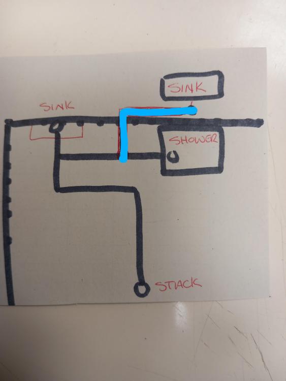

Dee Posted November 30, 2023 Author Posted November 30, 2023 Phew! So can I connect basin B into basin A waste? Badin A waste is in picture If so How and where?
markc Posted November 30, 2023 Posted November 30, 2023 On 30/11/2023 at 15:40, Dee said: Phew! So can I connect basin B into basin A waste? Badin A waste is in picture If so How and where? Expand Another Y piece and anywhere that works

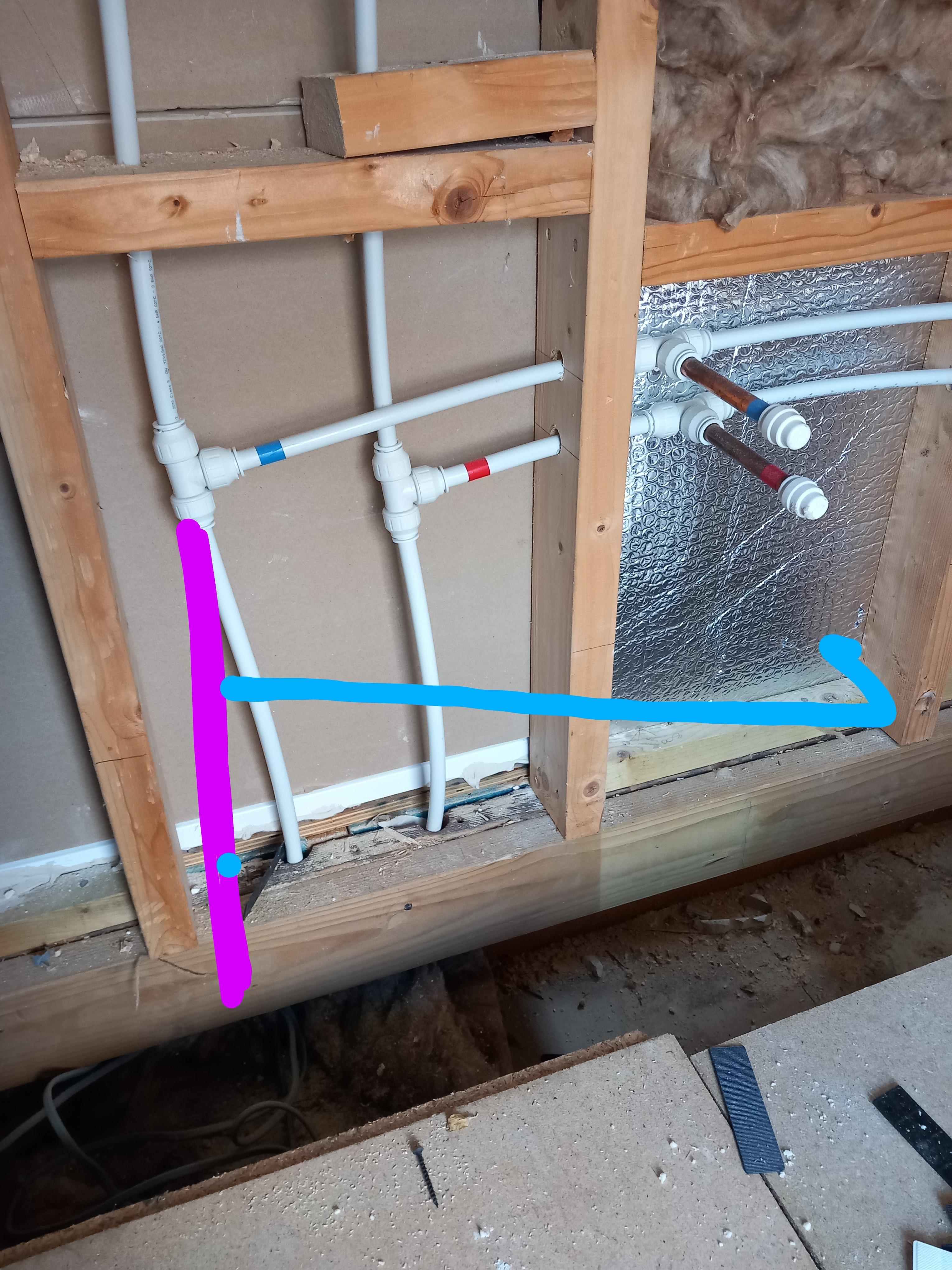

Dee Posted November 30, 2023 Author Posted November 30, 2023 So I think I will have to bring the waste through the wall rather than under the floor and connect to the waste in the image, that way I can get some fall. Can I connect into the vertical but low down? I will understand and get on with it soon....promise!
Dee Posted November 30, 2023 Author Posted November 30, 2023 So, red pipe coming off basin A, through wall, blue connecting to purple basin waste B
Dee Posted November 30, 2023 Author Posted November 30, 2023 Brilliant! Shopping list starting from the red side.... 32mm pipe 1 x Y I x 90⁰ elbow Blue side 1 x 90⁰ elbow 1 x Y (but upside down)

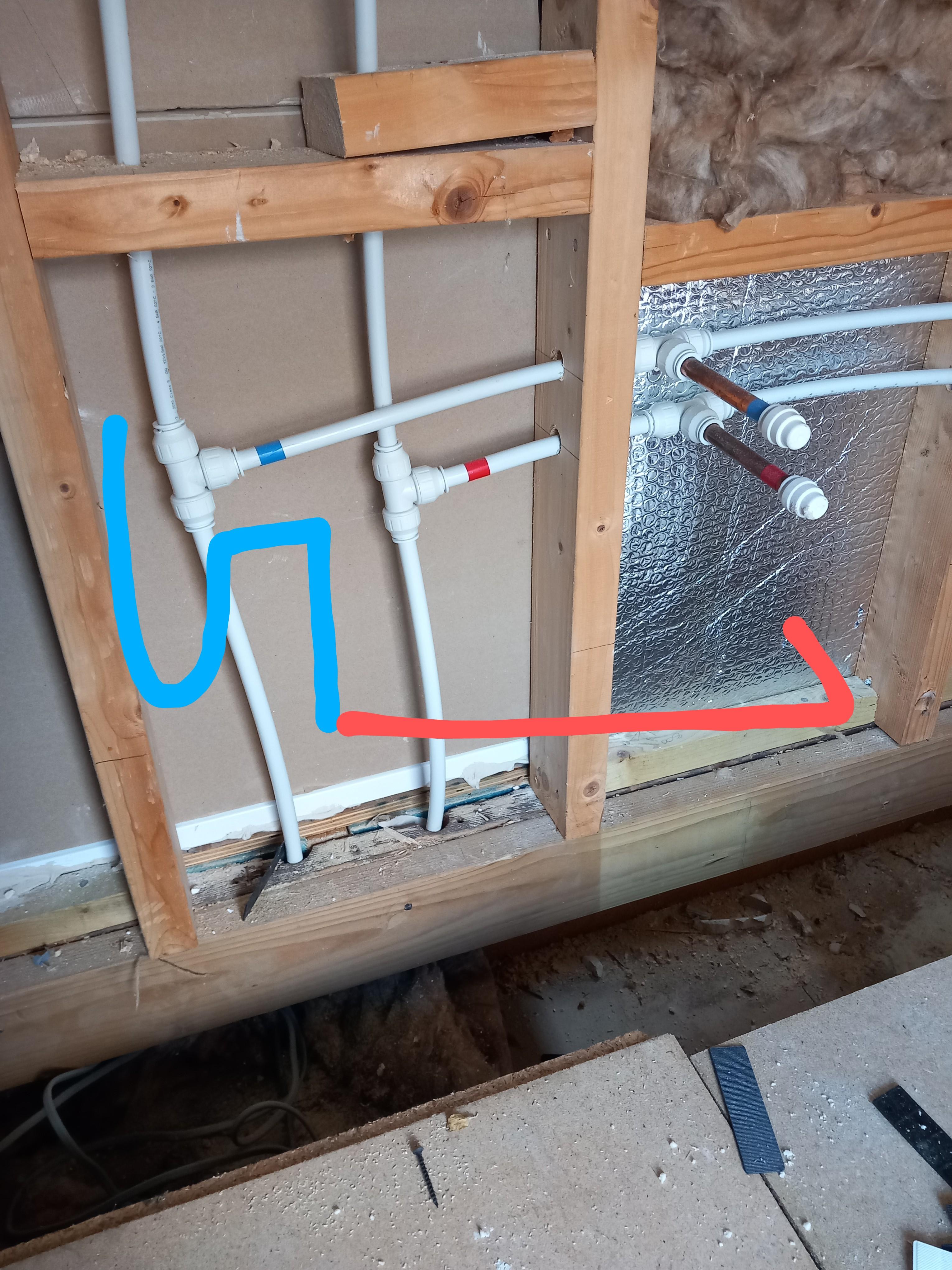

Dee Posted November 30, 2023 Author Posted November 30, 2023 Got that last image wrong....is this right??
