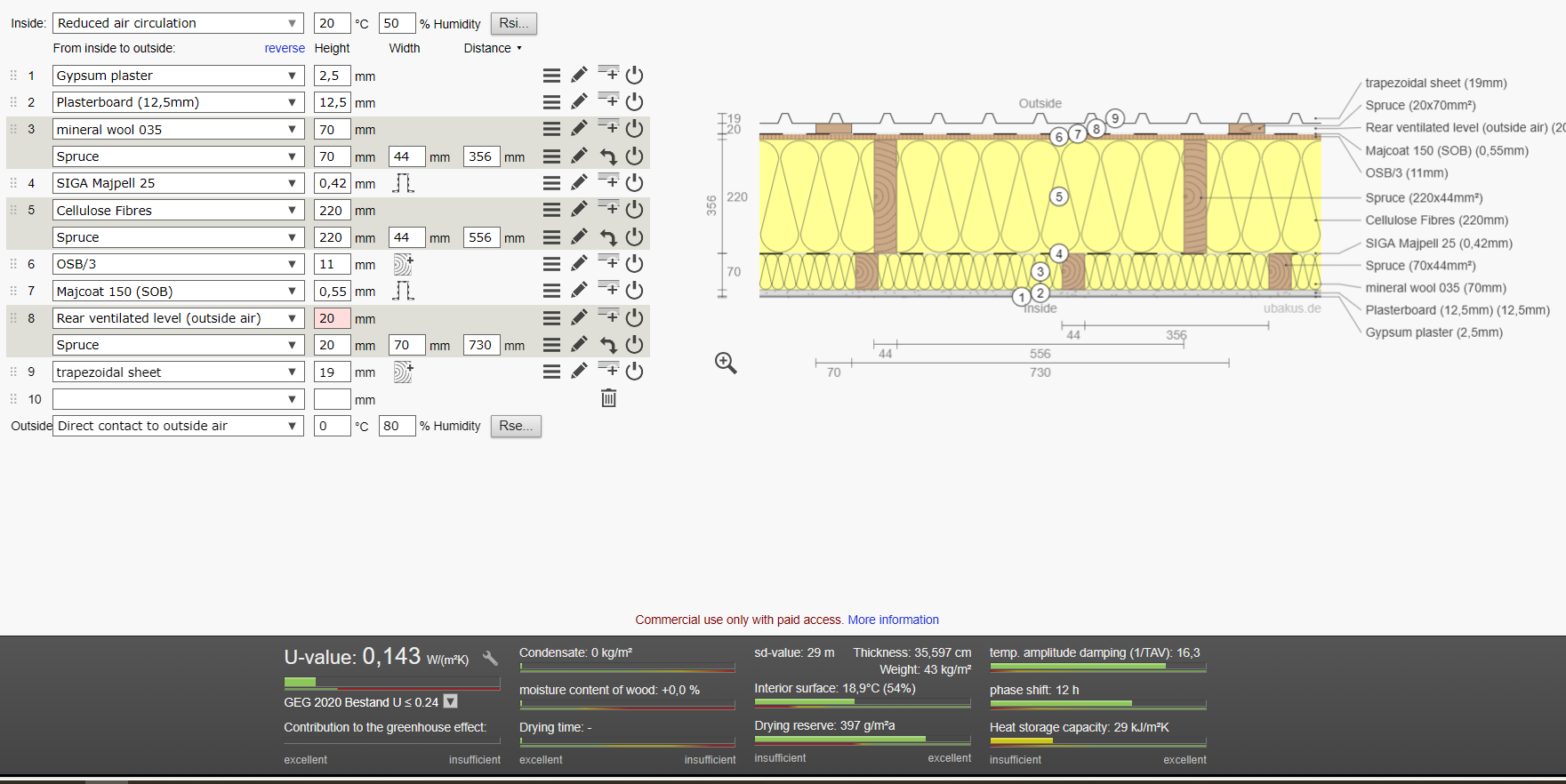

Iceverge Posted November 28, 2023 Share Posted November 28, 2023 Here's a suggested roof build up I've gone for a trapizoidal profile metal roof. Far cheaper and less temperamental than standing seam etc. Also a thinner build-up. as you can effectively ventilate under the sheeting with 20*70mm strapping as fixing battens. Then a good breather membrane. Taped at all joints of course. Then 11mm OSB, for rodent protection, solidity, noise, ease of buildability. 220mm rafters ( if ok with the SE) with densepack cellulose insulation. Great for noise, airtightness, decrement delay etc. A Vapour control layer. A 44*70 mm crossbattened service cavity with mineral wool insulation. It would be enough to accommodate flat uPVC MVHR ducting if needed. If you pushed this to a 88mm or 95mm service cavity you could run semi rigid MVHR ducting no problem. If you could a second layer of standard plasterboard or a single layer of 15mm PB would help with noise. NIC roof buildup.pdf Link to comment Share on other sites More sharing options...
Alan Ambrose Posted November 28, 2023 Share Posted November 28, 2023 (edited) Mineral wool in the service void as it's more practical to install there than cellulose? Any utility in using posi joists rather than standard rafters so you could run MVHR ducting there? Can I ask how you chose 1.4 as a target u-value? Is that a typical optimum value in practice? Edited November 28, 2023 by Alan Ambrose Link to comment Share on other sites More sharing options...

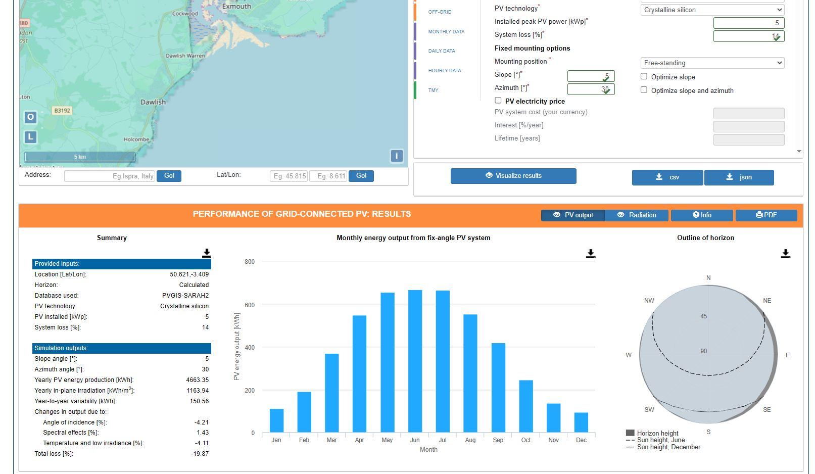

Russdl Posted November 28, 2023 Share Posted November 28, 2023 @Nic A quick comment on the current design, your low pitched roof is facing northwest so not ideal for solar if you were planning on that. Can you slope it south east, that would be much more favourable for PV production and then you could start looking at Passive Plus or more. Link to comment Share on other sites More sharing options...
Nic Posted November 28, 2023 Author Share Posted November 28, 2023 Can’t change the roof aloof as not allowed larger visible mass on the NW side which is of course what o would have preferred for the reasons you mentioned Link to comment Share on other sites More sharing options...
Iceverge Posted November 28, 2023 Share Posted November 28, 2023 3 hours ago, Alan Ambrose said: Mineral wool in the service void as it's more practical to install there than cellulose? Any utility in using posi joists rather than standard rafters so you could run MVHR ducting there? Can I ask how you chose 1.4 as a target u-value? Is that a typical optimum value in practice? You could put cellulose in the service void too but it'd mean cutting holes in the plasterboard to blow it in and a second visit for the installer truck. The main benefits would be already had in the main 220mm depth of the rafters. Namely, decrement delay (phase shift, airtightness enhancement and the ease of install around awkward cuts of timber etc. ( Not a huge factor in this roof) Mineral wool is cheap and if you correctly space the counter battens for the service void can be very quickly fitted. As @Nic mentioned budget I am conscious that posi joists are probably 5 times the price of cut lumber and a special order item rather than an off the shelf thing from a merchants. Beware 220mm timber rafters will need intermediate support. Re the U-Value of 0.14. It's just what emerged given the space constraints. The OP is limited in their height build-up to 350mm. Trade off's need to be had between the cost of materials and performance. A 400mm I beam with cellulose and woodfiber sheathing would be ace but probably 3 times the cost. Similarly PIR between the rafters with PIR underneath would appear cheaper and have a lower U value. However it's very tricky to install the PIR accurately. Differential movement of the timbers and PIR over time will result in gaps and thermal bypass of the insulation. There'll be loads of waste from the PIR boards cuttings. It has a worse decrement delay resulting in poorer summer performance. It'll be much much worse from a noise and airtightness perspective. 1 Link to comment Share on other sites More sharing options...
Nic Posted November 28, 2023 Author Share Posted November 28, 2023 4 hours ago, Iceverge said: Here's a suggested roof build up I've gone for a trapizoidal profile metal roof. Far cheaper and less temperamental than standing seam etc. Also a thinner build-up. as you can effectively ventilate under the sheeting with 20*70mm strapping as fixing battens. Then a good breather membrane. Taped at all joints of course. Then 11mm OSB, for rodent protection, solidity, noise, ease of buildability. 220mm rafters ( if ok with the SE) with densepack cellulose insulation. Great for noise, airtightness, decrement delay etc. A Vapour control layer. A 44*70 mm crossbattened service cavity with mineral wool insulation. It would be enough to accommodate flat uPVC MVHR ducting if needed. If you pushed this to a 88mm or 95mm service cavity you could run semi rigid MVHR ducting no problem. If you could a second layer of standard plasterboard or a single layer of 15mm PB would help with noise. thanks once again How are Solar connected through the roof sheet? I know on the standing seam style they have an external clamp that attaches to the seams 4 hours ago, Iceverge said: NIC roof buildup.pdf 1007.31 kB · 4 downloads Link to comment Share on other sites More sharing options...

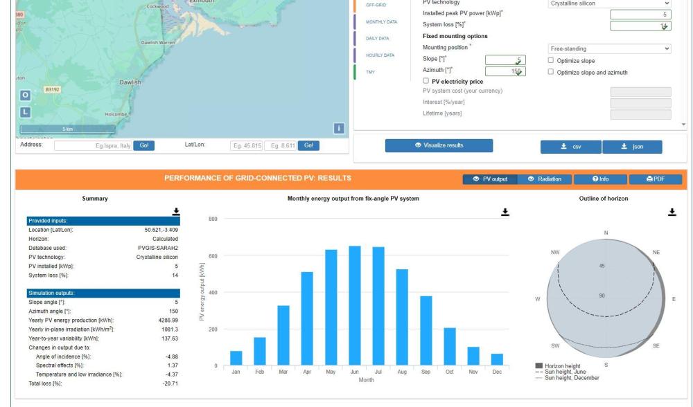

Iceverge Posted November 28, 2023 Share Posted November 28, 2023 27 minutes ago, Russdl said: @Nic A quick comment on the current design, your low pitched roof is facing northwest so not ideal for solar if you were planning on that. Can you slope it south east, that would be much more favourable for PV production and then you could start looking at Passive Plus or more. Good thinking. It makes a difference but not as much as you'd thing at very low pitch angles. Here's the north facing one from PVGIS. Here's the South . The difference is only about 300kWh/year. It'd be easily compensated for by adding a single extra solar panel. @Nic I would consider moving all the PV to the roof in one block. Less lightly to suffer differential shading which I gather it doesn't like unless you have some clever inverter gizmos. Some PV guru's could probably enlighten me. 1 Link to comment Share on other sites More sharing options...

Nic Posted November 28, 2023 Author Share Posted November 28, 2023 14 minutes ago, Iceverge said: Good thinking. It makes a difference but not as much as you'd thing at very low pitch angles. Here's the north facing one from PVGIS. Here's the South . The difference is only about 300kWh/year. It'd be easily compensated for by adding a single extra solar panel. @Nic I would consider moving all the PV to the roof in one block. Less lightly to suffer differential shading which I gather it doesn't like unless you have some clever inverter gizmos. Some PV guru's could probably enlighten me. Can’t change the roof slope as not allowed a larger visible mass on the NW side !! which is of course what I would have preferred for the reasons mentioned Link to comment Share on other sites More sharing options...

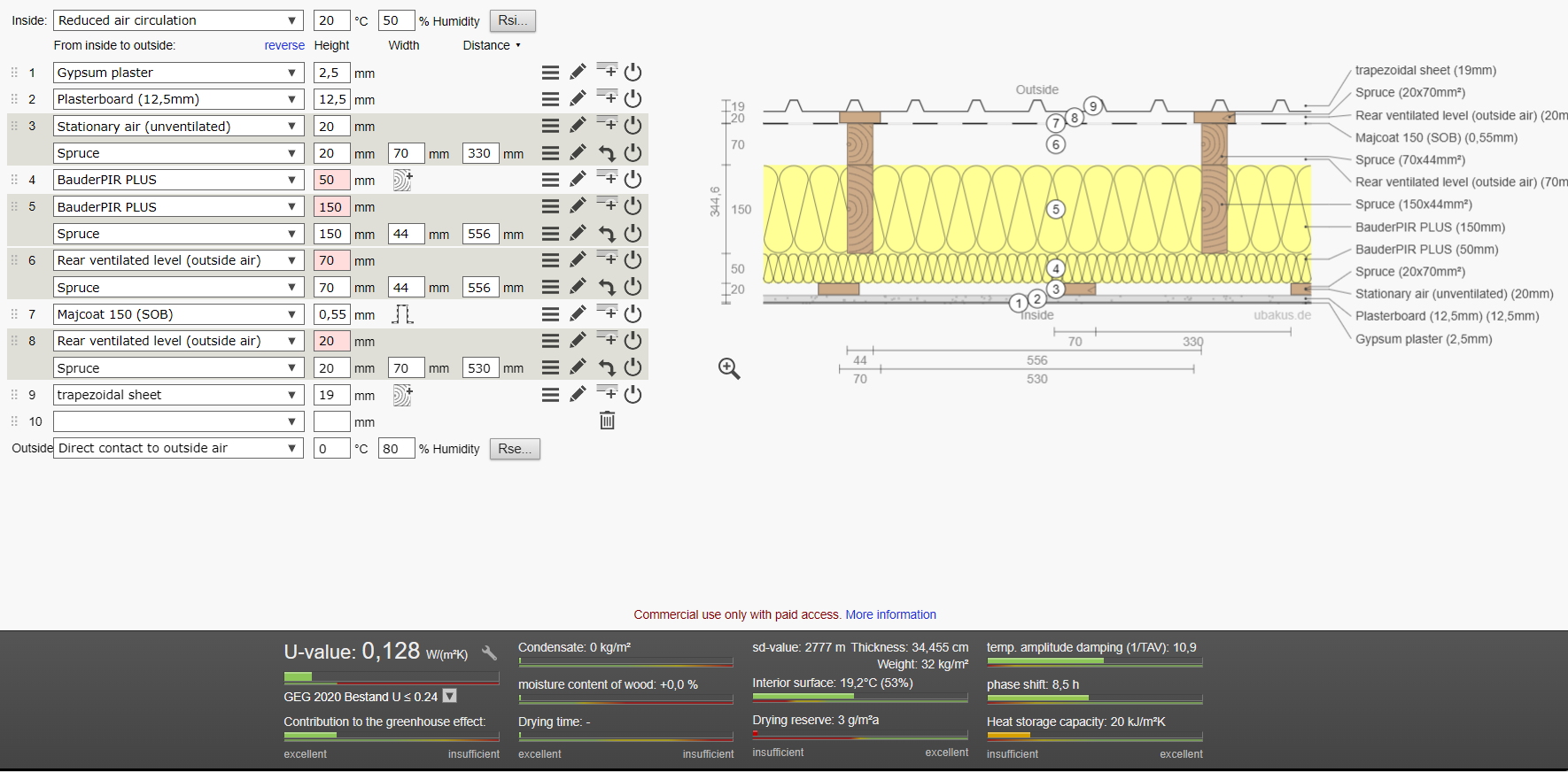

Nic Posted December 3, 2023 Author Share Posted December 3, 2023 On 28/11/2023 at 11:11, Iceverge said: Here's a suggested roof build up I've gone for a trapizoidal profile metal roof. Far cheaper and less temperamental than standing seam etc. Also a thinner build-up. as you can effectively ventilate under the sheeting with 20*70mm strapping as fixing battens. Then a good breather membrane. Taped at all joints of course. Then 11mm OSB, for rodent protection, solidity, noise, ease of buildability. 220mm rafters ( if ok with the SE) with densepack cellulose insulation. Great for noise, airtightness, decrement delay etc. A Vapour control layer. A 44*70 mm crossbattened service cavity with mineral wool insulation. It would be enough to accommodate flat uPVC MVHR ducting if needed. If you pushed this to a 88mm or 95mm service cavity you could run semi rigid MVHR ducting no problem. If you could a second layer of standard plasterboard or a single layer of 15mm PB would help with noise. NIC roof buildup.pdf 1007.31 kB · 9 downloads can anyone recommend a good roofer in the Exmouth area? Link to comment Share on other sites More sharing options...
