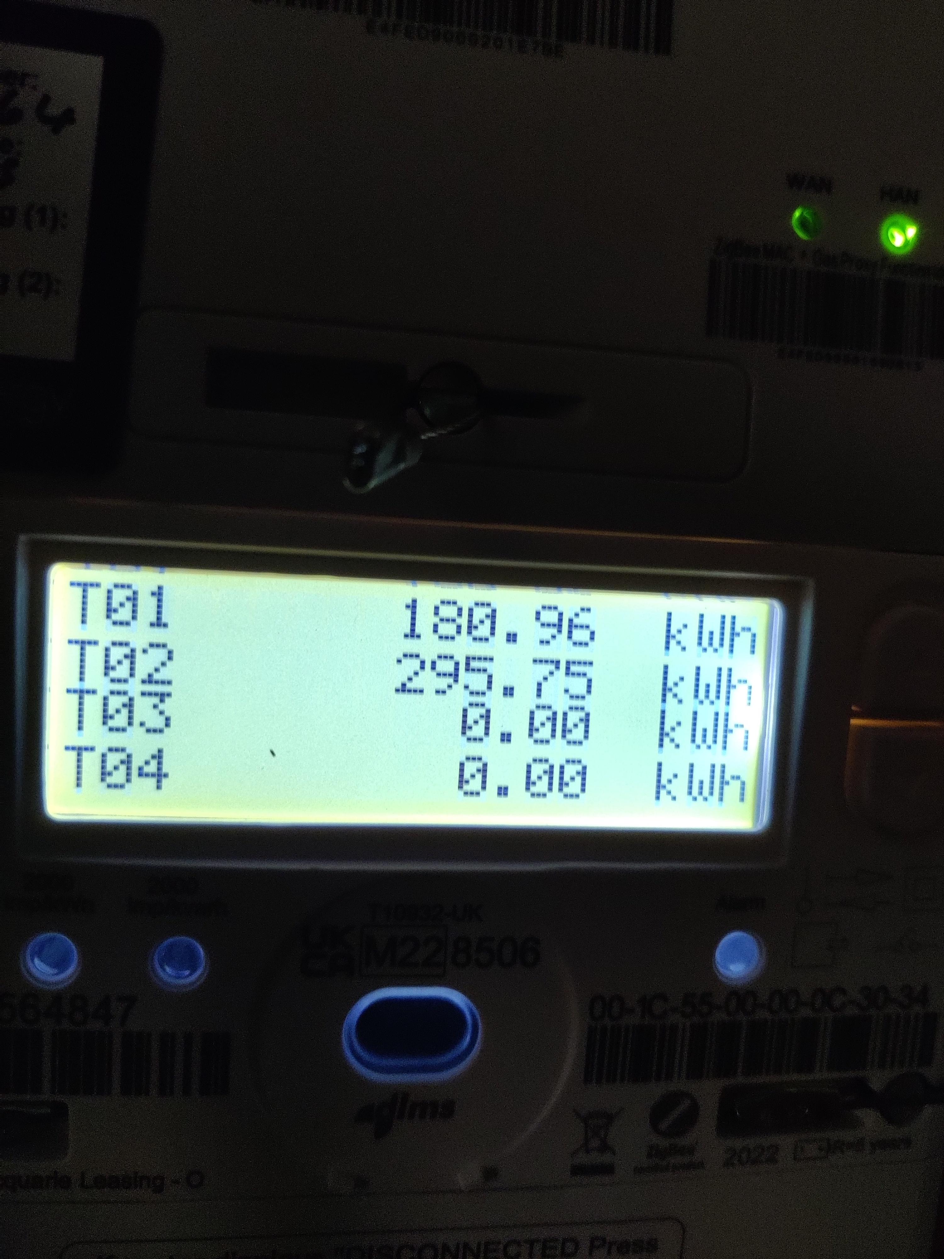

JohnMo Posted November 22, 2023 Posted November 22, 2023 I have just moved to E7 on a new build. Smart meter is installed, although due to where I live doesn't communicate, so it's a dumb smart meter. It has a day and night rate and I just record the readings manually. This what it looks like, a day and night rate. Not sure how you get around for your 24/7 heaters.

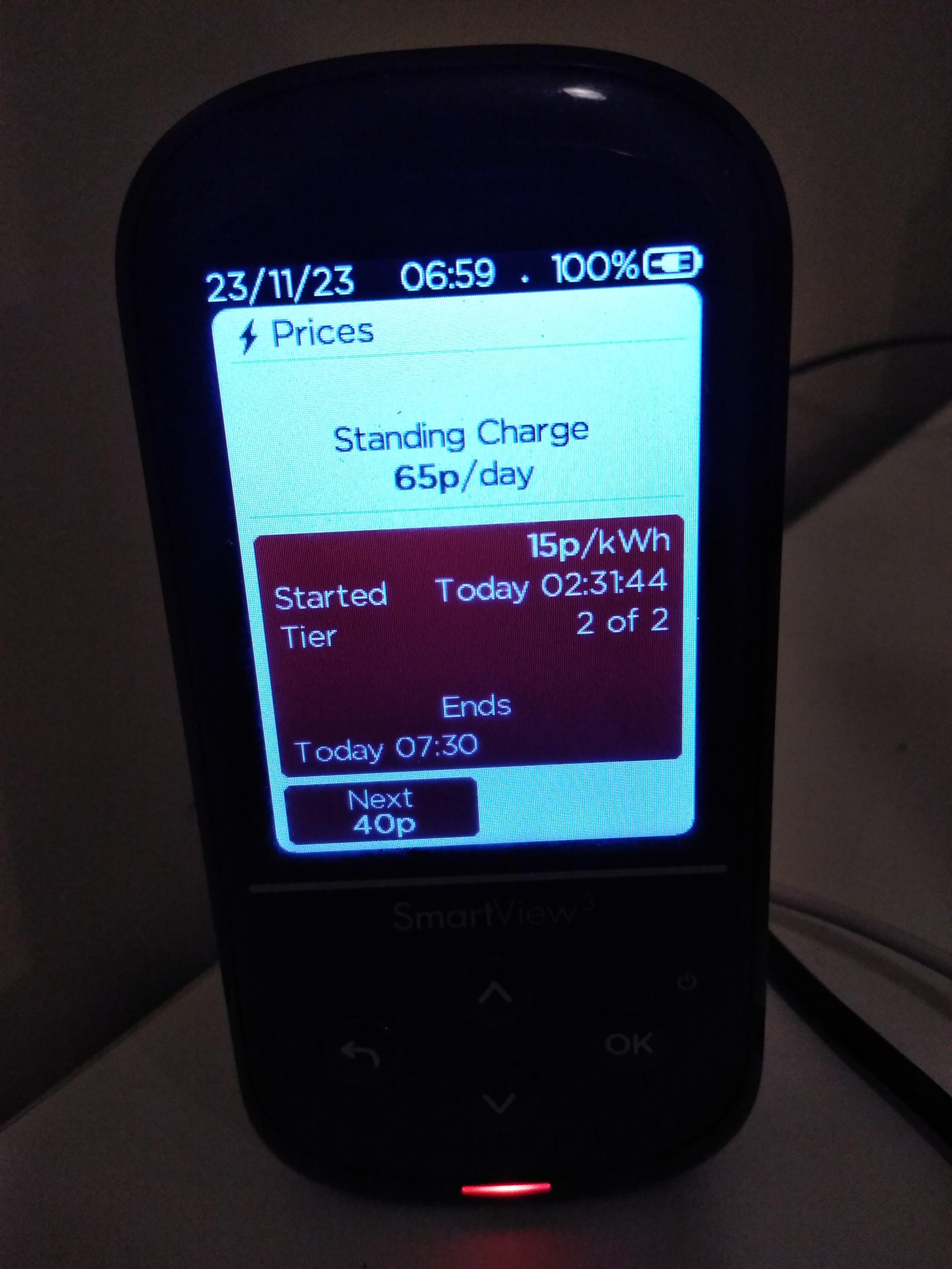

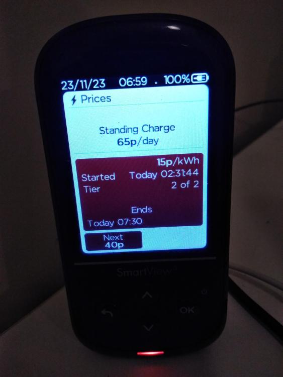

SteamyTea Posted November 23, 2023 Posted November 23, 2023 The E7 timings are programmed into my meter. The only reason I bothered to get the meter changed was because EDF said the old radio single one was going to be turned off in a few weeks time (was back in May).
JohnMo Posted November 23, 2023 Posted November 23, 2023 2 minutes ago, SteamyTea said: The E7 timings are programmed into my meter. The only reason I bothered to get the meter changed was because EDF said the old radio single one was going to be turned off in a few weeks time (was back in May). Are only getting 02:30 to 07:30 on E7?
SteamyTea Posted November 24, 2023 Posted November 24, 2023 8 hours ago, JohnMo said: Are only getting 02:30 to 07:30 on E7? I think I get an hour thrown in before midnight. I am usually asleep by then. It was that hour I initially locked out with secondary timers as it seemed pointless. I only use 4 hours of the E7 window at most and I think I can get away with using just 3 of them.
