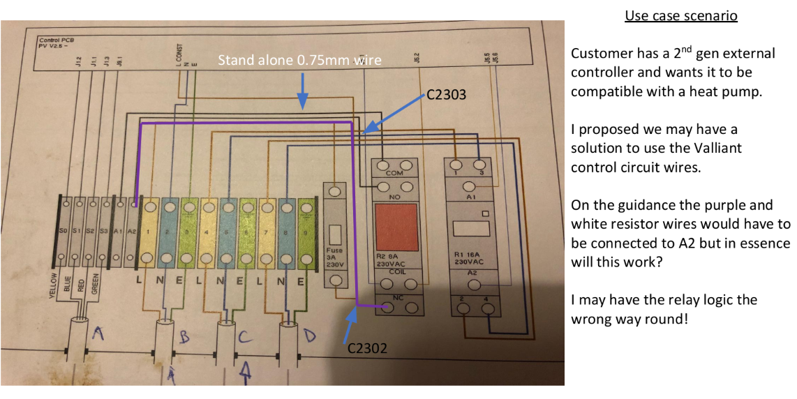

Beelbeebub Posted December 23, 2023 Share Posted December 23, 2023 10 minutes ago, JohnMo said: Two resistors, 10p each and a relay in a box £5 to £10. No programming or anything special. Plus you need to output a resistance not input it. Taking an on off call for heat from the eDual and output a resistance to fool the ASHP into starting DHW heating. I thought it was the edual that required the resistance? A number of HPs can take an on/off input to start DHW mode Link to comment Share on other sites More sharing options...
JohnMo Posted December 23, 2023 Share Posted December 23, 2023 21 minutes ago, Beelbeebub said: thought it was the edual that required the resistance? A number of HPs can take an on/off input to start DHW mode Agreed, mine does, but means you cannot use the multi purpose contacts fir other things. The OP said On 19/12/2023 at 17:07, oranjeboom said: dealings with Sunamp and installer is that the controller on eDuals would need to be replaced as these have " a switching circuit which won’t be compatible with most heat pump controls as they utilise a resistance reading to generate a demand or satisfied call So possibly his heat pump will not have on/off contacts or the installer hasn't read that far in to the installer manual. Link to comment Share on other sites More sharing options...
Beelbeebub Posted December 23, 2023 Share Posted December 23, 2023 1 hour ago, JohnMo said: So possibly his heat pump will not have on/off contacts or the installer hasn't read that far in to the installer manual. Wouldn't surprise me if it was the latter - HPs, especially the Asian ones seem to have a massive array of functionality for every conceivable circumstance. Link to comment Share on other sites More sharing options...

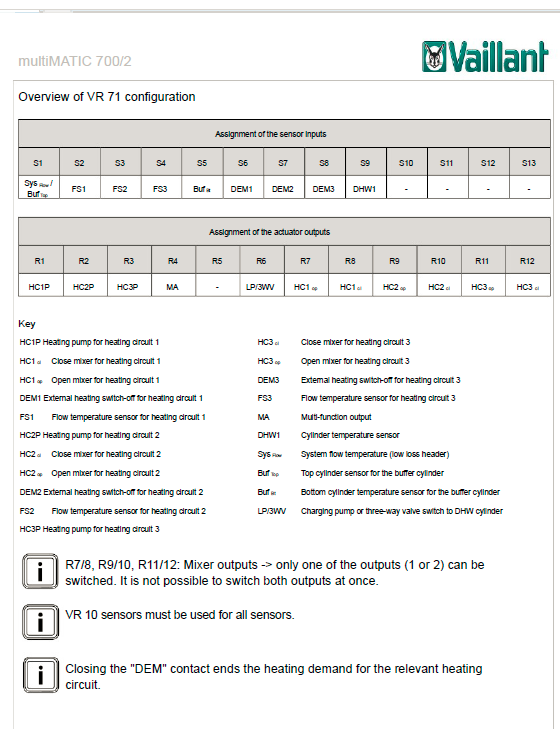

sharpener Posted January 20, 2024 Share Posted January 20, 2024 (edited) 38 minutes ago, oranjeboom said: Can you give me any examples? Here is the connection diagram for the Vaillant VR71 interface box. You can see that terminals S6, S7 and S8 are used for the heat demands for up to 3 different zones. Note 3 says they are contacts closed to stop heating, this is the reverse of the usual convention but it can anyway be changed to "closed for heat" in the installer menu. In my case the zones will be rads, UFH and a thermal store. Vaillant have signed off the schematics with the Honeywell external controls connected to S6, the existing UFH manifold controls to S7 and a timeswitch to S8 so I am 100% confident they are happy with external third party controls, and a simple contact closure from your Sunamp (of either sense) should work fine. I do not know whether the Sunamp should be treated as a separate zone or as a substitute for the usual HW cylinder. Your installers should agree a set of schematic diagrams with Vaillant for your Sunamp application, they will not support it unless the design is signed off like that. If you can get them to give you a copy and post it here we can tell you more. Edited January 20, 2024 by sharpener 1 Link to comment Share on other sites More sharing options...

oranjeboom Posted January 22, 2024 Author Share Posted January 22, 2024 On 20/01/2024 at 12:35, sharpener said: Here is the connection diagram for the Vaillant VR71 interface box I've spent a while trying to find this online, as I'm hoping to send this to my installer to see what he thinks. Is this online also? I tried looking under Vaillant also....but no.... Thank you! Link to comment Share on other sites More sharing options...
sharpener Posted January 22, 2024 Share Posted January 22, 2024 (edited) 43 minutes ago, oranjeboom said: Is this online also? https://www.manualslib.com/manual/1583441/Vaillant-Multimatic-700-2.html?page=94#manual Also I see Neil Gascoigne reports his Sunamp has an internal temp sensor which takes the place of the Vaillant VR10 DHW sensor and is wired to the corresponding terminals in place of it. I think these are SP1 on the Heat Pump Interface unit (not the VR71 itself). Edited January 22, 2024 by sharpener 1 Link to comment Share on other sites More sharing options...

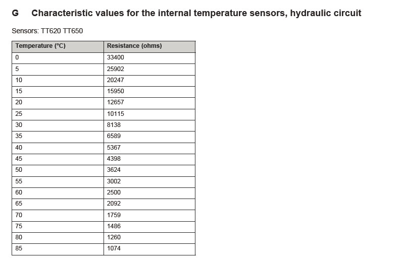

oranjeboom Posted February 21, 2024 Author Share Posted February 21, 2024 On 20/01/2024 at 12:35, sharpener said: I do not know whether the Sunamp should be treated as a separate zone or as a substitute for the usual HW cylinder. Your installers should agree a set of schematic diagrams with Vaillant for your Sunamp application, they will not support it unless the design is signed off like that. If you can get them to give you a copy and post it here we can tell you more. So this is what the installer has come up with in tandem with Vaillant (see PDF). Still awaiting for Sunamp to review and approve that. Sunamp also came back with this suggested fix for the external Sunamp control unit (which I have questioned whether this is their 'final' solution as the wording seems a bit haphazard!): Vailant and sunamp schematic (1).pdf Link to comment Share on other sites More sharing options...
sharpener Posted February 22, 2024 Share Posted February 22, 2024 So yes, Vaillant's schematic is treating the SA just like a hw tank. SP1 is the input for their usual VR10 thermistor sensor on/in the tank. AFAIK it's not an input that can accept a demand signal from voltage-free contacts. Maybe they just are using it to short out the sensor inputs, this would simulate a high temp signal and so turn the DHW off? Don't understand the connections shown to terms 3 & 4 on the SA as the inline pic shows 3 is the earth of flex B and 4 is the live of flex C. Live applied to SP1 will probably blow it up so they are presumbably referring to a different set of terms somewhere else. If you need to control the HP's DHW output from contact closures there are two ways I can think of. 1. This morning I had a conversation with one of Vaillant's systems people and he said a contact across terms ME will force DHW on until it is satisfied and after that force the heating on so long as it continues. This is intended for getting the HP to run whenever there is surplus PV or off-peak electricity available regardless of the schedules. You would have to think carefully about the timings for this. 2. You could fit an VR71 expansion box and configure a second zone as a DHW zone and then use contacts across S7 to control it. Try the installation menu in the simulator here, you will see if you do this then the available settings become those for a DHW circuit not a heating circuit. Sorry I don't know enough about SA connections so the reference to purple/white resistor wiring passes over my head. What are they trying to achieve with it? What does Rly 2 normally do and why do they want to reverse the sense of it? What needs controlling about the SA anyway, the HP will supply heat when its DHW schedule demands it and it will stop when SP1 says it is hot enough. Link to comment Share on other sites More sharing options...
