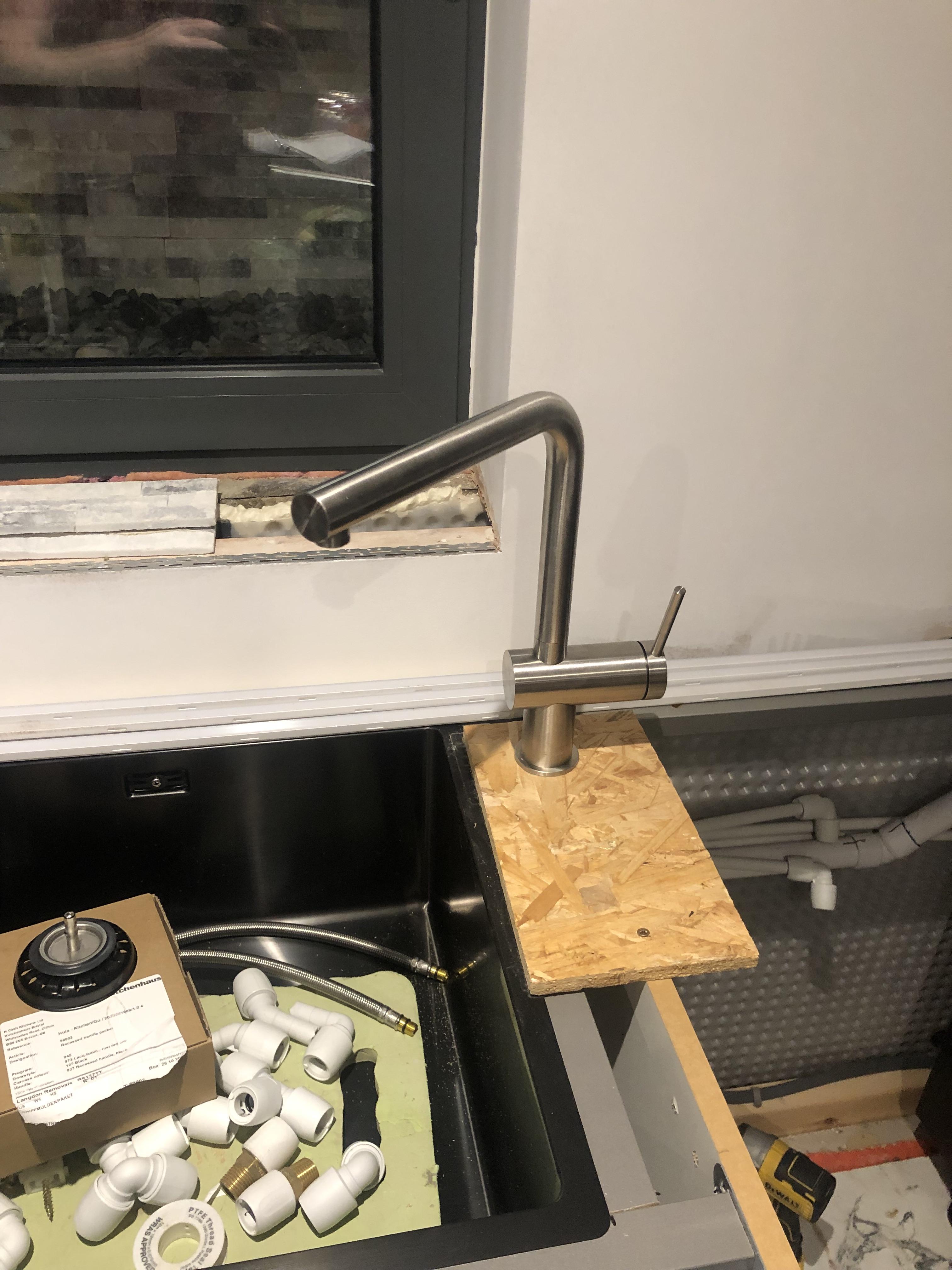

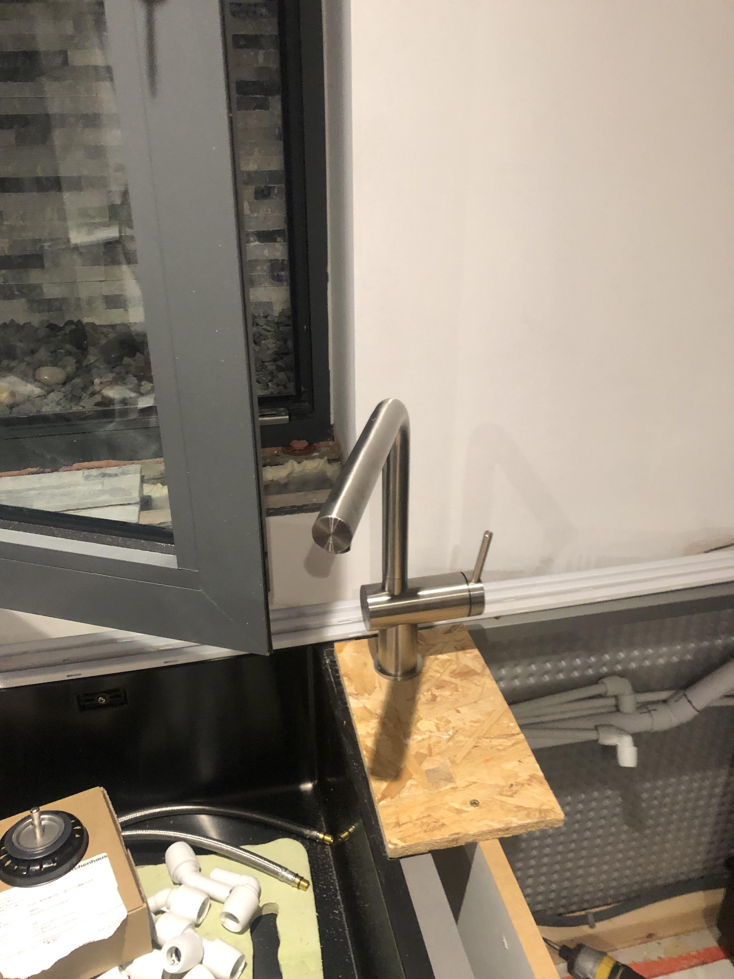

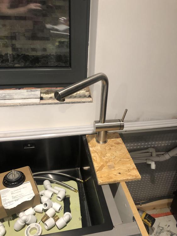

Pocster Posted November 24, 2023 Author Share Posted November 24, 2023 23 minutes ago, Mr Punter said: I would set it forward a fair bit. Ours has 65mm of worktop at the front, 140mm at the back. Too close to the back and you won't be able to clean around the tap base and fitting the tap will be a pain. Also you will have to lean over more. Mastic before you fit the tap. Can’t get 65 and 140 🫤 Tap *has* to go to the right and away from the back ( otherwise window won’t open past tap ) Link to comment Share on other sites More sharing options...

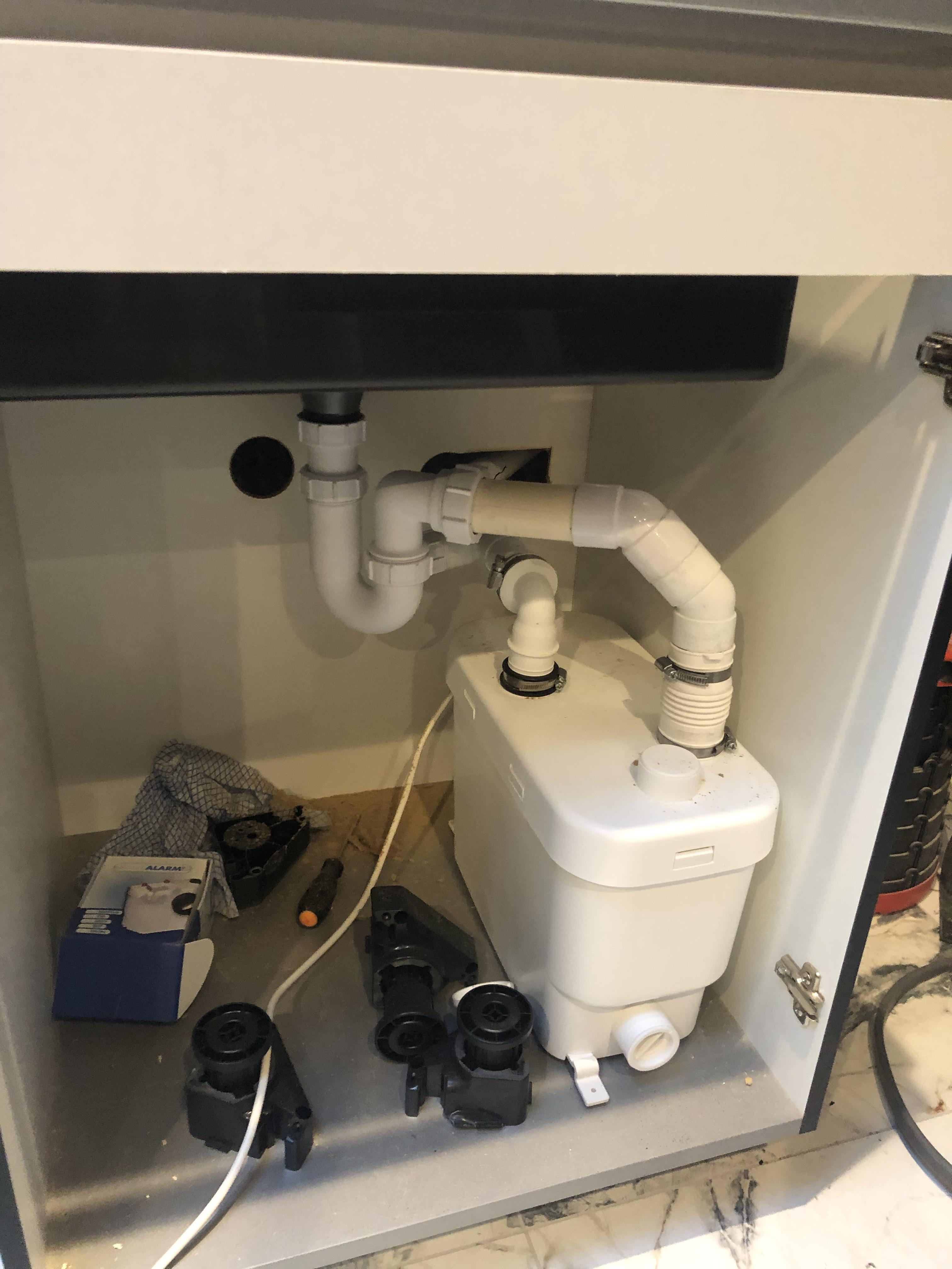

Pocster Posted November 24, 2023 Author Share Posted November 24, 2023 Plumbings for girls ! Once again a few hours on a Friday = a weeks lack of productivity. Horizontal pipe a bit of a kink . Used ‘bits’ I found round the site ( bottle trap might be better tbh ) . Tested and works ! 👍 ( for now ) 1 Link to comment Share on other sites More sharing options...

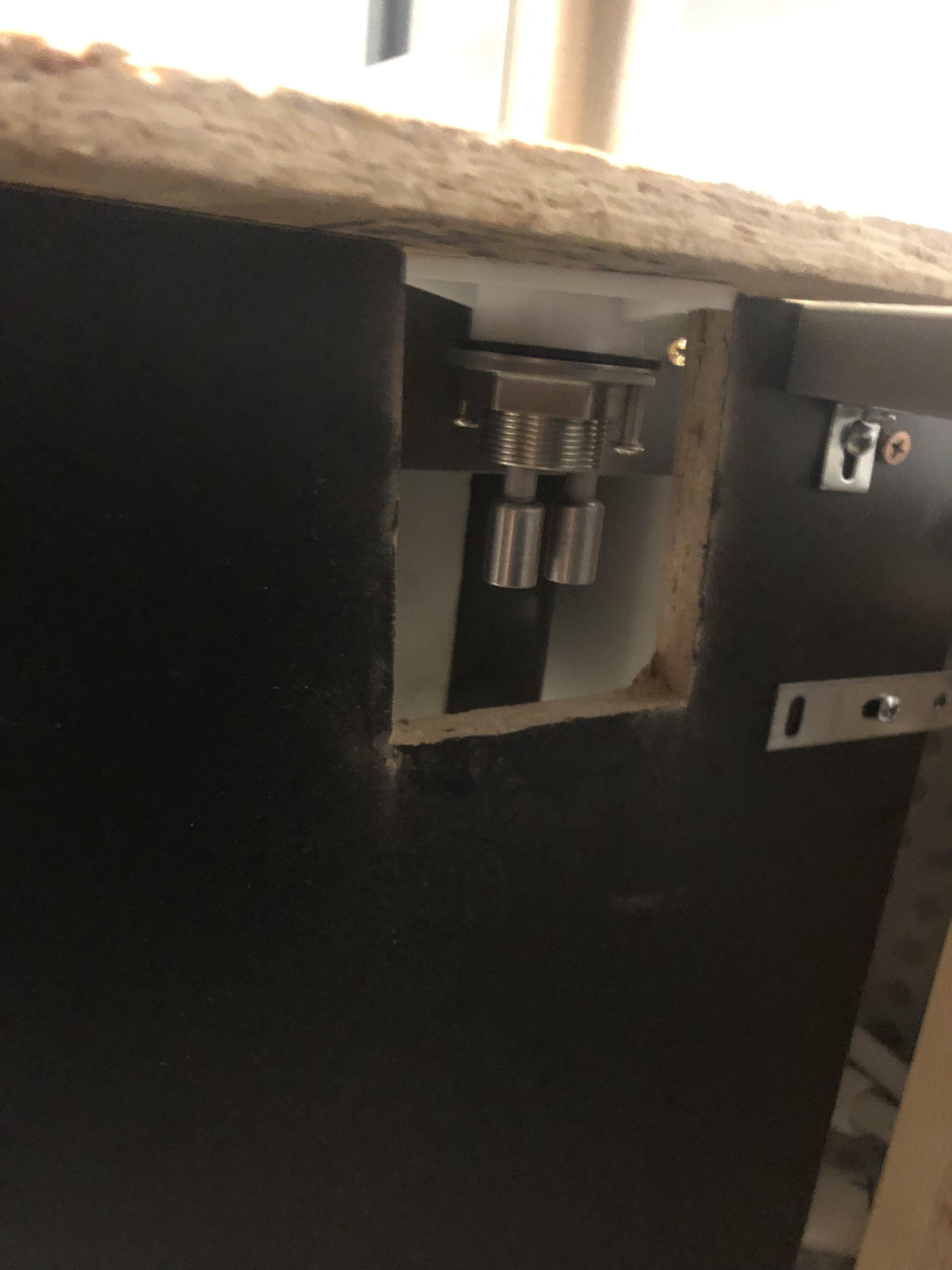

Pocster Posted November 27, 2023 Author Share Posted November 27, 2023 Can see tap access if it fails will be a dog . So did a mock-up . Cut out the unit to the right for access - washer goes here so no issue . 4 Link to comment Share on other sites More sharing options...
Jenki Posted November 27, 2023 Share Posted November 27, 2023 (edited) 1 hour ago, Pocster said: Can see tap access if it fails will be a dog . So did a mock-up . Cut out the unit to the right for access - washer goes here so no issue . @Pocster Good thinking. have you tried to install the tap with the OSB in place? I found with most worktop fitters (assume your having some solid worksurface) wont allow you to mess around installing the tap, they just fit the top and leave you to it after they have left. Edited November 27, 2023 by Jenki 1 Link to comment Share on other sites More sharing options...
ProDave Posted November 27, 2023 Share Posted November 27, 2023 30 minutes ago, Jenki said: I found with most worktop fitters (assume your having some solid worksurface) wont allow you to mess around installing the tap, they just fit the top and leave you to it after they have left. We had a granite worktop installed by Stone Source in Inverness. They gave me a few minutes to fit the tap into the worktop before they then bonded the undermount sink to it. 1 Link to comment Share on other sites More sharing options...
Pocster Posted November 27, 2023 Author Share Posted November 27, 2023 (edited) 52 minutes ago, Jenki said: @Pocster Good thinking. have you tried to install the tap with the OSB in place? I found with most worktop fitters (assume your having some solid worksurface) wont allow you to mess around installing the tap, they just fit the top and leave you to it after they have left. You mean plumb it in ? . Tomorrow’s task ! Edited November 27, 2023 by Pocster Link to comment Share on other sites More sharing options...
Jenki Posted November 27, 2023 Share Posted November 27, 2023 1 minute ago, Pocster said: I saw that, but did you fit the tap to the osb and then position it? or did you fit the OSB to unit then fit the tap? I've done installs where they would not let me fit the tap to the worktop, so its good to check you can fit the tap if the worktop is in place. (You may have done this, but thought it might be helpful to confirm) Link to comment Share on other sites More sharing options...
Pocster Posted November 27, 2023 Author Share Posted November 27, 2023 1 minute ago, Jenki said: I saw that, but did you fit the tap to the osb and then position it? or did you fit the OSB to unit then fit the tap? I've done installs where they would not let me fit the tap to the worktop, so its good to check you can fit the tap if the worktop is in place. (You may have done this, but thought it might be helpful to confirm) Ahhh I see ! I fitted the osb to the unit then fitted the tap - so that I know the hole and access is all good 👍 1 Link to comment Share on other sites More sharing options...
