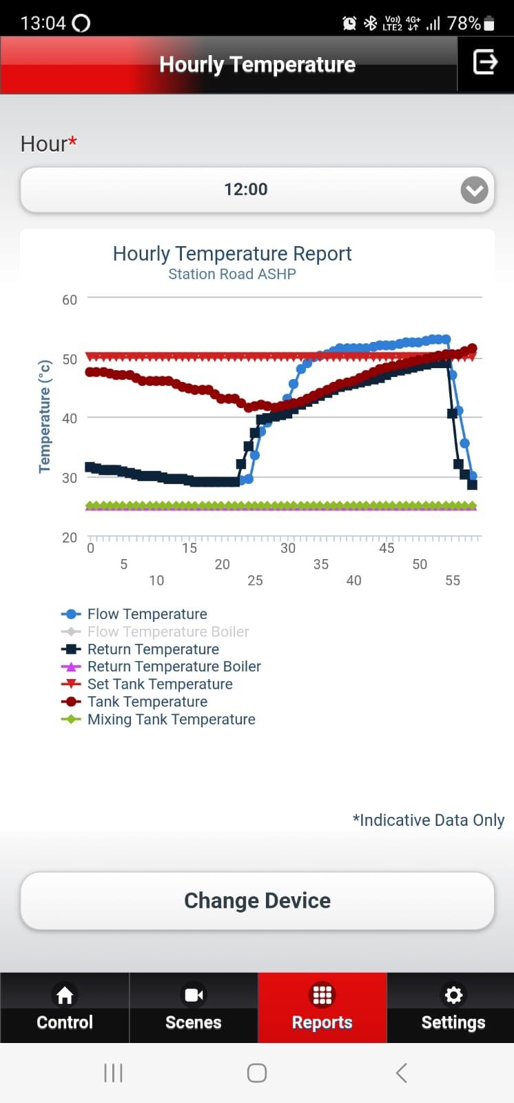

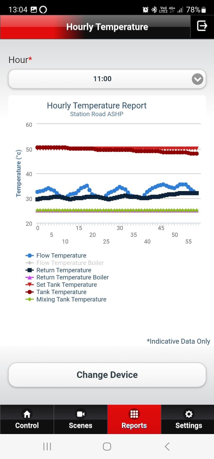

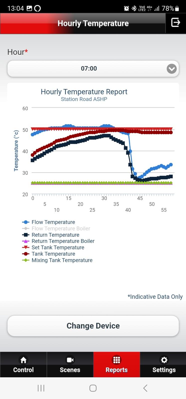

Ambaz79 Posted November 20, 2023 Share Posted November 20, 2023 Hello All I have an Ecodan 8.5kW Heat Pump with a 200L hot water Cylinder and a 100L Buffer Cylinder. I am using the HP in Weather compensation mode and when I check the hourly tempreture in Melcloud it shows the Flow is fluctiting allot. Settings for the Wether compensation are as follows. Low is 40 Degree Flow at -1 Degree outside High is 25 Degree Flow at 15 Degrees outside This morning the outside temp was around 8 Degrees so I would expect the flow to be around 30 to 32 Degrees however it looks like it runs at around this level and then keeps spiking to over 50 degrees. I am sure this means we are using allot of electricity. I only have the UFH downstairs and have Rads in the 3 bathrooms upstairs that are oversized. bedrooms dont generally need heating but we have AC in every bedroom that we use for heating if needed. Downstairs I have Thermostats in every room and they control only the manifold. Thermostats are set to a few degrees above the target tempreture. House is fairly air tight with triple glazed windows and 100mm PIR Insuration in walls all the way around. loft roof is also very well insulated. Is there something wrong with the settings or is there the weather compensation curve now correct? Link to comment Share on other sites More sharing options...
Gary68 Posted November 20, 2023 Share Posted November 20, 2023 (edited) The increases in temp to above 50C is your hot water reheating you can see the tank temperature increase in line with this. If you don't want it to do this you can adjust the time hot water is heated in the schedule, its probably set to be on permanently rather than on a schedule. Or you can increase the temperature drop before it reheats When it is heating it is running at 34ish in line with your Weather compensation curve, although at 11am it is cycling on and off every 7 mins which implies only one UFH zone is calling for heat and there isn't enough water for it to heat continuously so it has to turn off till the water cools down enough then restart. Edited November 20, 2023 by Gary68 Link to comment Share on other sites More sharing options...
Ambaz79 Posted November 20, 2023 Author Share Posted November 20, 2023 Hi Gary Totally makes sense now. I am surprised how fast it shows the tank tempreture drops. In the graphs it looks like every now and then there is a 5-7 degree drop in the water cylinder within the space of 20 minutes. Does this look normal. I would expect for a tank to drop but very slowly as its very well insulated. I will set a better schedual on the control panel and see how this makes a difference. Link to comment Share on other sites More sharing options...

Pip895 Posted November 20, 2023 Share Posted November 20, 2023 20 minutes ago, Ambaz79 said: I am surprised how fast it shows the tank tempreture drops. In the graphs it looks like every now and then there is a 5-7 degree drop in the water cylinder within the space of 20 minutes. Does this look normal. I would expect for a tank to drop but very slowly as its very well insulated. Isn't it just people using the hot water rather than the tank loosing heat? Link to comment Share on other sites More sharing options...

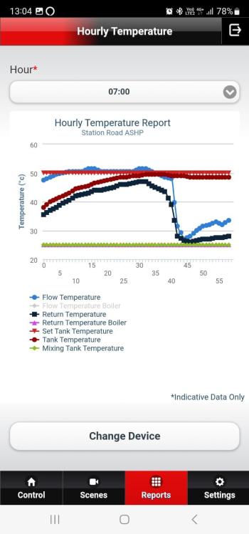

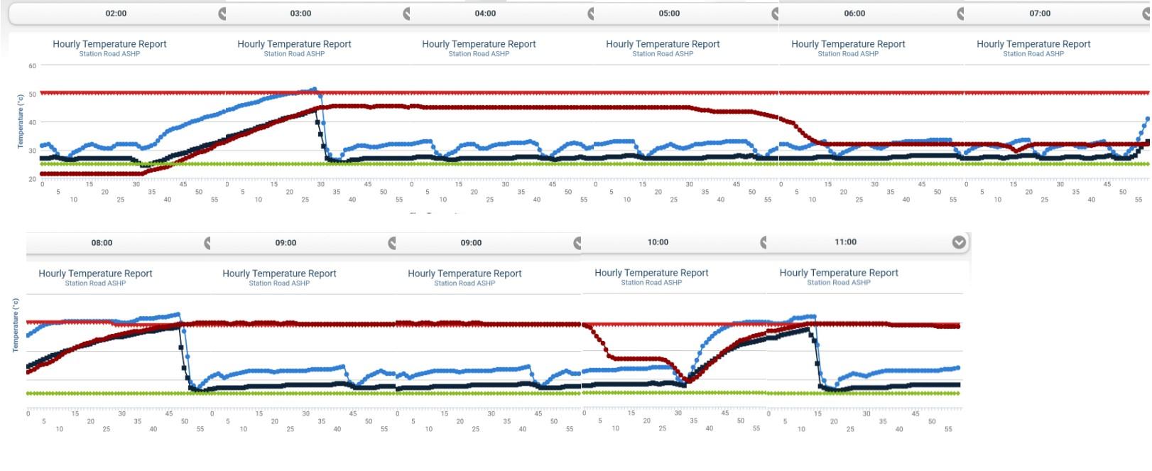

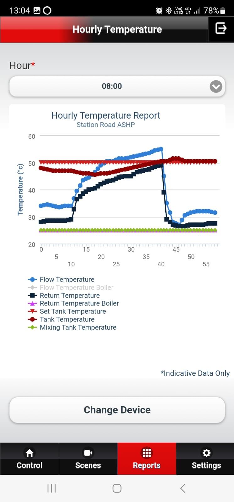

Ambaz79 Posted November 20, 2023 Author Share Posted November 20, 2023 on the screen shots attached we leave home at 8am so after this point no one should be using any hot water. Link to comment Share on other sites More sharing options...
Beelbeebub Posted November 20, 2023 Share Posted November 20, 2023 Your tank temp is taken at a single point which is also the control point. As the tank heats up from top to bottom there is a fairly small vertical zone where the temp goes from target temp to cold. This zone moves down as the tank heats up until it crosses the control point which goes from being in cold water to hot water quickly. Then the heat source shuts off. At this point the temp sensor is only just in the hot zone and just below it is the cold water. So the sensor cools quickly even though the tank as a whole hasn't lost much heat. Link to comment Share on other sites More sharing options...
Dave C Posted November 21, 2023 Share Posted November 21, 2023 (edited) All true, but if nobody's home after 8am, and no hot water being used, you wouldn't expect the tank temperature to drop any significant amount between 12:00 and 12:30. Particularly if everybody left at 8am and the tank was heated back up to full temperature just before 9am. Are you sure you don't have a leaking tap or similar anywhere? Only time my ASHP came on unexpectedly in the middle of the day last year it was because my daughter had left a hot water tap not quite fully turned off and there was a tiny trickle running out constantly - as explained above, it doesn't have to be much water drawn off before the sensor starts to see a drop. It would be consistent with the graphs - from 11:00 there's a slow but steady drop in tank temperature as the water trickles out, then the 'hot zone' in the tank is approaching the sensor so the temperature loss appears to speed up as the water continues to be used; then the heat pump kicks in to reheat the tank. Edited November 21, 2023 by Dave C Link to comment Share on other sites More sharing options...

eniacs Posted November 21, 2023 Share Posted November 21, 2023 16 hours ago, Ambaz79 said: I am surprised how fast it shows the tank tempreture drops. In the graphs it looks like every now and then there is a 5-7 degree drop in the water cylinder within the space of 20 minutes. Does this look normal. I would expect for a tank to drop but very slowly as its very well insulated. I have the same heat pump. I see this sort of loss when it starts to do a tank heating cycle. The 28mm pipework holds a lot of water that has after some time dropped to a low temperature. When a tank heating cycle is called for, the first thing that happens is the tank temp drops a lot as this cold water circulates through the tank, stealing its heat. Is it this? It looks like a few minutes later the flow temps jump and the tank is reheating. 1 Link to comment Share on other sites More sharing options...

JohnMo Posted November 21, 2023 Share Posted November 21, 2023 18 minutes ago, eniacs said: I have the same heat pump. I see this sort of loss when it starts to do a tank heating cycle. The 28mm pipework holds a lot of water that has after some time dropped to a low temperature. When a tank heating cycle is called for, the first thing that happens is the tank temp drops a lot as this cold water circulates through the tank, stealing its heat. Is it this? It looks like a few minutes later the flow temps jump and the tank is reheating. You also need to look at the route the pipes take, especially the hot one from the top of cylinder, this pipe can takeaway heat quite quickly, especially if not really well insulated or goes up from the cylinder. Ideally this pipe drops around 150mm minimum from the top of the cylinder as soon as possible, before going horizontal. This stops any thermosyphon effect. Link to comment Share on other sites More sharing options...

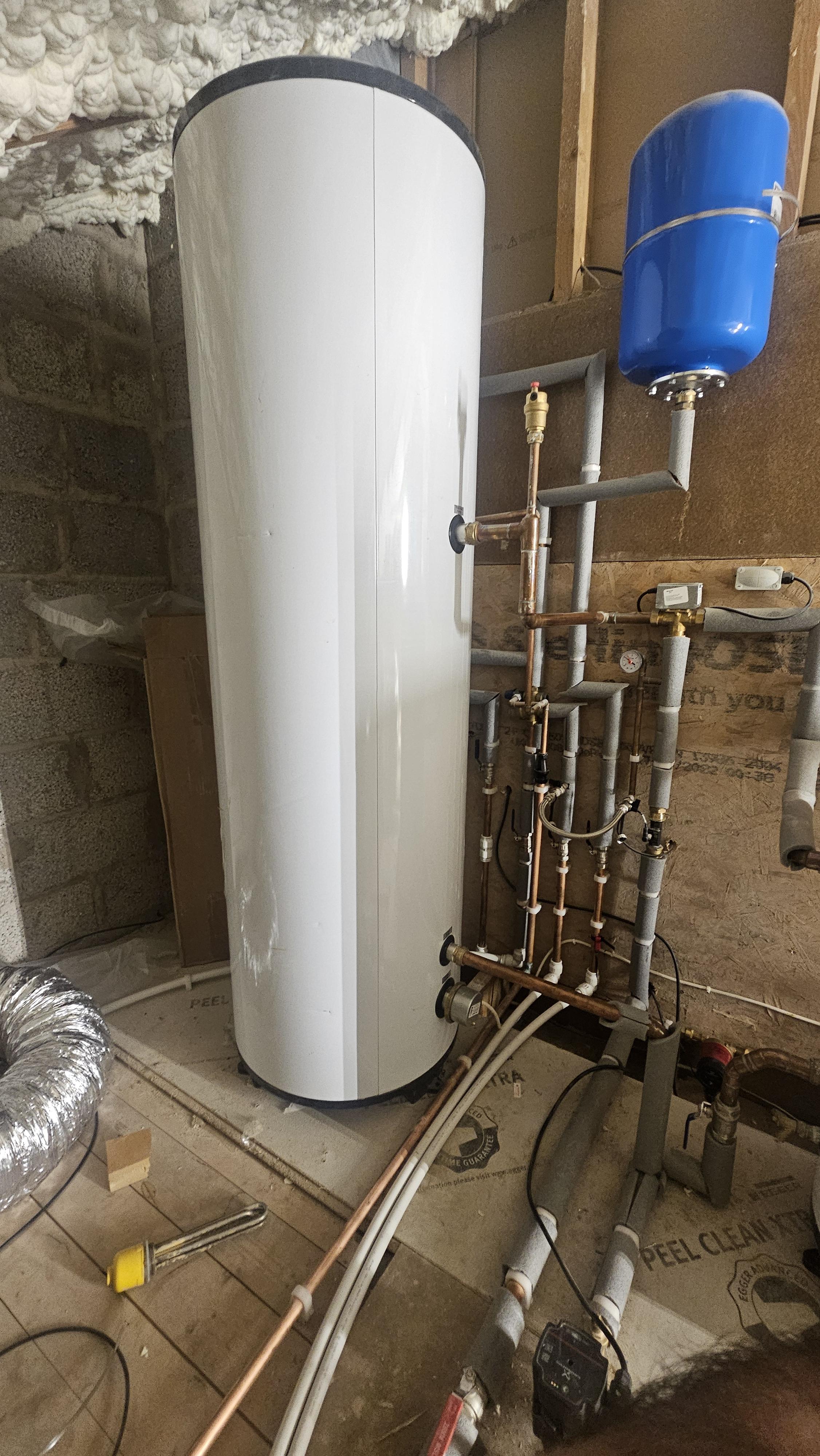

Ambaz79 Posted November 21, 2023 Author Share Posted November 21, 2023 Sorry made a mistake on my Tank Size. It’s actually a 320L Unvented Cylinder with a 25 Meter Coil pipe inside. It’s also got a 3kW Emersion heater that’s on a 2 week cycle for Legionnaire. What I did last night is put the water on Cycle to heat at 2.30am to 3.30am and the setting was on Eco. Apparently it means it heaters the DHW with a lower temperature making it more efficient but taking longer to heat. 6am my wife went for a shower and after this the temperature just goes down and stays down. I went for a shower at 8 and it was luke warm water. Maybe 20-30 degrees. So at 8.45am I turned off the timer function for the DHW and went back to it being heated as the tank required with the setting to heat after a 20 Degree drop in tank temperature. DHW is now set 49 degrees. Only other bit of info is I have a hot water circulating pump. Its set to monitor the temp in the How water supply pipe and circulate it if the water get cooler. I don’t know if this is making any difference. Grundfos UP 15-14BXA PM GB Brass Comfort Hot Water Circulating Pump. I still don’t understand even though the water heated to around 40 degrees and the shower was only used once for around 5-7 minutes why the tank had no hot water at 8am? Does not make sense to me. For my heating I have now reduced the flow in the manifold to the rooms and increased the weather compensation curve slightly to increase water temperature for heating. I read somewhere that if the flow is too fast and water in and water our is similar temperature then it would stop the HP. Yesterday I was seeing the HP cycling around 4 times per hour. Today I see its Cycling around twice an hour. The ideal scenario would be that we stop this cycling. Heat Pump is around 7-8M awy from where the Cylinders are and the pipes to and from the HP are insulated. Other pipes connected to the Cylinder are not. I will try and take a picture later on tonight. Link to comment Share on other sites More sharing options...

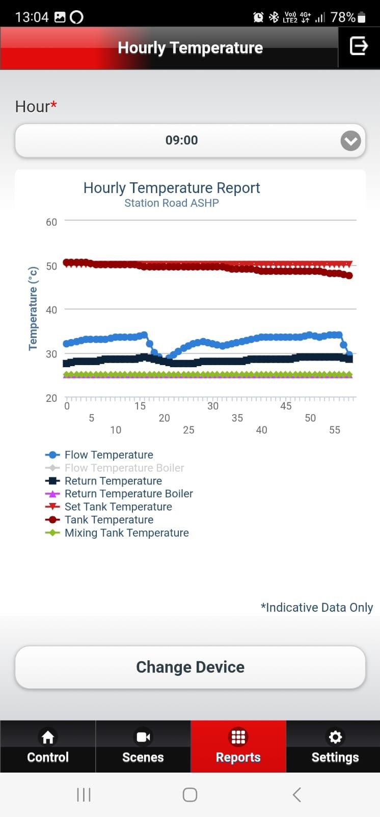

Ambaz79 Posted November 22, 2023 Author Share Posted November 22, 2023 Looks like there is some other problem. Circulating Pump been off all day. Left at 8am with water temp at 49 degrees. Target temp was set to 48 degrees. My son went for a 10 minutes shower at 4.30pm and then we have used it for washing up after dinner at 8pm 5 minutes into washing up the water went cold meaning no hot water in cylinder. I would expect a 320L tank to do allot more then this on a single charge. I've had to change the ashp dhw to come on on a 10 degree temp drop and left it to be constantly on. Could it be the Cylinder is not fully filled up. I thought it could be loosing water somehow but then thought we didn't use the water all day and water has remained hot. But lost with this now. Link to comment Share on other sites More sharing options...

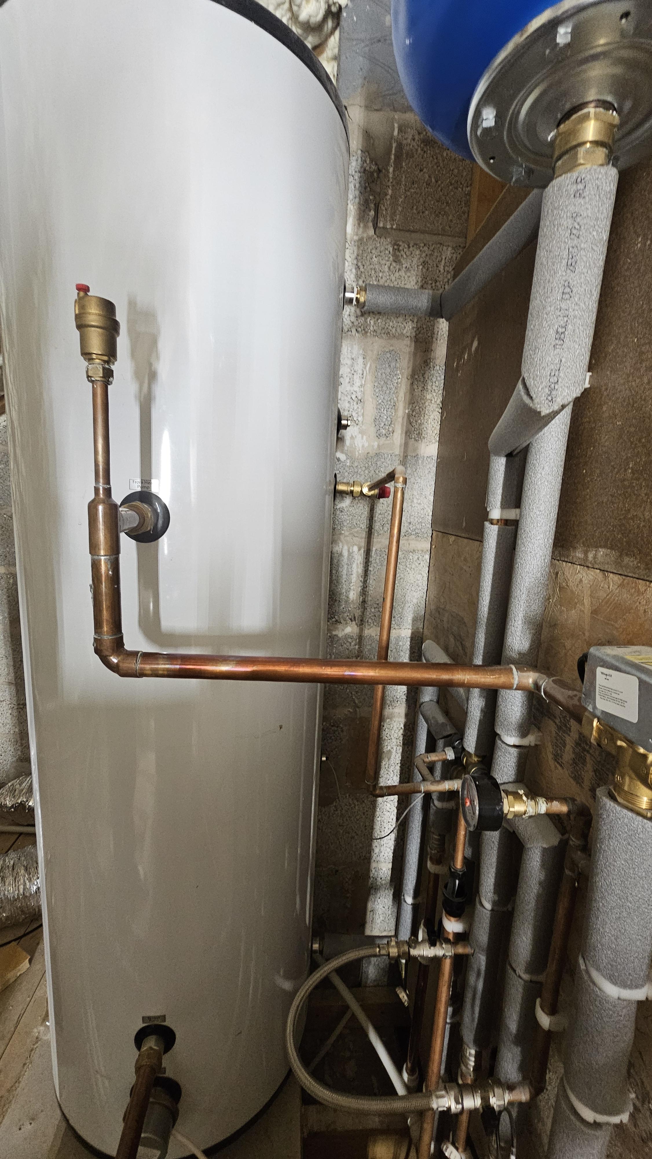

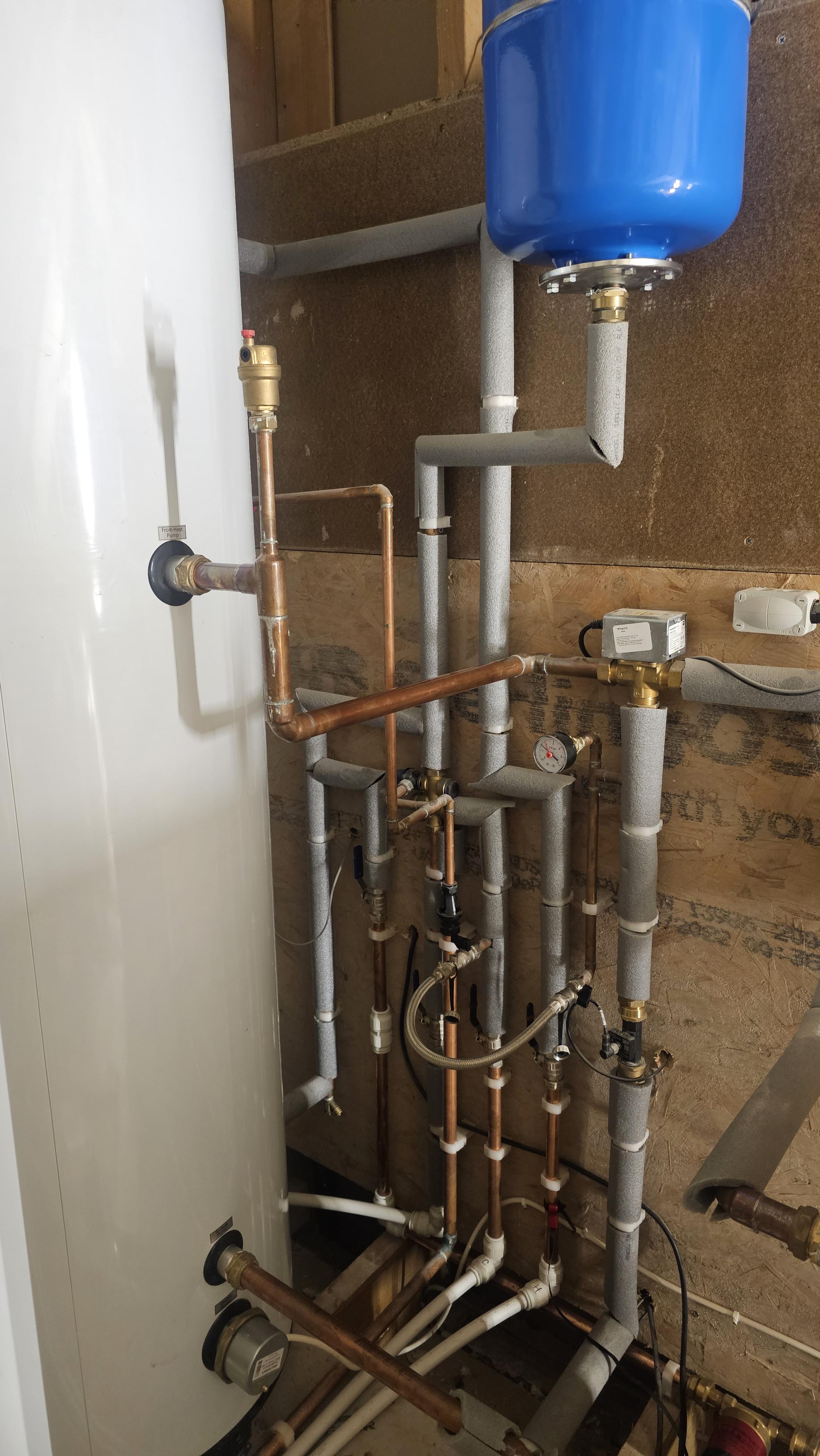

Beelbeebub Posted November 22, 2023 Share Posted November 22, 2023 Are there any thermostat or sensor pockets on the tank? Link to comment Share on other sites More sharing options...
Ambaz79 Posted November 22, 2023 Author Share Posted November 22, 2023 Yes there is that is lower down the tank. You might just be able to see a small wire going into the tank. Link to comment Share on other sites More sharing options...
