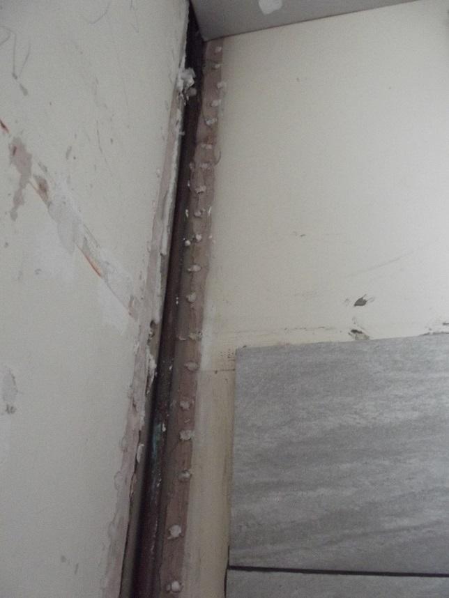

I’m at my wits end with my self build house , moved in 10 months ago and it’s been a nightmare.
Our dream home has become a money pit even after completing and moving in. The droughts in every room are costing me on my energy bills. I’ve now realised what the issue is. The house a concrete block build with insulation in the cavity. The plasterboaring was dot and dab and the tell tale sign was drafts coming in behind sockets thinking this was a simple fix we used putty for sockets in all the sockets this made some improvement but not significant.
I’ve read about drilling holes in the plasterboard and filling with foam 100mm apart this is a big job. As it’s 4000sqft house. But I need to do something can’t continue like this.
ive purchased a flir camera to target the worst areas. Any one got any susgestions or experience in this area.

Your cheapest most effective solution would be to run a line of silicone around the bottom of the skirting where it meets the floor
The silicone at skirting level will stop draughts from the plasterboard/block (mini-)'cavity' coming into, and cooling, the room, but it will not stop air-movement behind the boards cooling the board surface, unless full perimeter beads (and preferably cross-hatches) have been used.
Where I *know* that boards have been on 'pure dabs' I have injected air-tight foam at approx 50mm centres. N.B, OP, this is *not* to try to get full foam fill behind the boards, it is to close off the perimeters.
