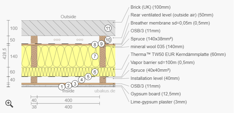

@Iceverge I didn't initially realise that your pdf sample build-up was from an interactive tool and free to use.
It's a great bit of software, I don't have German to understand some of the descriptions but thankfully numbers and values are same in both languages!
I've played around with the buildup and came up with design that in separate components makes sense to me and I would be very comfortable delivering onsite but I'm not certain it works all together though.
  • The 140mm mineral wool within the studwork makes up the bulk of the insulation, and, vs. PIR,  ticks the box for breathable and acoustic performance.
  • Overboarding studwork is 60mm PIR in large format boards tends itself well to be the insulation choice to be fixed uninterrupted over the studwork, and it also deals with cold bridging spots. (Perhaps this will be reduce to 50mm or 40mm thickness)
  • This PIR layer could be tape and may be sufficient to provide a VCL but for the minor additional cost I've chosen to spec a sheet VCL
  • 40mm service cavity internal to the wall construction proper (will likely be formed with 45mm battens)
  • 11mm OSB behind the plasterboard to give a frimer wall finish, especially as I have the studwork @600mm c/c
@Iceverge You assigned "Rear ventilated level (outside air)" to the cavity in your model; I have simply copied you in this.
How did you know to assign that particular selection to the cavity, its illustrates battens in the model which I don't believe should be there in reality.

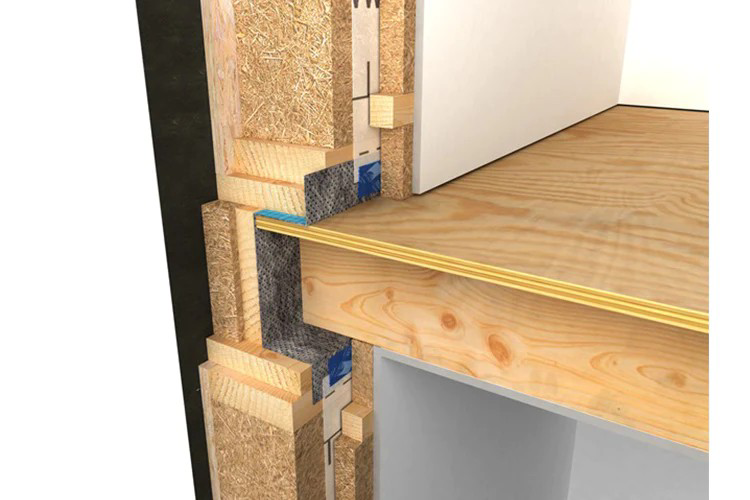

Looks good. @Thorfun among others have the same buildup. It's quite common. I think MBC offer it as a factory spec.
The OSB behind the plaster is a cheap enough addition for a much more robust wall.
You could drop your service cavity to 20mm using 20*70mm strapping. 20*45mm battens tend to be a bit weedy and split.
If you do this you can spec outwards opening windows and wrap the jambs etc and overlap the frames from the inside.
One point of care with the airtightness will be the band joist area that will require a membrane wrapped around the end of the joists for the first floor connection. Likewise any buttressing internal wall. Nothing that can't be overcome however.
Note the insulation outside the band joist too as this will be a weak spot otherwise.

Thanks again for the feedback.
Yes reducing the depth of the service cavity is certainly a strong possibility as the TF will comprise of an office and a bedroom, as such there will be fewer services to accommodate vs say a kitchen or bathrooms.
Noted also regarding continuity of membrane at joist level.
Although the set back of the band joist (aside, I would term rim joist) is not an arrangement I've seen previously.
I guess the sheathing continues over the insulation at that point to ensure both the GF and 1st floor TF panels are tied together. I think lining the respective studs through and strapping with 1000mm galvanised straps would be required also.
Yes, Certainly take structural precautions here as you'll loose a lot of strength. You could just insulate between the joists well as normal too. It wouldn't make much difference thermally.

This is very similar to what we have chosen, we are using a breathable racking board, we have opted for a 70mm internal insulation board, and in place of the VCL, we are taping the joints. Another detail we have is to return a 25mm insulation board on window jambs to kill the cold bridge from window to frame. We have a calculated wall uvalue of 0.13.
Our frame is 400c so hoping that will help with wall firmess, but may still look to use OSB behind kitchen, and otherwise use 15mm or 2 x 12.5mm for utility/plant room.
