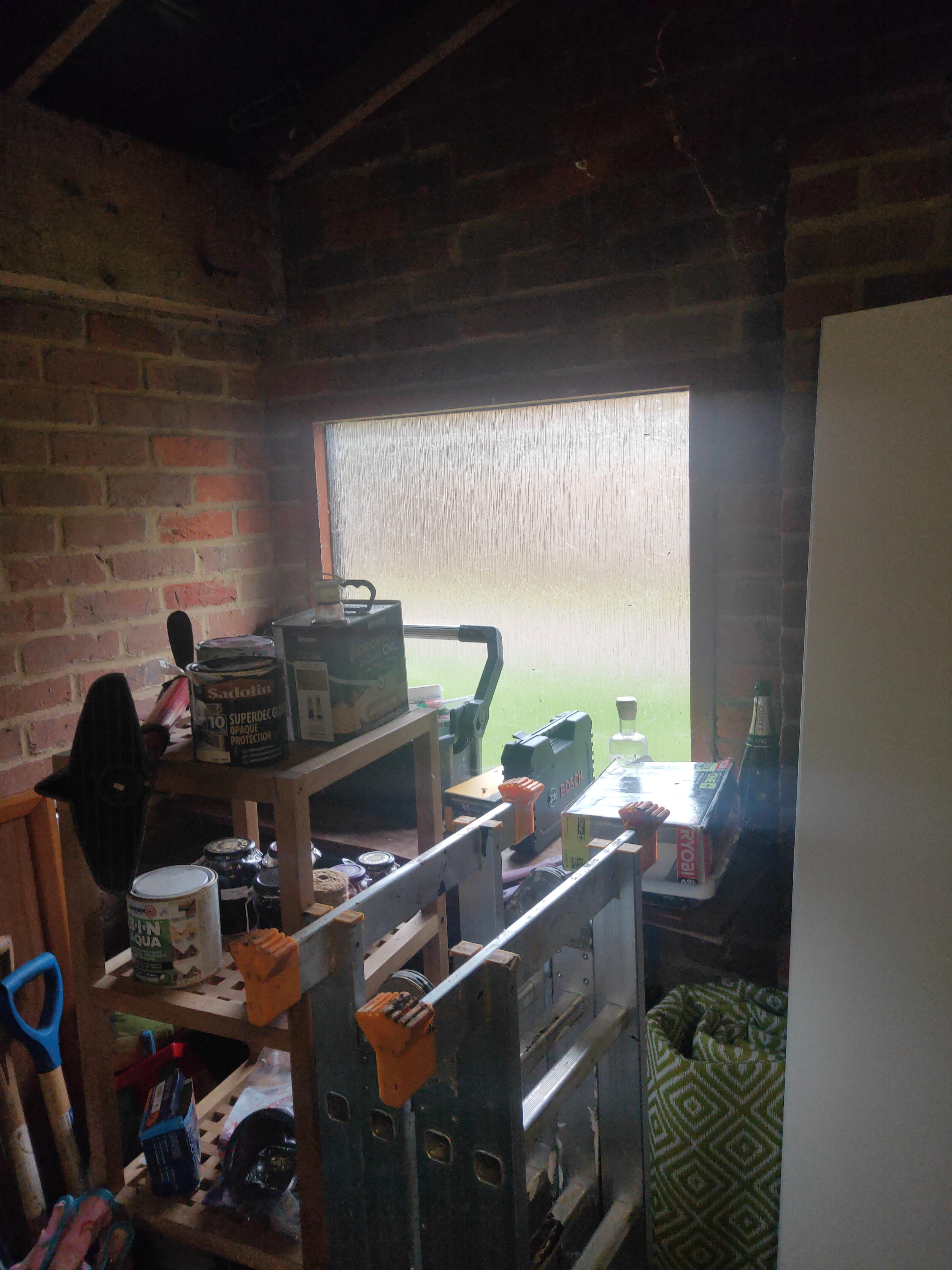

Archer Posted November 16, 2023 Posted November 16, 2023 I think I know the answer to this one before starting... but... One option for us to address a noise issue with our heat pump location (planning app) seems to be to locate the outdoor compressor unit in the garage. The proposal from our engineer is for the fan to be in the corner 30cm from a large 1m x 1m louvred opening and a separate side vent discharging the exhaust air from the side of the air to outside. See photo of location below... So everything I've read online seems to say this is a bad idea but the engineer says quite reasonably that they have fitted this before in undercrofts or ventilated enclosures without any issues. What are the thoughts... If there is a performance drop is this likely to be major or minor? Does the main fan suck new air from the front and discharge cold air from the back (or is it from the side only?

Beelbeebub Posted November 16, 2023 Posted November 16, 2023 I reckon it *might* work with some big caveats... First, you need to makes sure there is no recirculation of air from the inlet to the exhaust. The inlet for heatpumps is the back and one side (usually the left as you look at them). That is where air is sucked in over the heat exchanger coil. The exhaust is the circular (sometimes square) opening at the front. You need to make sure no air ejected out if the exhaust can find it's way back into the inlet. You then also need to make sure there is adequate air flow throught the machine. So *if* you were able to mount the HP so the exhaust blew straight out of the building or the inlet drew from outside, you might have a chance. Imagine mounting the HP against a partition wall with a hole cut in it. To prevent flow issues, the openings into and out of your building would need to be *at least* as large as you HP, againimagine being able to push your HP easily through the hole. 1

Archer Posted November 16, 2023 Author Posted November 16, 2023 6 hours ago, Beelbeebub said: I reckon it *might* work with some big caveats... First, you need to makes sure there is no recirculation of air from the inlet to the exhaust. The inlet for heatpumps is the back and one side (usually the left as you look at them). That is where air is sucked in over the heat exchanger coil. The exhaust is the circular (sometimes square) opening at the front. You need to make sure no air ejected out if the exhaust can find it's way back into the inlet. You then also need to make sure there is adequate air flow throught the machine. So *if* you were able to mount the HP so the exhaust blew straight out of the building or the inlet drew from outside, you might have a chance. Imagine mounting the HP against a partition wall with a hole cut in it. To prevent flow issues, the openings into and out of your building would need to be *at least* as large as you HP, againimagine being able to push your HP easily through the hole. This is along the lines we were thinking... It's hard to illustrate without drawings but in that photo above - the window would be taken out and a timber louvre put in instead (approx 1m x 1.2m) that would line up directly with the side intake... The exhaust would face another similar size timber louvre and we'd box the edge of the unit to stop the air mixing. It sort of feels like it should work on paper, but I still don't know if it's a good idea, I guess it would mean a gale howling through the garage and not sure whether the provider would warranty the installation of there was a problem. Fitting it outside on the garage wall is also an option but we're in a conservation area so the appearance comes into play
RichardL Posted November 16, 2023 Posted November 16, 2023 10 minutes ago, Archer said: The exhaust would face another similar size.... Air pressure is a thing - Rather than the cold exhaust fan facing the other opening - can you position the machine so the exhaust is near it - in it almost? i.e. so the path of least resistance (ideally the only path) for the air is out of the building? (Path of least resistance may well not be a straight line) I would guess (check with an expert) the exhaust fan is not expecting to generate any pressure - so ducting is probably? not an option. If that cold air finds a way back to the radiators easier than the relatively warm air from outside you'll have a problem.
Archer Posted November 16, 2023 Author Posted November 16, 2023 4 minutes ago, RichardL said: can you position the machine so the exhaust is near it - in it almost? i.e. so the path of least resistance (ideally the only path) for the air is out of the building? That was the plan essentially, the unit would be 300mm or less from the louvre (the exhaust) and the engineer would calculate the free flow. It does seem like in theory it could work, it's just that everything you read online and in the technical literature says keep them outside with free flow air. But if you look at the ISO accredited acoustic enclosures, they basically do the same as our engineer is suggesting - ie. A small, ventilated box. I don't know if I have the courage to push the trigger on it though 1
Beelbeebub Posted November 16, 2023 Posted November 16, 2023 Preventing recirculation is the key, and the only way to really be sure would be to butt the unit against some sort of enclosure so it sealed (some sort of flexible rubber of foam seal against the face) the two air flows. My worry is that this would also channel the noise out, possibly even acting as megaphone and making it worse!

saveasteading Posted November 17, 2023 Posted November 17, 2023 The expulsion side of it is a rather undirected blast of cold air, so really needs to be to completely free space. In your case this would be immediately inside the wall at the big opening. But that's almost outside as regards noise. The inlet side will find air to replace it if you have loads of openings, or a very big but leaky garage. There isn't much point in an underperforming heat pump. Why can't you build a louvred fence around it to absorb the sound? Or a hedge? Lastly, do you know how noisy it will be and if it is really an issue?
