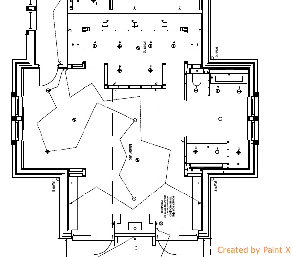

Stones Posted September 9, 2017 Share Posted September 9, 2017 As you say, better doing it now than later. Does the plan show the old or new layout? Link to comment Share on other sites More sharing options...
ProDave Posted September 9, 2017 Share Posted September 9, 2017 I must admit I am seeing a room that has so many angles and bits jutting out, I don't know where I would put the bed. Is a solution to the overbearing wall to not take it all the way to the vaulted ceiling, instead finish it at a normal 2.4 metres and create a flat mezanine space above the en-suite? Link to comment Share on other sites More sharing options...

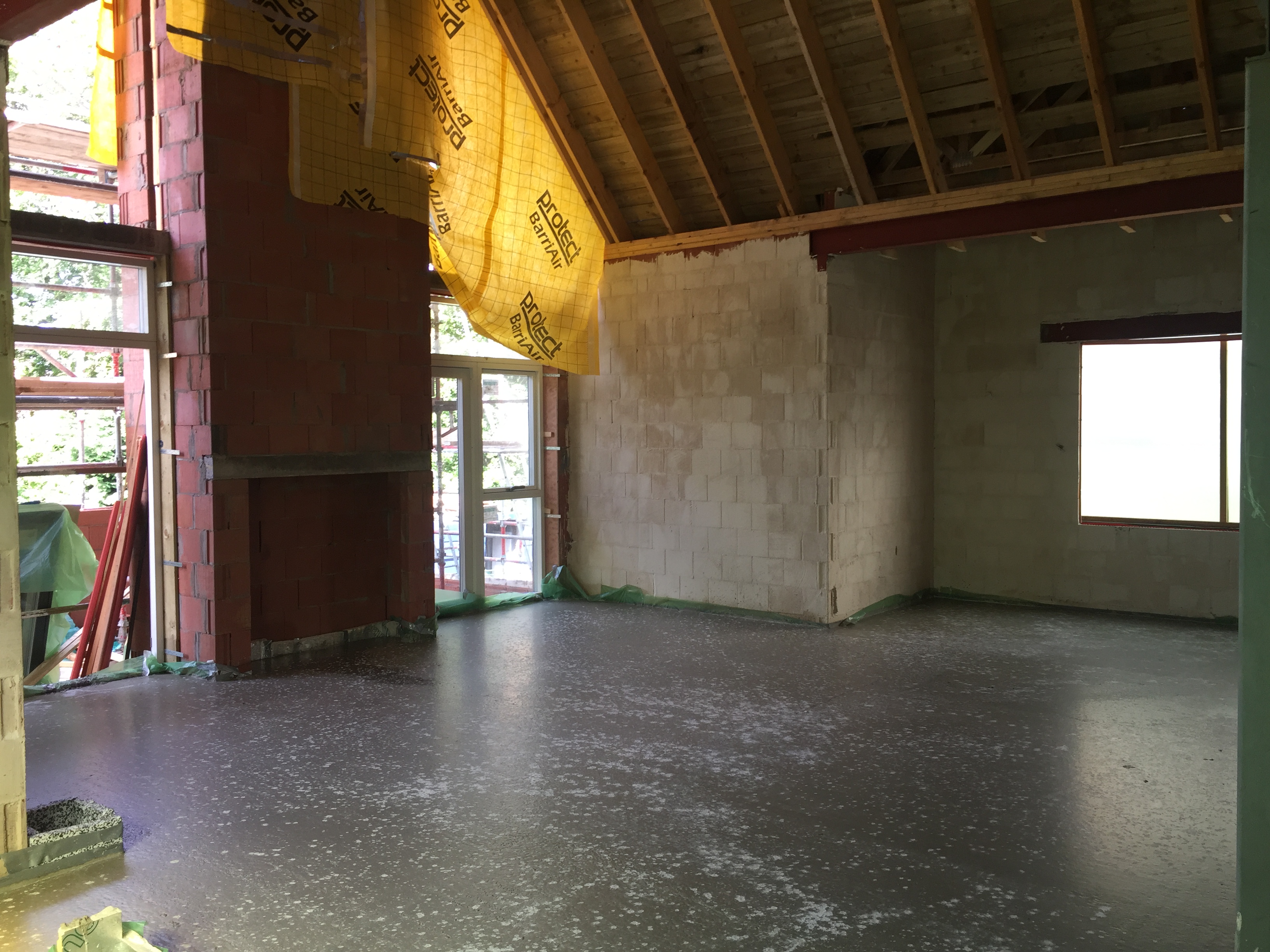

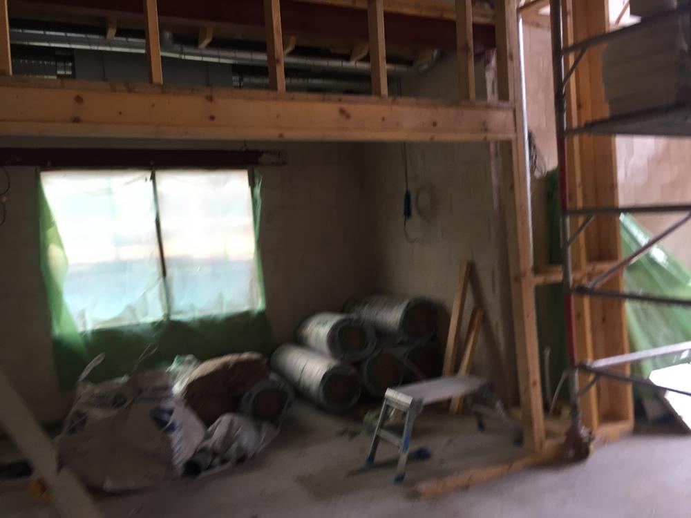

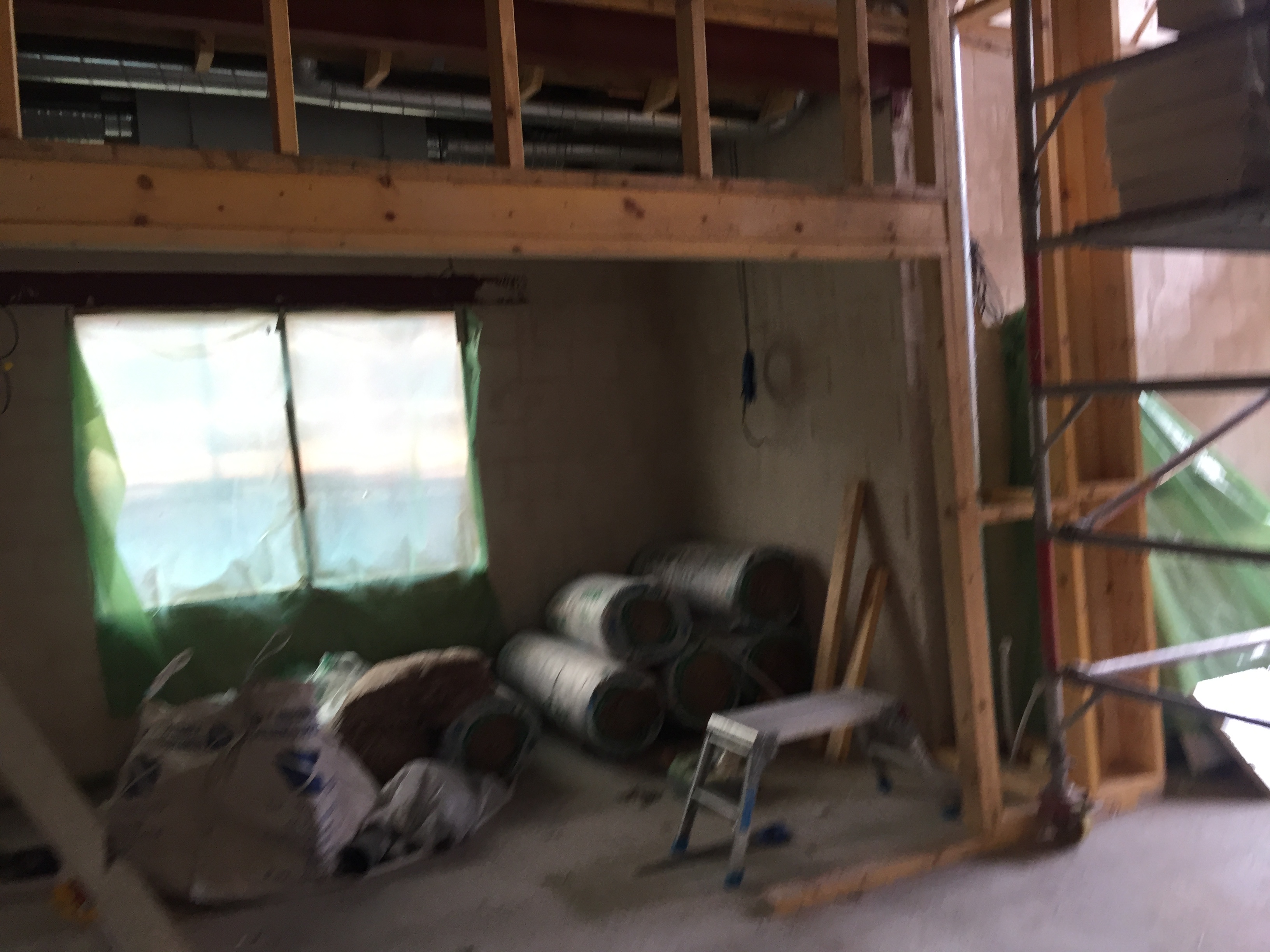

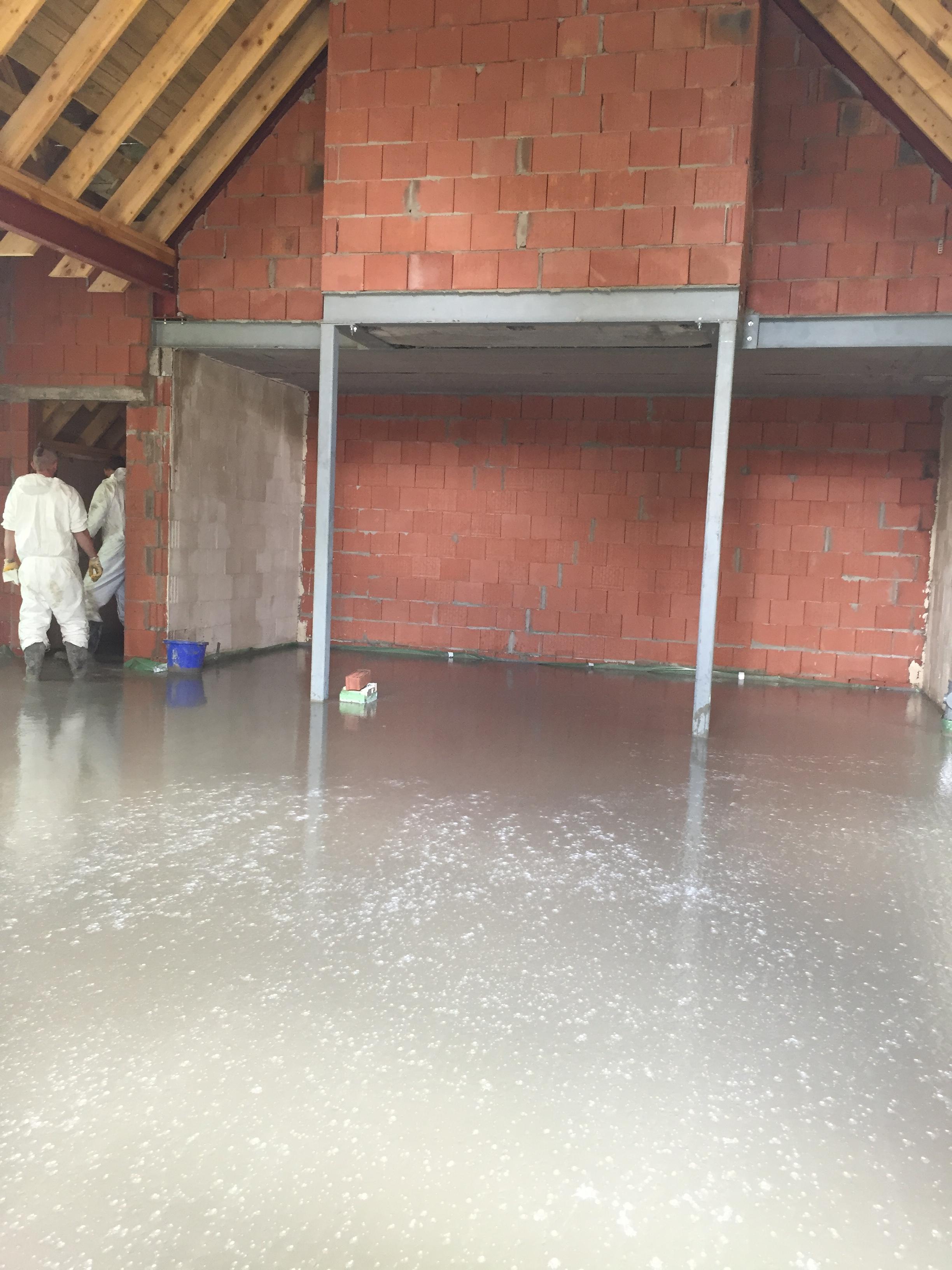

AliG Posted September 9, 2017 Author Share Posted September 9, 2017 (edited) That's the old layout. The bed goes centred facing the fireplace. It's about 1.2m from there to the ensuite wall. The room is full height across the centre then 2.75m tall when it hits a steel beam that holds up the roof at each side, from there on it is flat. So inside the ensuite would have been 2.7m, but the outside wall is roughly 3.5m high. I found a pic before the plasterboard went up on the stud work and some other pics of the room. The bed goes in front of the steels. At the right hand side of the pic of the steels, the en suite wall comes out 800mm and leaves a tight corner entry to the dressing room. We are going to take the wall back to be in line with the outside wall so it is 1.8m from the bed. The dressing room only has 2.4m ceiling height as there is a mezzanine floor above it. Next question will be should the dressing room be closed off or open to the bedroom so that the you can see the whole width of the room and should we put a window in the new en suite. I'll need to buy some tiles for the larger new en suite. One thing I can do is put the WC in its own little cupboard now like you get in nice hotels. I did suggest having a his and hers en suite but my wife said no. Edited September 9, 2017 by AliG Link to comment Share on other sites More sharing options...

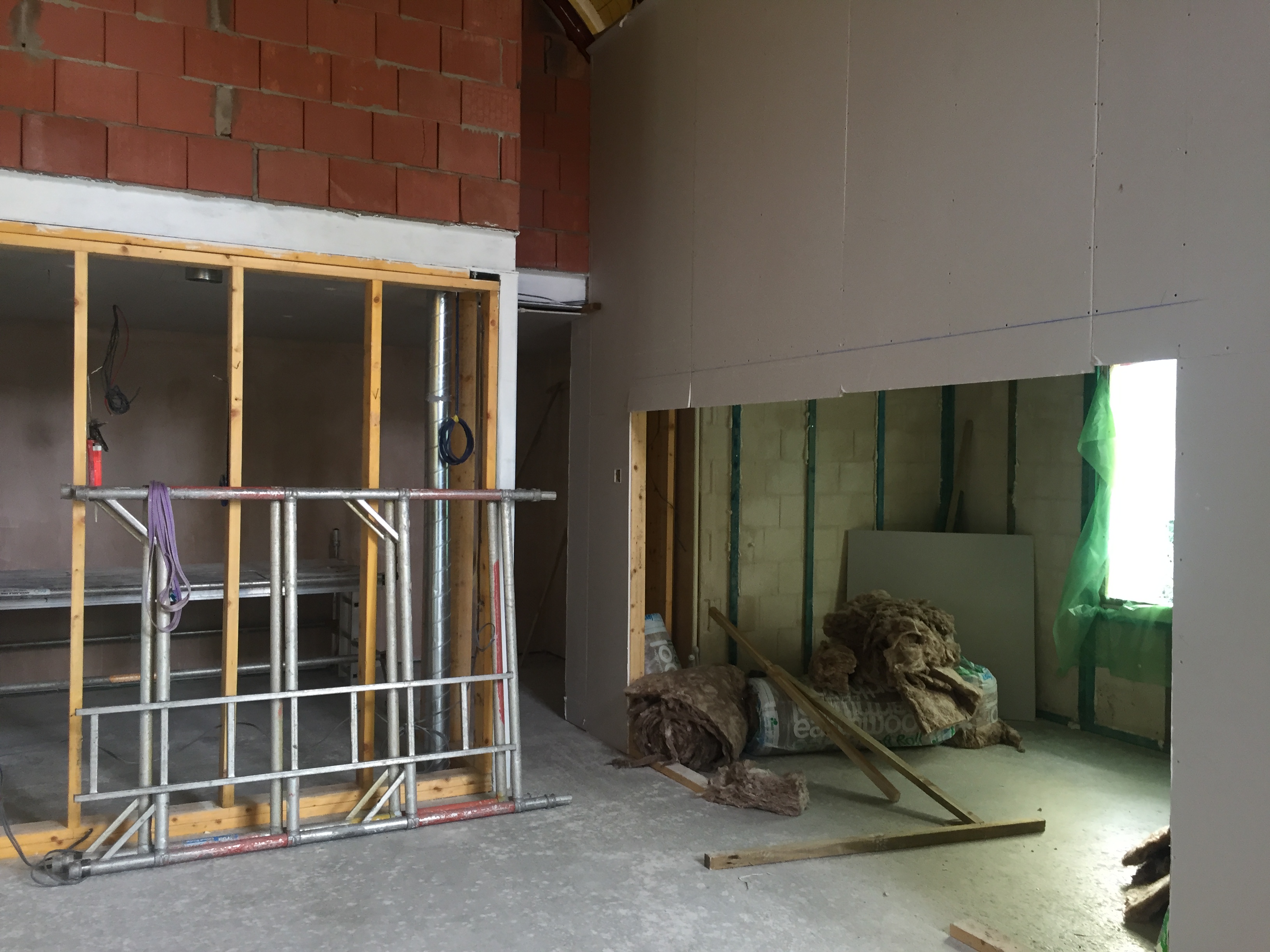

AliG Posted September 10, 2017 Author Share Posted September 10, 2017 Thanks for the suggestions, actually one of the change I had made was to make the dressing room pocket doors already. I went up and stood in the space today. I am very happy with the decision to swap the dressing and en suite around. Although it seems like the dressing room should be closed off as this allows you to hide stuff away, having stood in the space, I feel that opening up the dressing room and having maybe a big open arch into the room keeps the symmetry of the room that the wall currently has destroyed. I took a picture where you can see the tight corner that we want to lose and compare it to the other side of the room. I think keeping it open the room will be he same width in both directions and benefit from that. Link to comment Share on other sites More sharing options...
