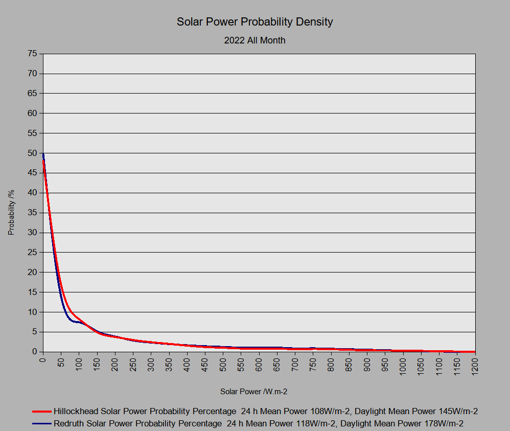

The data covers the whole of 2022.  The solar gauges on these weather stations are generally horizontally mounted, so do not produce the same readings that say a south facing solar module would.  To do that, so jiggery pokery with geometry has to be done.
What is interesting to me, is that even though Inverness is in the far north, and Redruth is in the far south, how similar the solar distributions are, the mean power per square metre readings are different.  Over the year, Hillockhead has a daylight men of 145 W.m-2, Redruth 178 W.m-2.
Here is a chart showing the full year.

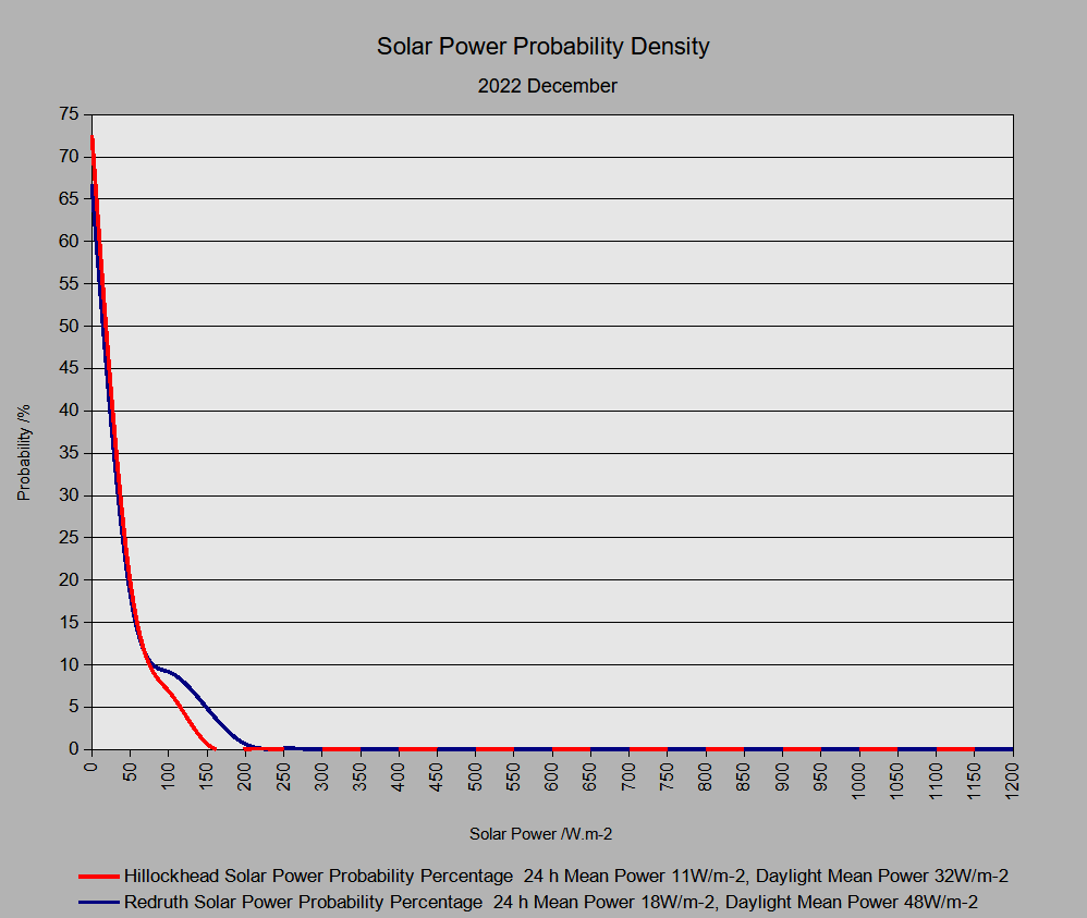

December, while different, shows the same similar pattern.

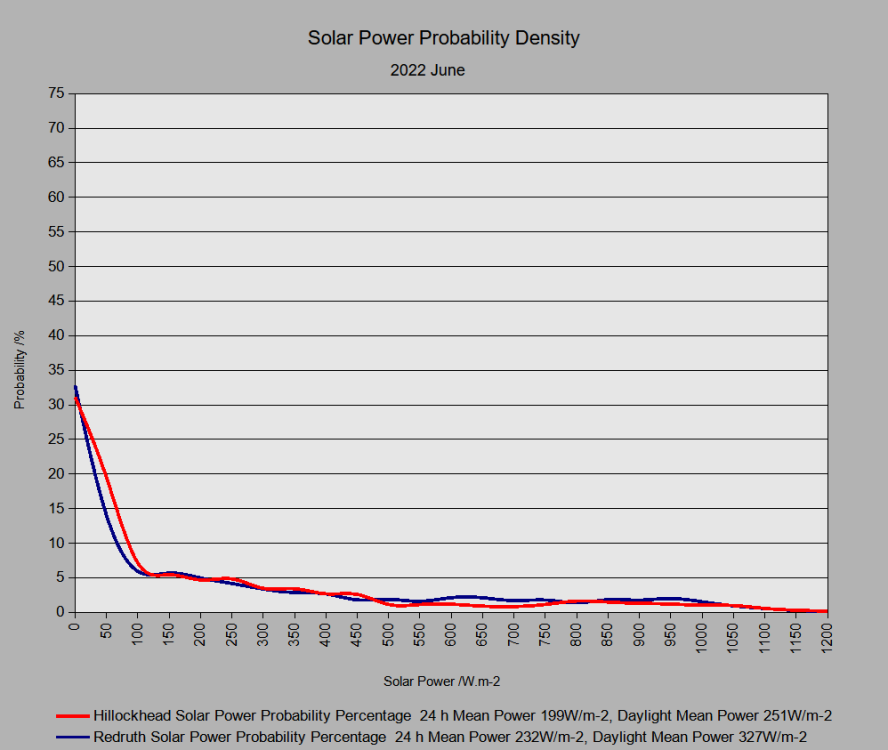

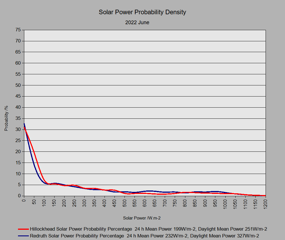

As does June
The hours of daylight are, to my surprise, very similar, just a bit time shifted (about an hour).
I am surprised just how similar the data traces are considering the geographic locations, about 7.6° of latitude.
