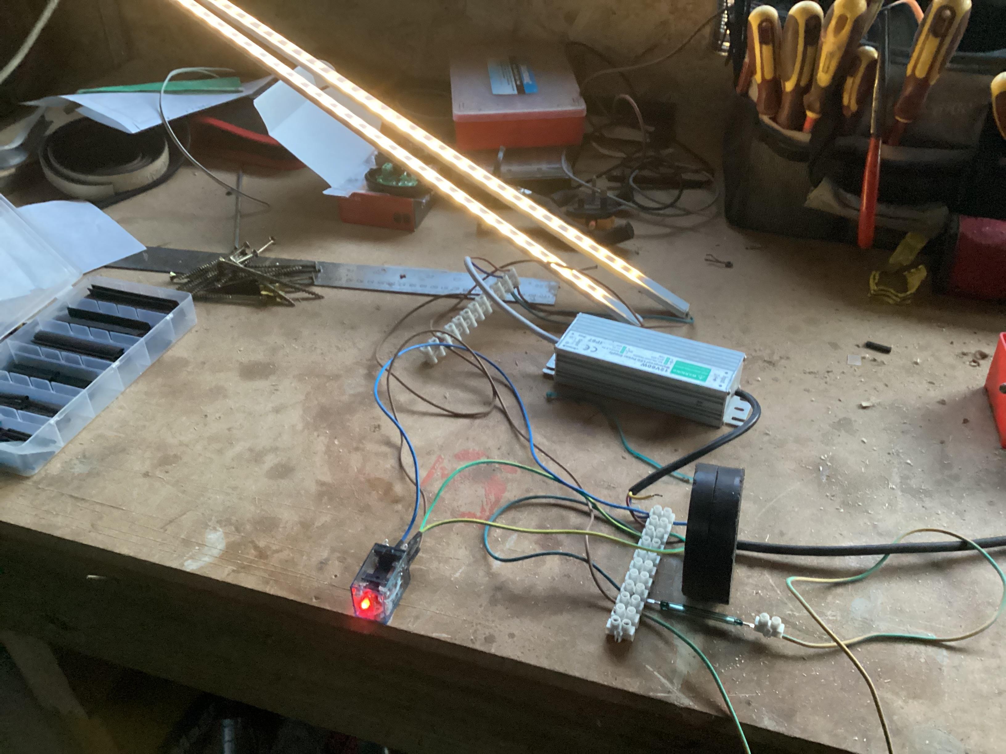

joe90 Posted November 23, 2023 Author Posted November 23, 2023 (edited) Thanks guys, so, 200k ohm 1/4watt resistor in parallel with the LED driver and i guess I keep the capacitor/resistor I tried as spark quench.? ( I better understand electrical mechanicals, relays etc than electronics 🤯) right ordered resistors but if this does not work I will use a relay (type, spec, source appreciated). Edited November 23, 2023 by joe90

Onoff Posted November 23, 2023 Posted November 23, 2023 So you just want a relay, with a 230V coil, that'll switch 230V at some amps? 1
joe90 Posted November 23, 2023 Author Posted November 23, 2023 35 minutes ago, Onoff said: So you just want a relay, with a 230V coil, that'll switch 230V at some amps? Yes but will give the resistor/Reed switch a try (cuz I am stubborn 🤷‍♂️). 36 minutes ago, SteamyTea said: Forget them, what you need is a gate turn-off thyristor. It even has gate in the name.  Ha, I googled that, yes may well be a good idea but the science confused me (not difficult).🤯
joe90 Posted November 27, 2023 Author Posted November 27, 2023 (edited) On 23/11/2023 at 18:13, Onoff said: So you just want a relay, with a 230V coil, that'll switch 230V at some amps? Yes, spark quench etc did not work , can someone point me at a suitable relay please or a suitable GTO as posted by @SteamyTea above (I would prefer the solid state solution). My reading of the GTO is that it acts exactly like a relay (applied voltage switches on, voltage off switches off 🤯). Edited November 27, 2023 by joe90

Onoff Posted November 29, 2023 Posted November 29, 2023 All I can offer is traditional relays. Probably with a DIN rail mounting base.Â
joe90 Posted November 29, 2023 Author Posted November 29, 2023 18 minutes ago, Onoff said: All I can offer is traditional relays. Probably with a DIN rail mounting base. Thanks mate but space is tight within the motor unit and not sure it will fit, if no other solution I may try it 👍.
joe90 Posted December 1, 2023 Author Posted December 1, 2023 Hooray, success!!, I managed to source a minature relay. Although the Reed was probably within spec I didn’t like the arc within it, a failure in the future I recon, this is my “test bed”, will wire it in situ tomorrow ( if it warms up a bit 🤷‍♂️)  1
