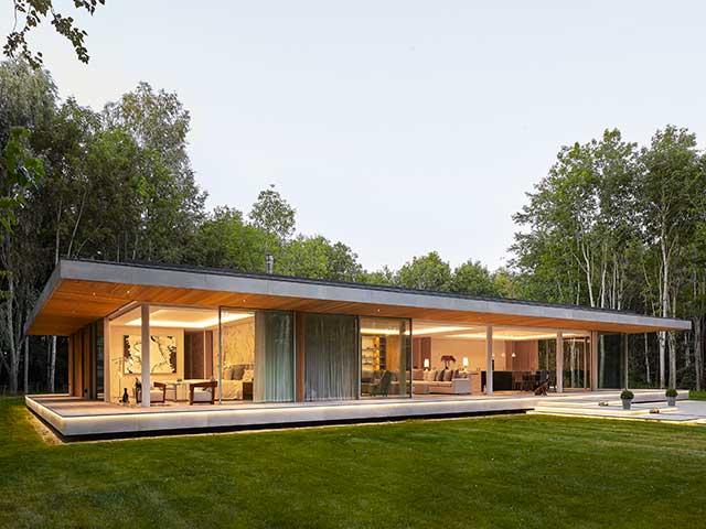

mjc55 Posted November 5, 2023 Author Share Posted November 5, 2023 1 hour ago, Crofter said: Welcome! Sounds like you've got a good skill set and have had plenty of time to think up some ideas. What style/size/construction are you leaning towards? Single storey, fairly modern style is what we are leaning towards. Probably around 100 sq. m., maybe a little bigger. We really don't require masses of space but that decision hasn't been made yet. An inspirational idea could be found with the attached, although not as much glass as that and certainly would need to be cheaper than the £3.6k per sq. m. that apparently cost. But it gives a general idea of what direction we would want to be moving in. Given our experiences over the last 40 years we would want to do as much work as is possible (I built a single storey extension on our last house as recently as 2016) but again that is something that we need to look at as we start the process. The current (putative) plan is to look at moving out of our rental as soon as is possible, and so to that end we would probably look at buying some form of mobile home to park on site. There currently are no services to that site (although all run along the lane outside the land). We are about a 20 minute drive from the site so not too far but being on site will obviously be more advantageous in the long run. We are currently in the adrenaline fueled excitement of purchasing the plot but I am not naive enough to think that this will last forever. I envisage some "interesting" times ahead but I guess that as this process has been running in the background for such a long time that we can cope with the ups and downs of the build process. 2 Link to comment Share on other sites More sharing options...

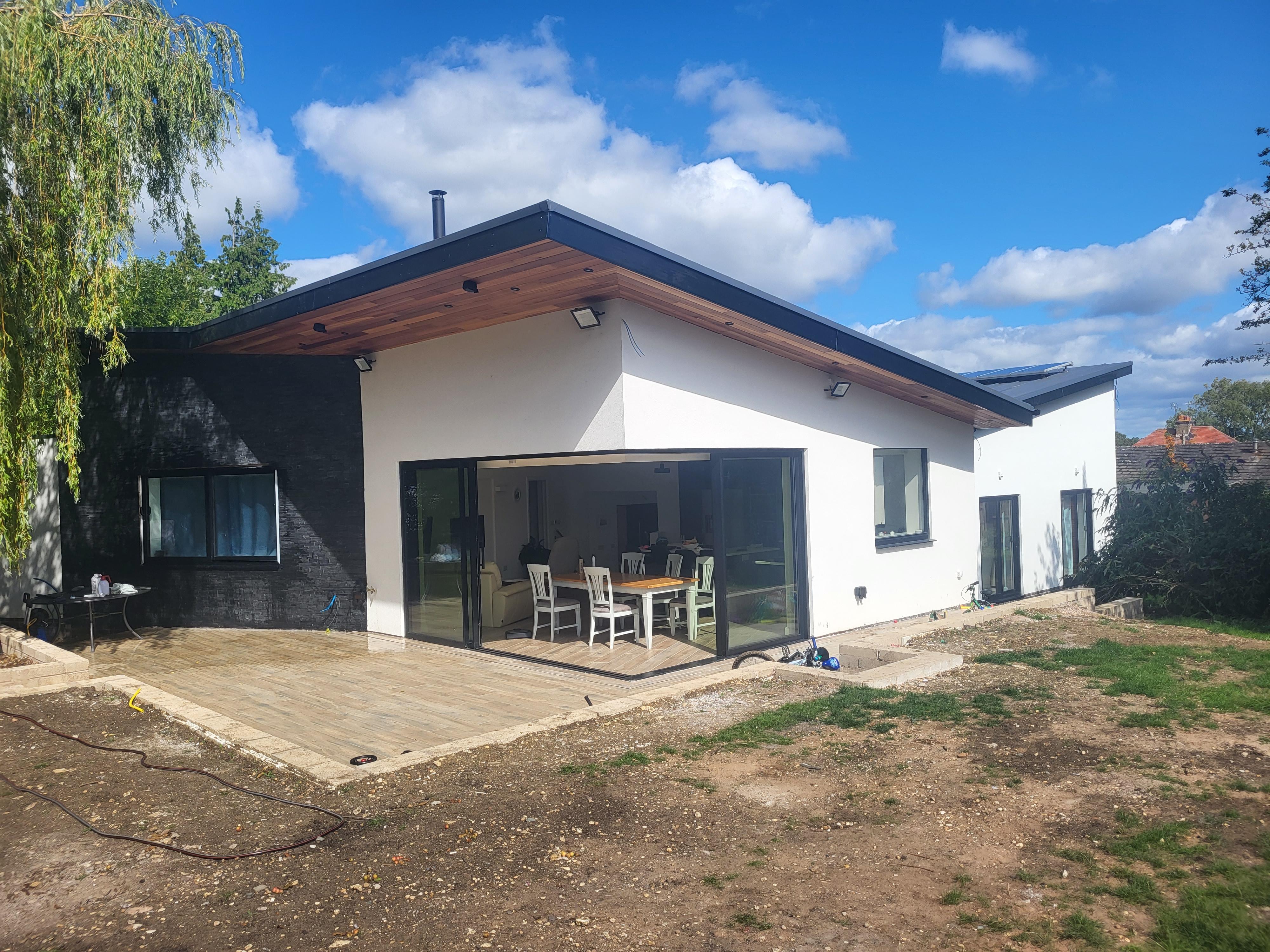

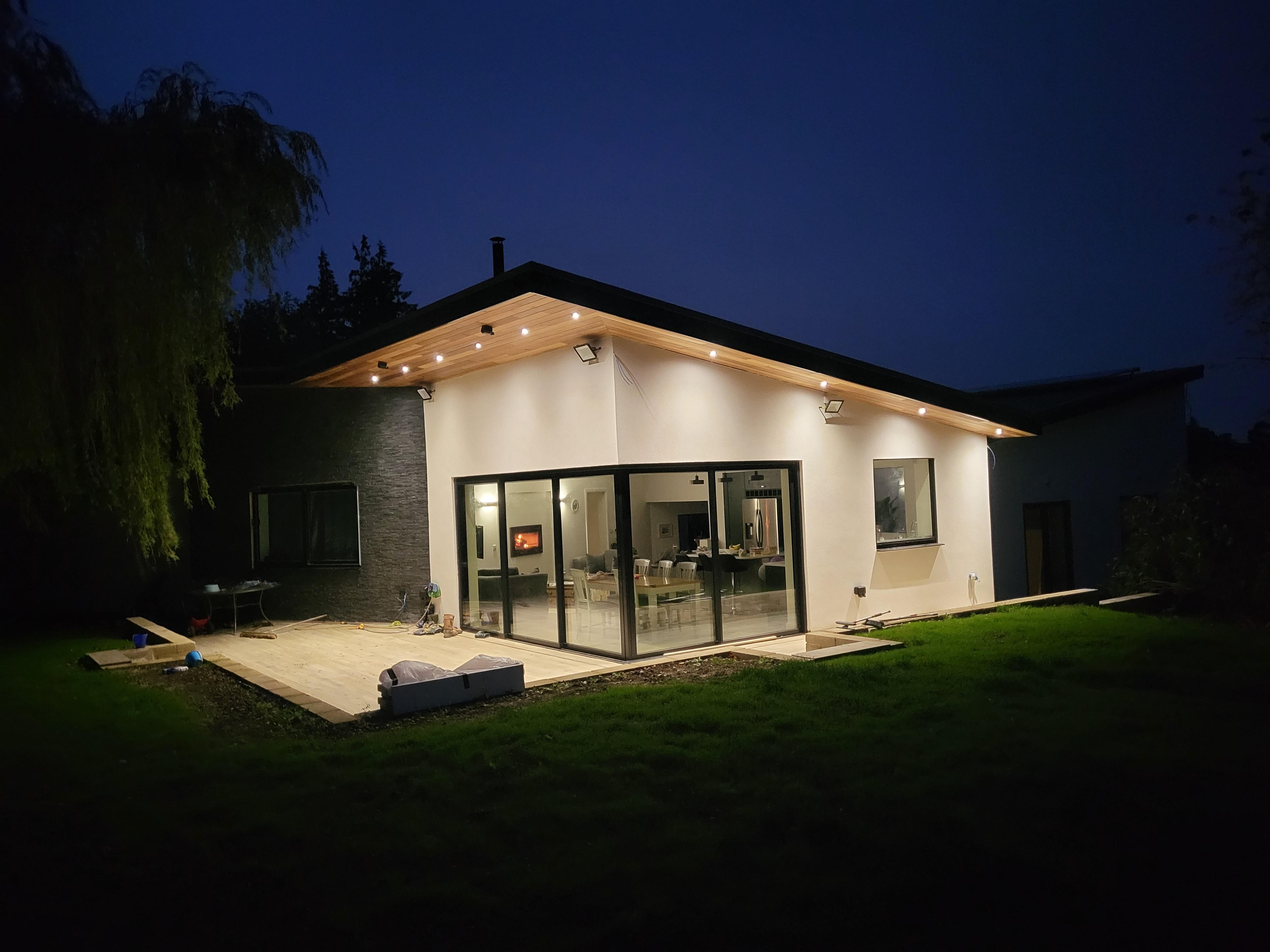

Andehh Posted November 5, 2023 Share Posted November 5, 2023 (edited) Very exciting! Not a million miles off our design.... Good luck! Edited November 5, 2023 by Andehh 1 Link to comment Share on other sites More sharing options...

saveasteading Posted November 5, 2023 Share Posted November 5, 2023 1 hour ago, Andehh said: our design @AndehhI've done this style a few times but always much bigger and as a steel frame. I think timber might be better here. What width is that roughly? The oversails are worth a lot of attention as they can be expensive or not. I quote a client £150/m run to see how much they like it. Don't forget you'll need a column in the corner. I'd make a feature of it a la Pompidou Centre. @mjc55 steel frame then timber batten? OR find a design by strom, as recently discussed. They seem to be standard, so maybe they have found an ideal solution, not that the price level reflects that. 1 Link to comment Share on other sites More sharing options...

Andehh Posted November 5, 2023 Share Posted November 5, 2023 (edited) 3 hours ago, saveasteading said: @AndehhI've done this style a few times but always much bigger and as a steel frame. I think timber might be better here. What width is that roughly? The oversails are worth a lot of attention as they can be expensive or not. I quote a client £150/m run to see how much they like it. Don't forget you'll need a column in the corner. I'd make a feature of it a la Pompidou Centre. @mjc55 steel frame then timber batten? OR find a design by strom, as recently discussed. They seem to be standard, so maybe they have found an ideal solution, not that the price level reflects that. It's 1.5m horizontal, about 1.8 of actual overhang. Down the side it's only 800mm. About 23sqm of surface area based on the cladding we put on. Brick and block with some serious steels to hold it all up, especially as its a floating corner that is suspending the overhang! Sliders are 5m on one side and 3m other side. Edited November 5, 2023 by Andehh 1 Link to comment Share on other sites More sharing options...

saveasteading Posted November 5, 2023 Share Posted November 5, 2023 1 hour ago, Andehh said: some serious steels to hold it all up, especially as its a floating corner that is suspending the overhang! Very impressive. A lot of steel for the omission of a column, and fun for your SE, but it does look good. From the first pic I thought it was half the size. Where does the valley gutter drain to? Link to comment Share on other sites More sharing options...
