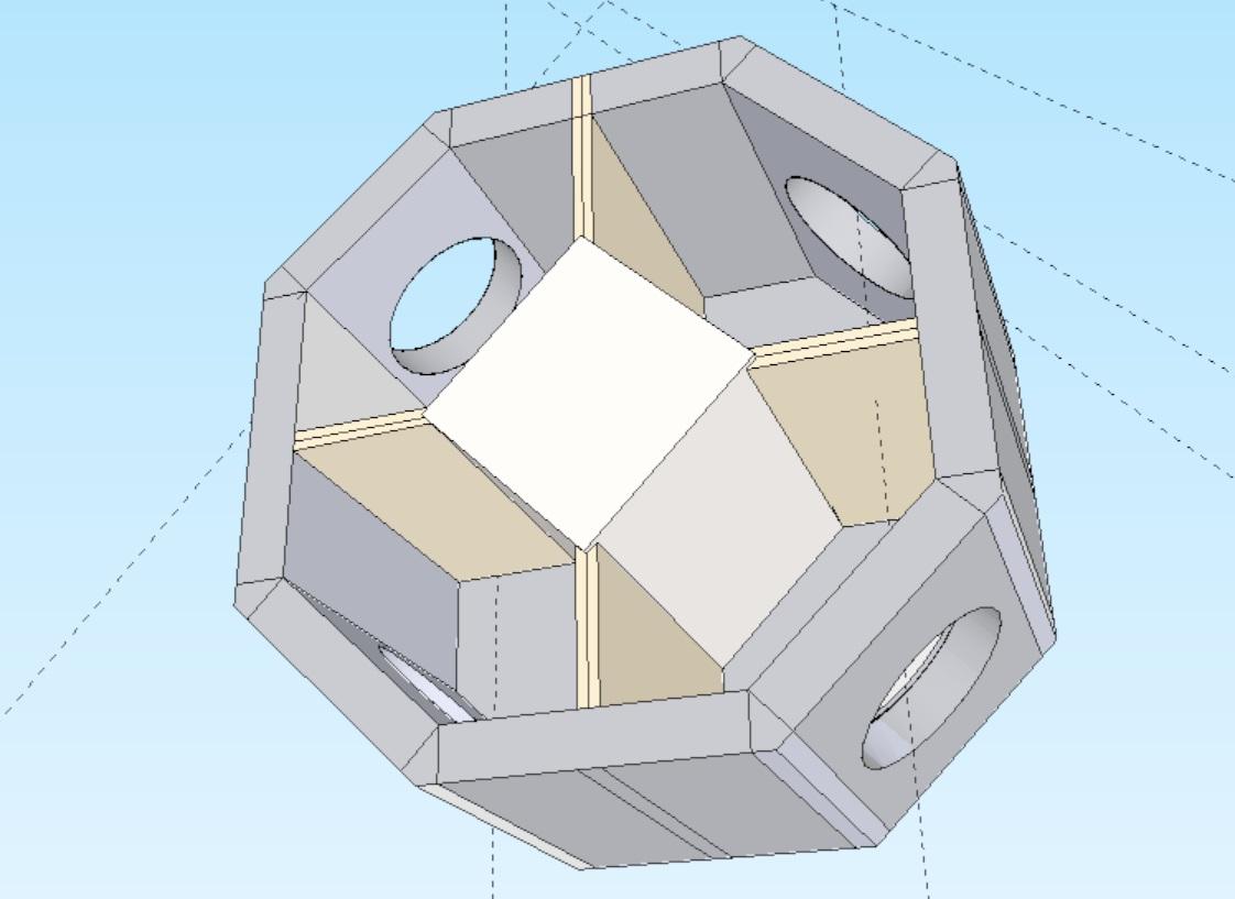

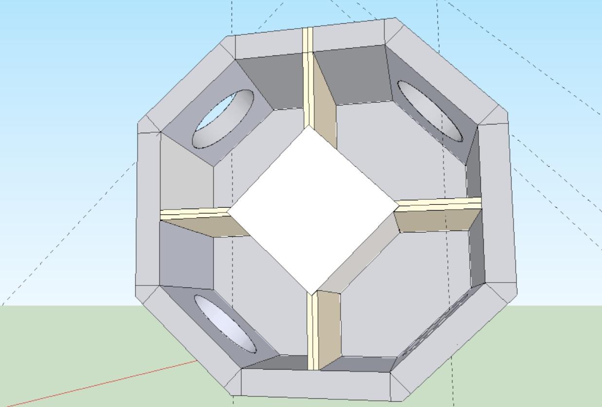

Would anyone like to critique my DIY heat exchanger?
Playing on sketch up before I actually cut anything.
I saved a fortune already.:)
It's 800mm by 800mm and the ducts are 180mm
The core is 227 by 227 by 383
Edited by Coanda
What about the fans?
What about filters to keep the HE clean?
I only paid £250 for a new unit on eBay, so not sure you will be saving much but if it's project/hobby don't flag it as a money saver.
Would it be easier to have a square box with a heat exchanger at 45 deg, then the inlet outlets can be on a straight face instead of a lot of different angles?
I started off with an oblong box but miscalculated the amount of space I needed for the spigots. I may well go back to that.

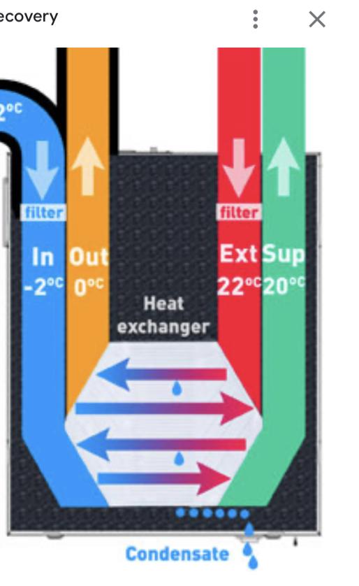

Interesting idea!  I think you’d need lots of them- if you had just one pair, and one thermosiphon, then I think the theoretical best efficiency will be 50%.
Often mvhr have hexagon shaped cores (well ours does), so that a lot of the heat exchanger is counter flow rather than cross flow, as this improves efficiency - like the pic below.  The HX is best made with many sheets of thin plastic spaced a couple of mm apart, more total area gives better efficiency.

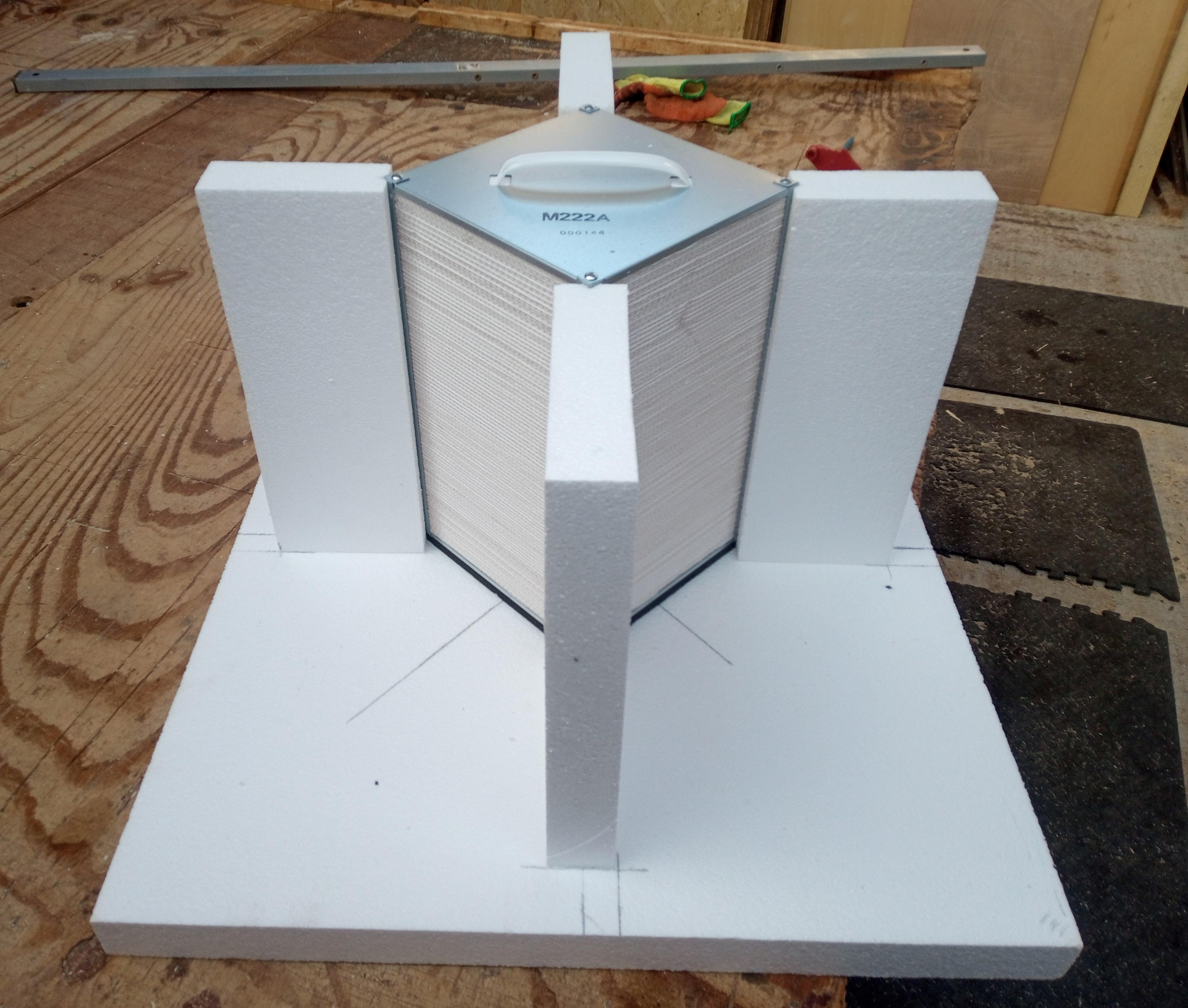

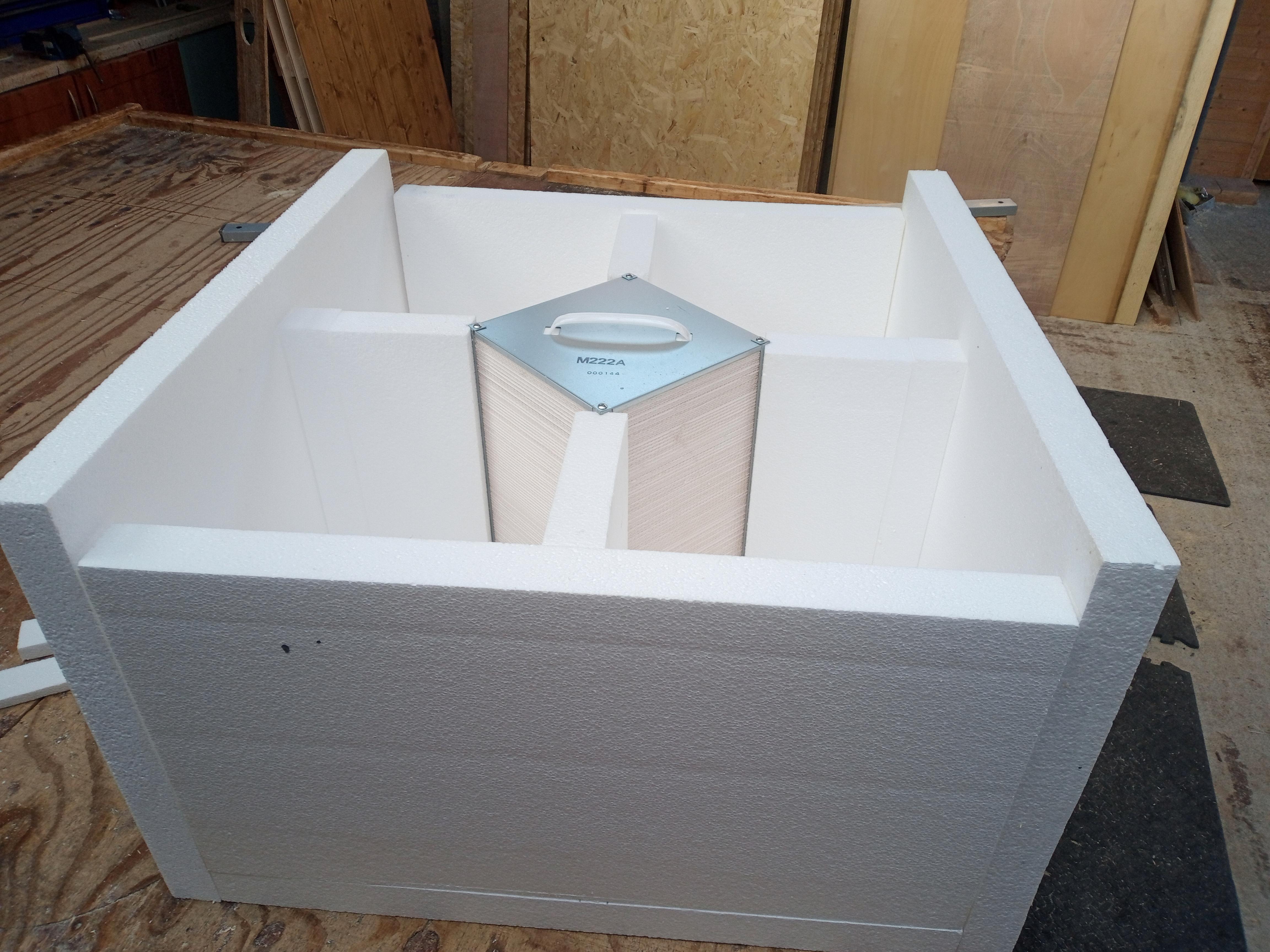

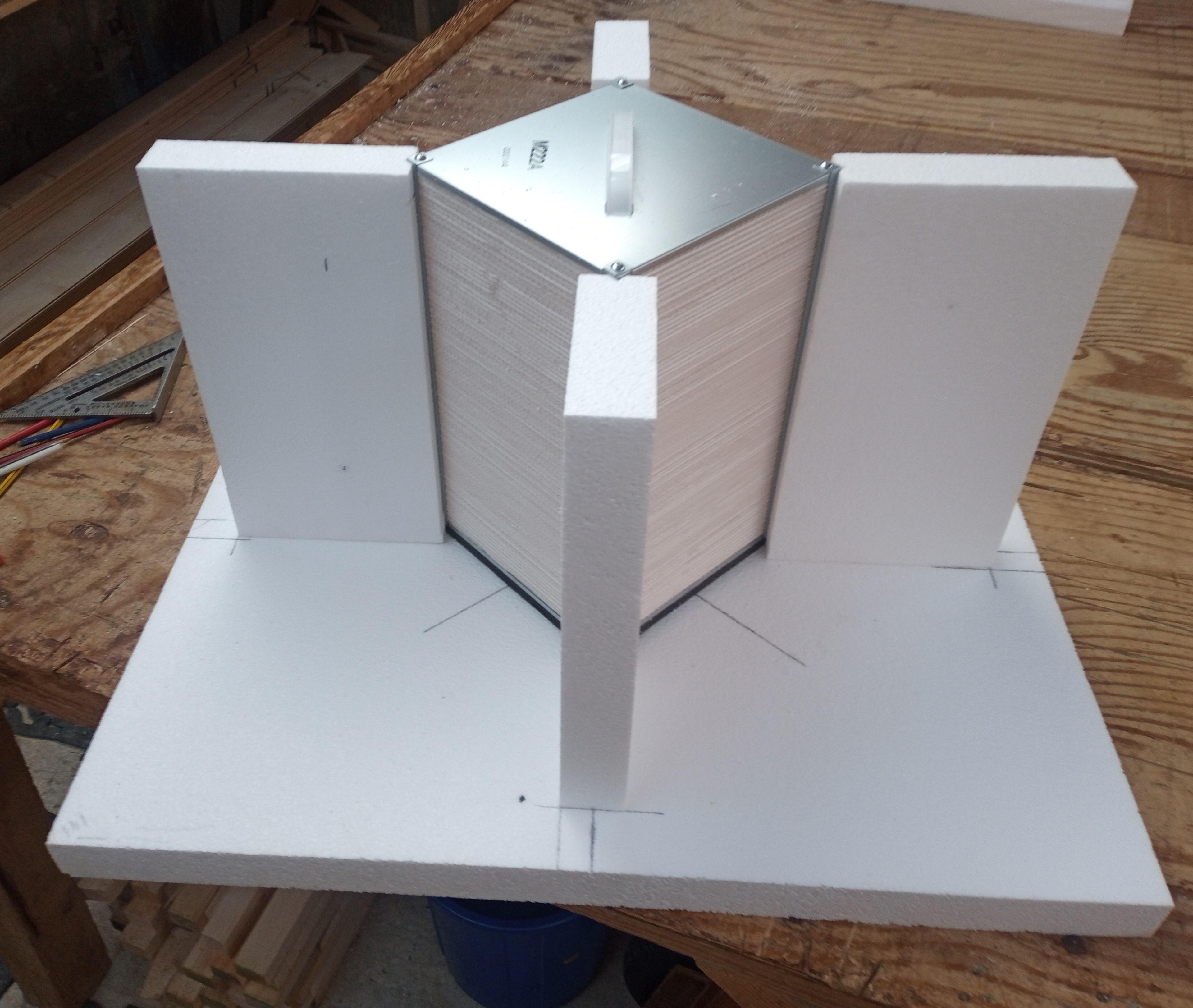

IMG_20231102_144830_480.thumb.jpg.5fdf02b19c79dbd6e883ed1867074f97.jpgIMG_20231102_144821_480.thumb.jpg.a67f519140c33a52010fa02aba2481ca.jpgI spent some time this afternoon cutting the parts. Careful design means I get it all out of one sheet of polystyrene. Overall size is 800mm by 820. by 485.
I've glued up a couple of test pieces with no more nails, and if its a success, I'll do the rest tomorrow.
I'm wondering should I use dowels for added strength?
Edited by Coanda

That's a crossflow design I'd say. And therfore less efficient.
As @RobLe pointed out you really want to start with a counterflow design.
It makes a very big difference to efficiency.
I can't disagree.
But this is my first attempt, which I am treating as a learning curve.
Using what I have as far as possible and the crossflow core which didn't cost much at all.
