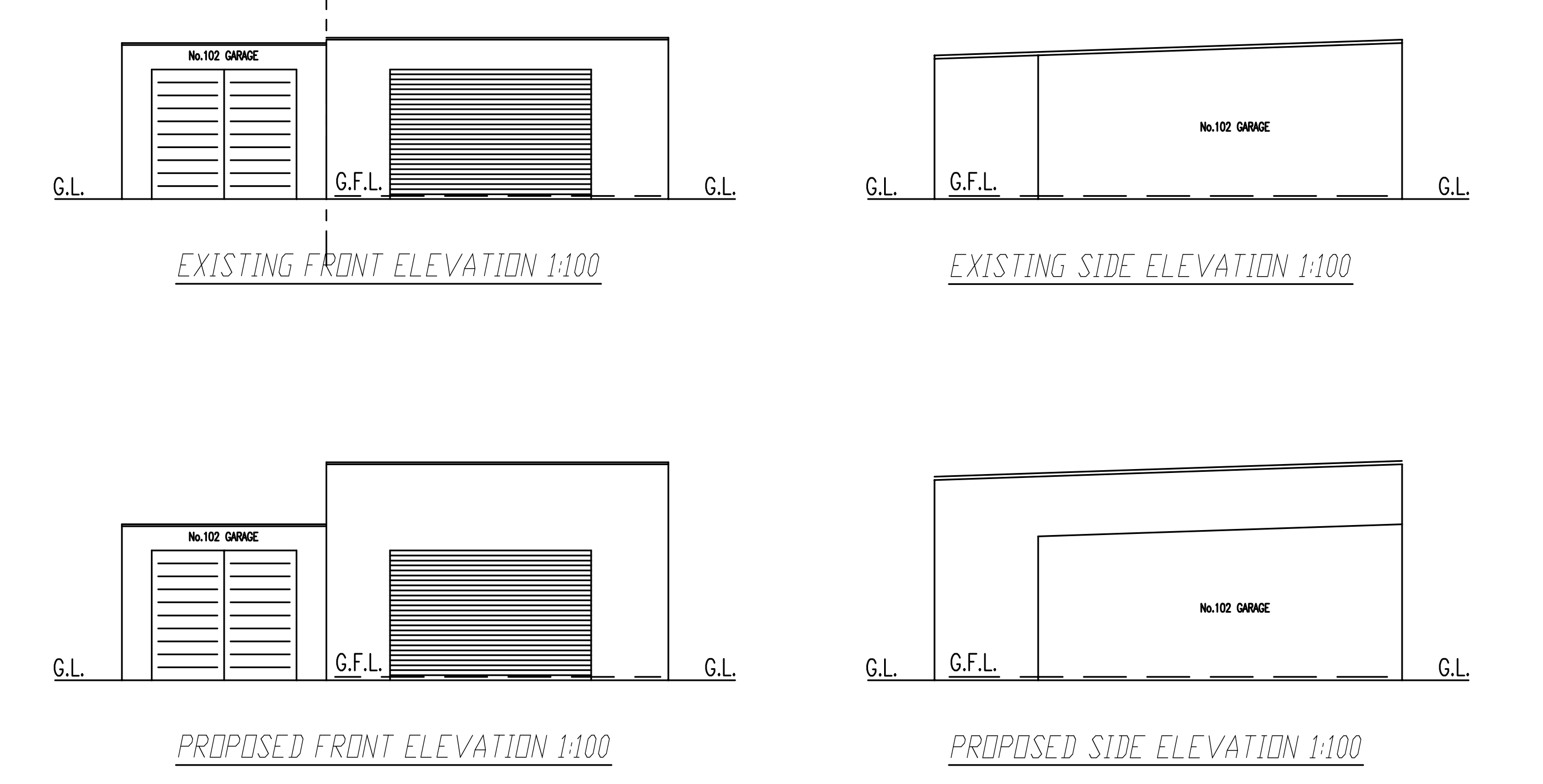

david656 Posted October 29, 2023 Author Share Posted October 29, 2023 1 minute ago, ProDave said: It is not clear, has planning permission actually been refused, or are they merely at the moment discussing the application with you and saying they are minded to refuse it for all sorts of odd reasons? Sorry to be clear they have made their decision which is refusal: NOTICE OF DECISION TOWN AND COUNTRY PLANNING ACT 1990 South Gloucestershire Council in pursuance of powers under the above mentioned Act hereby REFUSE to permit: Raising of garage roofline. No discussion ever took place as such, and I wasn't made aware of any of the further remarks until after the refusal was issued. the only whiff of issue was them saying is it for commercial use perhaps and us saying absolutely not, to which in their final decision they carried on with that narrative. Link to comment Share on other sites More sharing options...
ProDave Posted October 29, 2023 Share Posted October 29, 2023 They should provide the grounds on which they refused the permission. i.e. reason for refusal. I would appeal. That costs you nothing. Don't mention the Arcade machines, just focus on the fact at the moment you have a garage with very limited headroom that you cannot even stand upright in, and you just want to raise the height so it becomes a normal usable garage that you can stand up in, keep your car in, perform normal maintenance tasks on the car, and have some shelving to store usual tools and materials. Link to comment Share on other sites More sharing options...
david656 Posted October 29, 2023 Author Share Posted October 29, 2023 6 minutes ago, ProDave said: They should provide the grounds on which they refused the permission. i.e. reason for refusal. I would appeal. That costs you nothing. Don't mention the Arcade machines, just focus on the fact at the moment you have a garage with very limited headroom that you cannot even stand upright in, and you just want to raise the height so it becomes a normal usable garage that you can stand up in, keep your car in, perform normal maintenance tasks on the car, and have some shelving to store usual tools and materials. Their reason for refusal is: By reason of its size and scale, the proposed raising of the garage roofline would not sufficiently respect the character or context of the immediately surrounding area and would detrimentally harm the character and appearance of the area. Which having done a bit of googling it is a dangerous trump card councils can use when they just want to say 'no' without having a genuine reason for doing so. They have even contradicted their reason for refusal in their report by saying they didn't have an issue with the height. but essentially they seem to be saying by adding just one additional layer of brick it would change the visual look of the garage and this will not respect the character of the street! I joke not - it's a dump out there, broken down cars, caravans in gardens, bloke over the road has midnight raves the police never do anything about - it's a real classy place. We will be appealing and I hope to stress the absurdity of the current internal head height as a very valid reason for needing to increase the height. I would rather not mention anything about cars at all as 1) I have no intension of doing so and 2) it seems to give some aspect of truth to their completely false narrative. It's just extremely disappointing that they have refused in the way they have without actually engaging in conversation. I also fear that their weird 'character' trump card basically means any changes are off the cards as how can you change the height and keep it visually the same height - it isn't a Tardis! Link to comment Share on other sites More sharing options...
Alan Ambrose Posted October 29, 2023 Share Posted October 29, 2023 (edited) Hmmm, assuming you’re not in a conservation area etc, these are the permitted development rules: No outbuilding on land forward of a wall forming the principal elevation. Outbuildings and garages to be single storey with maximum eaves height of 2.5 metres and maximum overall height of four metres with a dual pitched roof or three metres for any other roof. Maximum height of 2.5 metres in the case of a building, enclosure or container within two metres of a boundary of the curtilage of the dwellinghouse. No more than half the area of land around the "original house"* would be covered by additions or other buildings. Are you ‘breaking’ one or more of these? What kind of roof is it? Edited October 29, 2023 by Alan Ambrose Link to comment Share on other sites More sharing options...
ProDave Posted October 29, 2023 Share Posted October 29, 2023 Perhaps a picture of your existing garage? It it attached or detached? You could do it under PD as above with a pitched roof limited to 2.5 metres at the eaves, which would not give the headroom you wanted at the eaves but would in the middle. But at least you should be able to stand up at the eaves. I read it as being a flat roofed garage at the moment and raising that to an internal height of 2.7M would make it more like 3M outside which would be above the PD rules. Link to comment Share on other sites More sharing options...
david656 Posted October 29, 2023 Author Share Posted October 29, 2023 2 minutes ago, Alan Ambrose said: Hmmm, assuming you’re not in a conservation area etc, these are the permitted development rules: No outbuilding on land forward of a wall forming the principal elevation. Outbuildings and garages to be single storey with maximum eaves height of 2.5 metres and maximum overall height of four metres with a dual pitched roof or three metres for any other roof. Maximum height of 2.5 metres in the case of a building, enclosure or container within two metres of a boundary of the curtilage of the dwellinghouse. No more than half the area of land around the "original house"* would be covered by additions or other buildings. Are you ‘breaking’ one or more of these? I'm absolutely not in a conservation area, it's the most boring run of the mill estate ever. As I understand it those development rules are in the case of NOT needing planning, so you can build a garage with a flat roof maxing out at 3 meters without planning, but because of how awkward my neighbour is, and to avoid any issues I chose to go the planning route and do this 'properly' they are estimating the proposed higher side (flat sloping roof) will be about 3.2 meters - which is why I've gone the planning route. I know of many people with garages bigger than most houses, they have applied for planning because of this and got it approved. So it just seems ludicrous to me that they have clearly stated the height isn't actually the issue in principal, just that visually it won't be in keeping with the character of the street. which we said in the planning we will match the colour of the brick, extend the rendering where the side wall is rendered and matched. The other amusing thing is the house directly opposite ours had a garage that is in no way in keeping with the garages in the street, it's bigger squarer, generally quite ugly and that got approved in the 80s. Link to comment Share on other sites More sharing options...
david656 Posted October 29, 2023 Author Share Posted October 29, 2023 1 minute ago, ProDave said: Perhaps a picture of your existing garage? It it attached or detached? You could do it under PD as above with a pitched roof limited to 2.5 metres at the eaves, which would not give the headroom you wanted at the eaves but would in the middle. But at least you should be able to stand up at the eaves. I read it as being a flat roofed garage at the moment and raising that to an internal height of 2.7M would make it more like 3M outside which would be above the PD rules. again this is a weird one, it is a flat sloping roof. there are no garages with pitched roofs in the area and apparently they would never be allowed at any height because it isn't in keeping. The garage is detached from the house but attached to my other neighbours garage, who actually has no issue with this, always knew we were planning to raise the roof, and even commented he has heard me often bend down to pick something up, go to stand up quickly and nearly knock myself out as I slam into the roof. As I say the council haven't made any suggestions as to what they would be happy with, and I strongly believe they are angling this in a way that they wouldn't be happy with any changes ever. Link to comment Share on other sites More sharing options...
ProDave Posted October 29, 2023 Share Posted October 29, 2023 So you could do that under permitted development, 3 metres at the front reducing to 2.5 metres at the back. OR make it slope sideways and level front to back, so 3M at the party wall side sloping down to 2.5M at the right as viewed from the front. It would give you the high ceiling one side and should still be high enough to stand up at the other. But that is just your fall back position of what you could do without PP should your appeal fail. Link to comment Share on other sites More sharing options...
david656 Posted October 29, 2023 Author Share Posted October 29, 2023 Just now, ProDave said: So you could do that under permitted development, 3 metres at the front reducing to 2.5 metres at the back. OR make it slope sideways and level front to back, so 3M at the party wall side sloping down to 2.5M at the right as viewed from the front. It would give you the high ceiling one side and should still be high enough to stand up at the other. But that is just your fall back position of what you could do without PP should your appeal fail. Yeah it's really good points of what 'could' be done with out planning permission, the funny thing is if I did what you suggest and slope it sideways that would totally change the appearance of it all. Not that I would want to go this route but I would assume I could have a 3m dead flat roof across the entire garage and not need PP for that. What is so frustrating is I've tried to go the proper route here, I've used an architect, I've applied for planning permission blah blah, and they've rejected it without any sort of tangible reason. I've tried to go the right route as I know the neighbour will be out there and on the phone to the council moaning and I'll have someone come out and halt works - that's just the kinda guy this guy is. Link to comment Share on other sites More sharing options...

Alan Ambrose Posted October 30, 2023 Share Posted October 30, 2023 Well much sympathy, some of us have been there before... Yeah, suggest, in parallel, (a) appeal the current design making much of 'I can't actually stand up in the current garage' and (b) submit an alternative design which works under PD and apply for a Lawful Development Certificate. I'm not sure I'm terribly impressed with your advisers for ending up at this point. 1 Link to comment Share on other sites More sharing options...
david656 Posted October 30, 2023 Author Share Posted October 30, 2023 1 hour ago, Alan Ambrose said: Well much sympathy, some of us have been there before... Yeah, suggest, in parallel, (a) appeal the current design making much of 'I can't actually stand up in the current garage' and (b) submit an alternative design which works under PD and apply for a Lawful Development Certificate. I'm not sure I'm terribly impressed with your advisers for ending up at this point. Yeah... the planning chap I'm using (lovely guy) came recommended as he has handheld some big projects over the line,. I did warn him I'm very unlucky and this was bound to hit all sorts of weird blockers because of awkward neighbours etc, but I think he thought this one would walk itself over the line and it hasn't. At the end of the day to a normal person, how complicated can/should it be to get 3ft added to your garage height? ... in this world and my case, extremely sodding difficult! I've got to wait for him to get back from holiday and hopefully ask them why they haven't contacted us about any of these false claims, and ask them to reconsider via appeal. Link to comment Share on other sites More sharing options...

DevilDamo Posted October 30, 2023 Share Posted October 30, 2023 There is no PD fallback position so you have no choice but to apply for Planning. Tbh, I can see and agree with the LPA’s decision. It makes it worse that it’s attached to the neighbours’ garage. 1 Link to comment Share on other sites More sharing options...
david656 Posted October 30, 2023 Author Share Posted October 30, 2023 1 hour ago, DevilDamo said: There is no PD fallback position so you have no choice but to apply for Planning. Tbh, I can see and agree with the LPA’s decision. It makes it worse that it’s attached to the neighbours’ garage. that neighbour hasn't objected, and why do you say there is no PD fallback? Thanks. Link to comment Share on other sites More sharing options...
DevilDamo Posted October 31, 2023 Share Posted October 31, 2023 22 hours ago, david656 said: that neighbour hasn't objected, and why do you say there is no PD fallback? Thanks. Because it’s within 2m of the boundary and would exceed 2.5m in height. PD doesn’t also allow you to build onto or above a neighbours wall which may form the boundary. Link to comment Share on other sites More sharing options...
