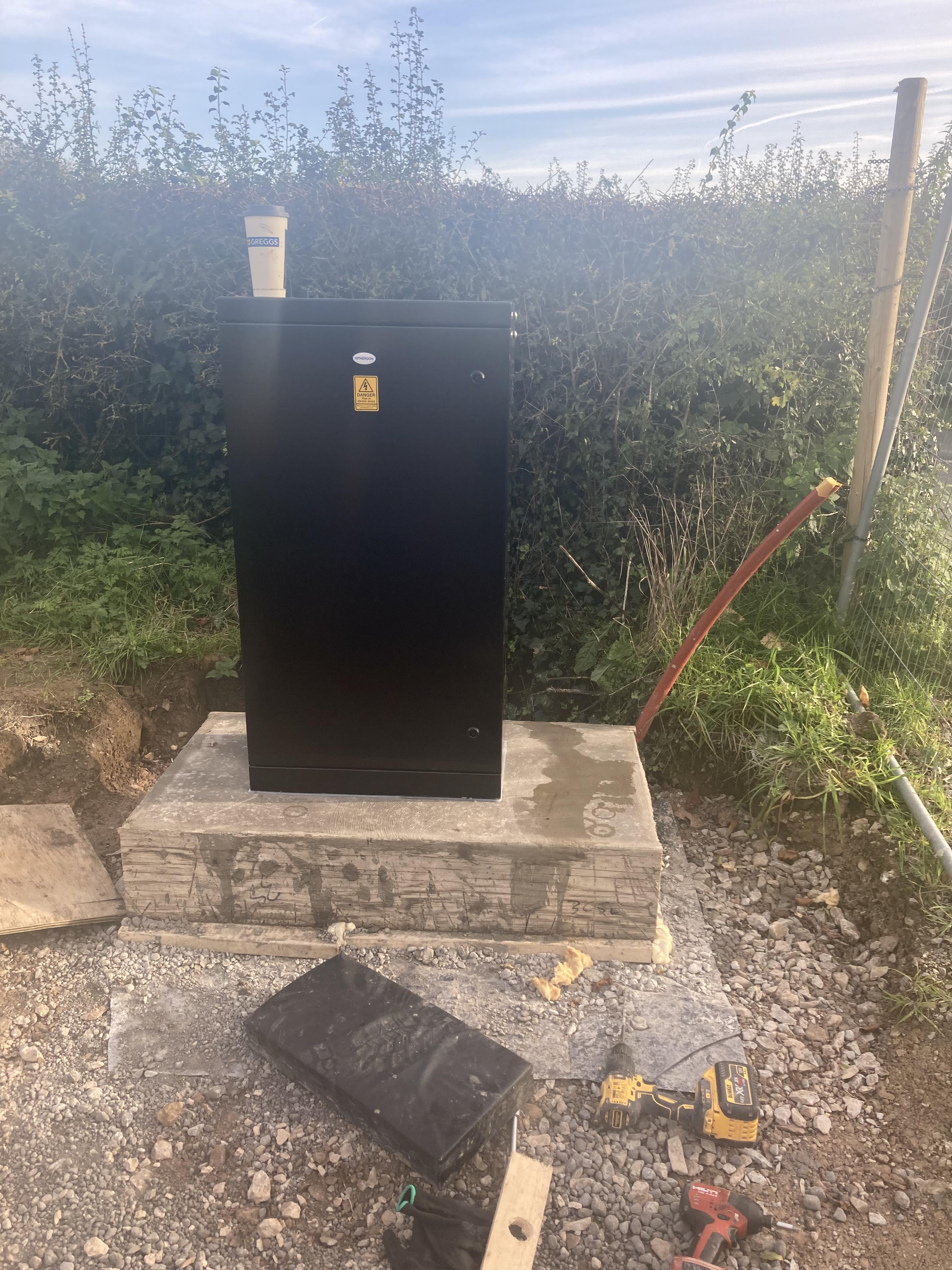

Kelvin Posted October 24, 2023 Share Posted October 24, 2023 Whichever is easiest. Sounds flippant but don’t make life hard for yourself. How likely is it will get hit by a car where it is? Mine is in a kiosk on our boundary. I don’t intend moving the meter so here it will stay. 1 Link to comment Share on other sites More sharing options...
LnP Posted October 24, 2023 Share Posted October 24, 2023 5 hours ago, Meabh said: So we demolished our old house in March - had the gas capped by SGN (and smart meter removed by EDF who then asked us to prove it was removed by them...) - had the electric supply & smart meter moved to a white meter box on a boundary wall facing the street (again dealing with EDF & the smart meter was a total nightmare, SPEN were great). I've just moved the gas and electricity meters out of the old house into nearby freestanding cabinets in preparation for demolishing the old house. We will live in an on site outbuilding during the self build so need the utilities to continue. The network operators (Cadent for gas and SPEN for electricity) we pretty good to deal with, but energy supplier Eon Next were hopeless. I needed to coordinate installation of the new relocated meters with the new supply connections so we wouldn't be left without supply. I gave up on Eon Next and switched to Octopus because of their reputation for good service and indeed they were much more helpful. For both gas and electricity, their technicians turned up on the day as planned. Link to comment Share on other sites More sharing options...

LiamJones Posted October 26, 2023 Share Posted October 26, 2023 FWIW option 2 is unlikely possible. My DNO UKPN refused to install a supply internally, either had to be meter box on an outside house wall or an external kiosk, I opted for the latter. Link to comment Share on other sites More sharing options...
