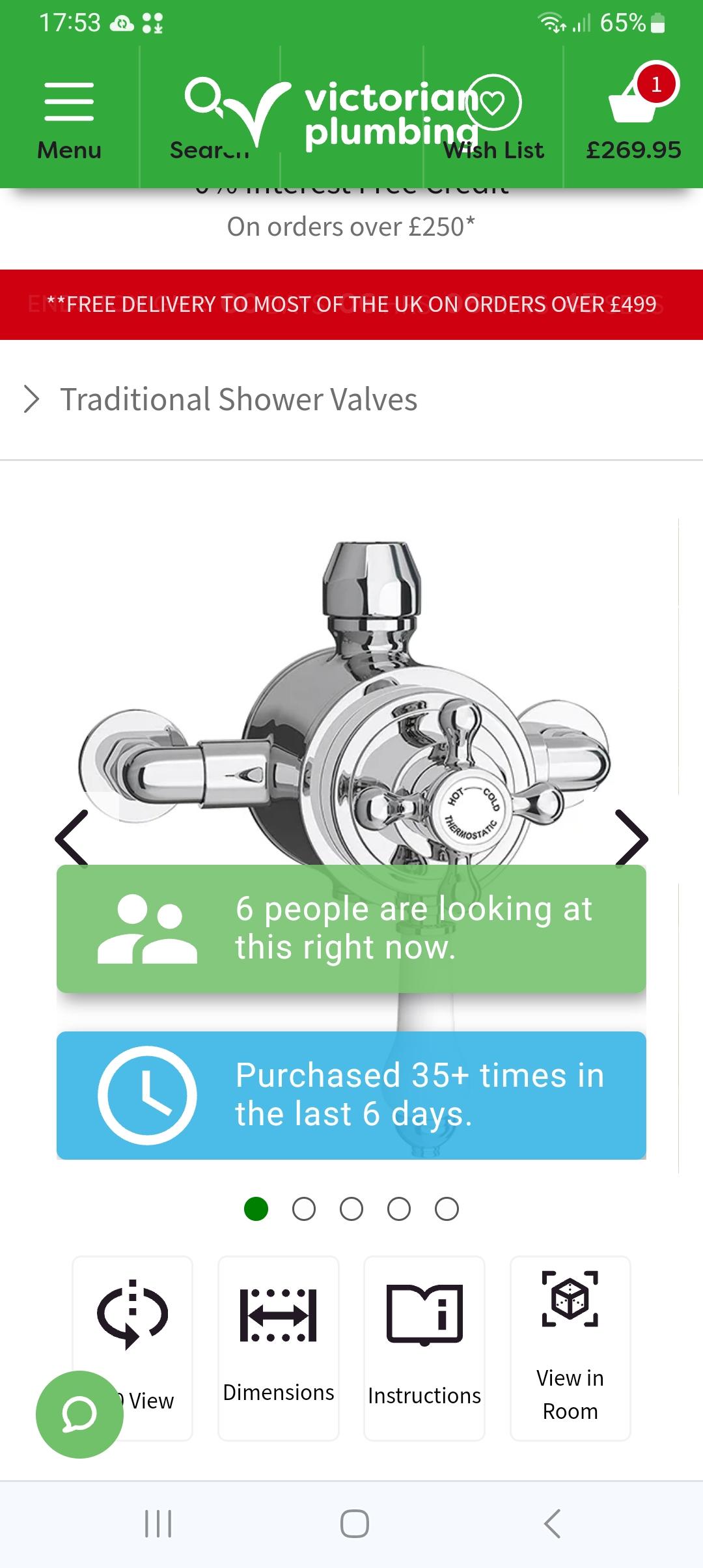

Dee Posted November 21, 2023 Author Share Posted November 21, 2023 The backnpanel hasc2 holes for the shower pipes. They're copper tails with push fit pladtic pipes and on the end of the tails chunky white end caps. When cutting these holes in the panel they will have to be quite big to slide over the end caps.....Will they be too big for the valve to hide or should the holes be just bigger than the copper? I can't take the end caps off as the pipes are live 🙄 Link to comment Share on other sites More sharing options...
Dee Posted November 21, 2023 Author Share Posted November 21, 2023 I planned to use an exposed valve like the image Link to comment Share on other sites More sharing options...
Dee Posted November 22, 2023 Author Share Posted November 22, 2023 Had a flash of inspiration! Artist Nephew has a wide roll of paper so i stapled it up on one side straight against the best wall. Scribed along ceiling, other wall and tray. Cut holes in separate piece of paper and stuck these on precisely. Now to cut! Link to comment Share on other sites More sharing options...
Dee Posted November 22, 2023 Author Share Posted November 22, 2023 My idea worked out so well! 3 perfect cuts and two perfectly placed holes. Small achievement for pros but a massive one for me....chuffed to bits! 3 Link to comment Share on other sites More sharing options...
