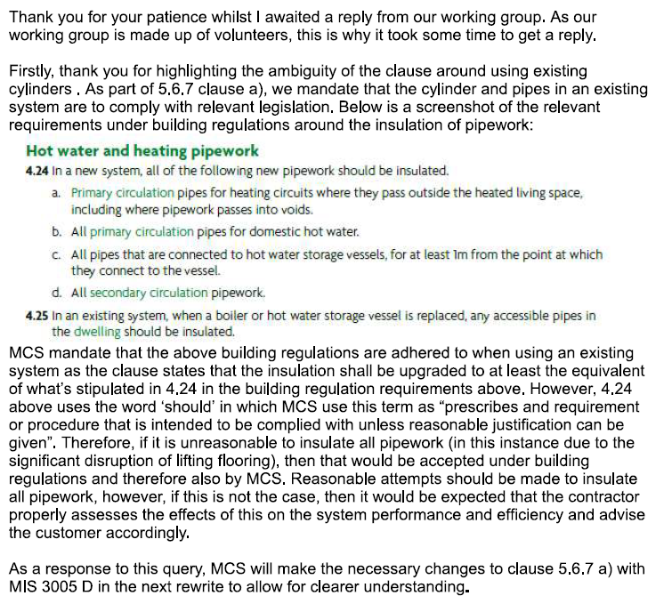

markharro Posted October 23, 2023 Posted October 23, 2023 Hi I know that the pipes need to be well insulated once they exit the external wall between the wall and the fan unit but does the pipe run once it is inside the house from the penetration points to the hot water tank does this pipe run also need to be insulated (in a passive house)? thanks

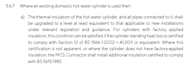

JamesPa Posted October 23, 2023 Posted October 23, 2023 (edited) Both building regulations and MCS rules have something to say about this. Under building regulations, in a newbuild, the answer is that primary circulation pipework must be insulated where it is 'outside the heated living space'. In a retrofit this applies to only to accessible DHW pipework. 'The heated living space' excludes 'voids'. MCS rules (specifically MCS3005 - D clause 5.6.7) prima facie go further than building regs in the case of a retrofit, and require distribution pipes to the cylinder (if the cylinder is replaced) to be insulated whether or not they are accessible. However I argued with them over this and they conceded that the ambiguous text should be interpreted to require insulation in retrofits only where accessible. Here is a screenshot of the communication from MCS which also includes the relevant extract from building regs. Here for reference is the relevant extract from MCS 3005-D Edited October 23, 2023 by JamesPa
