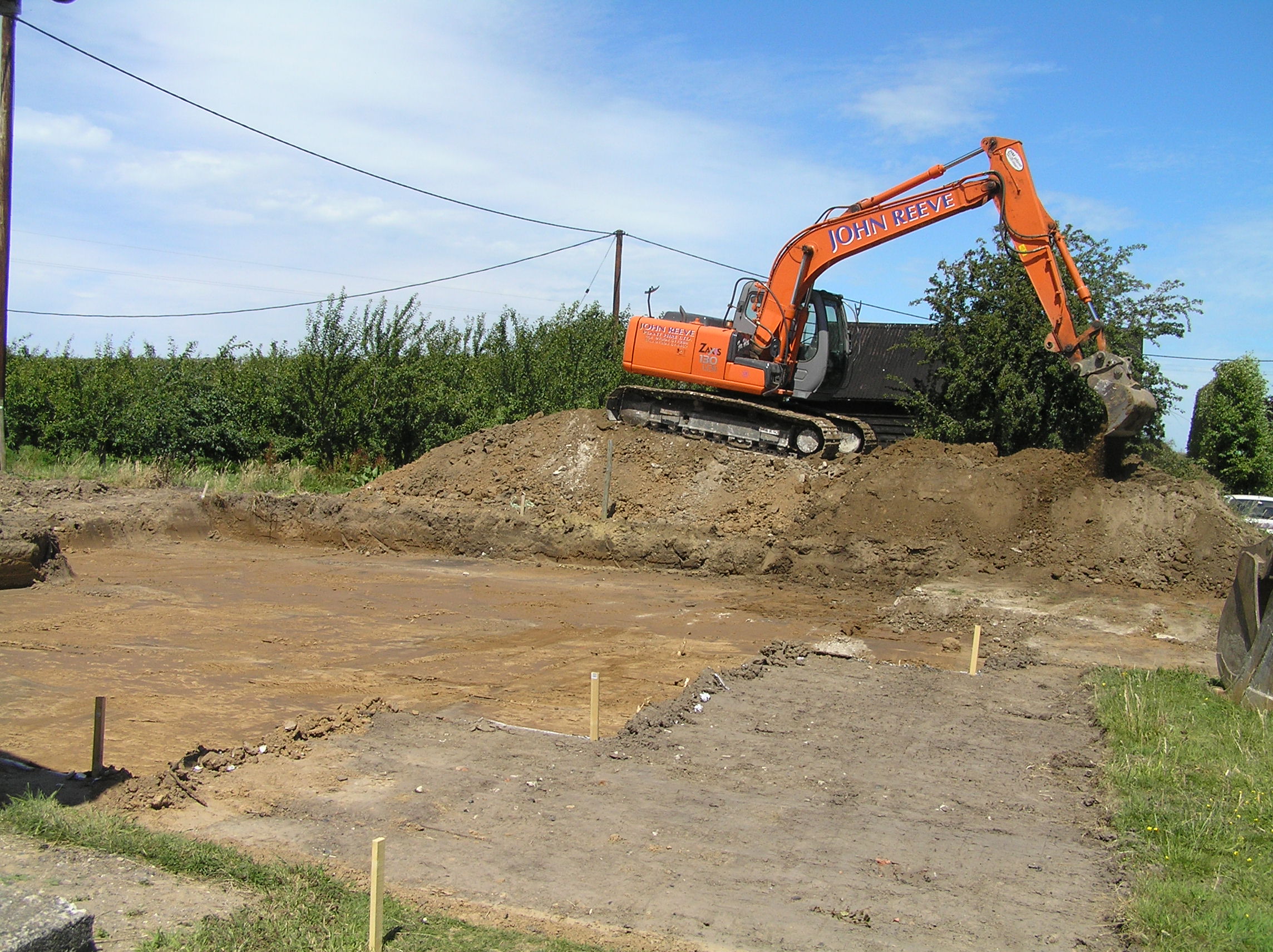

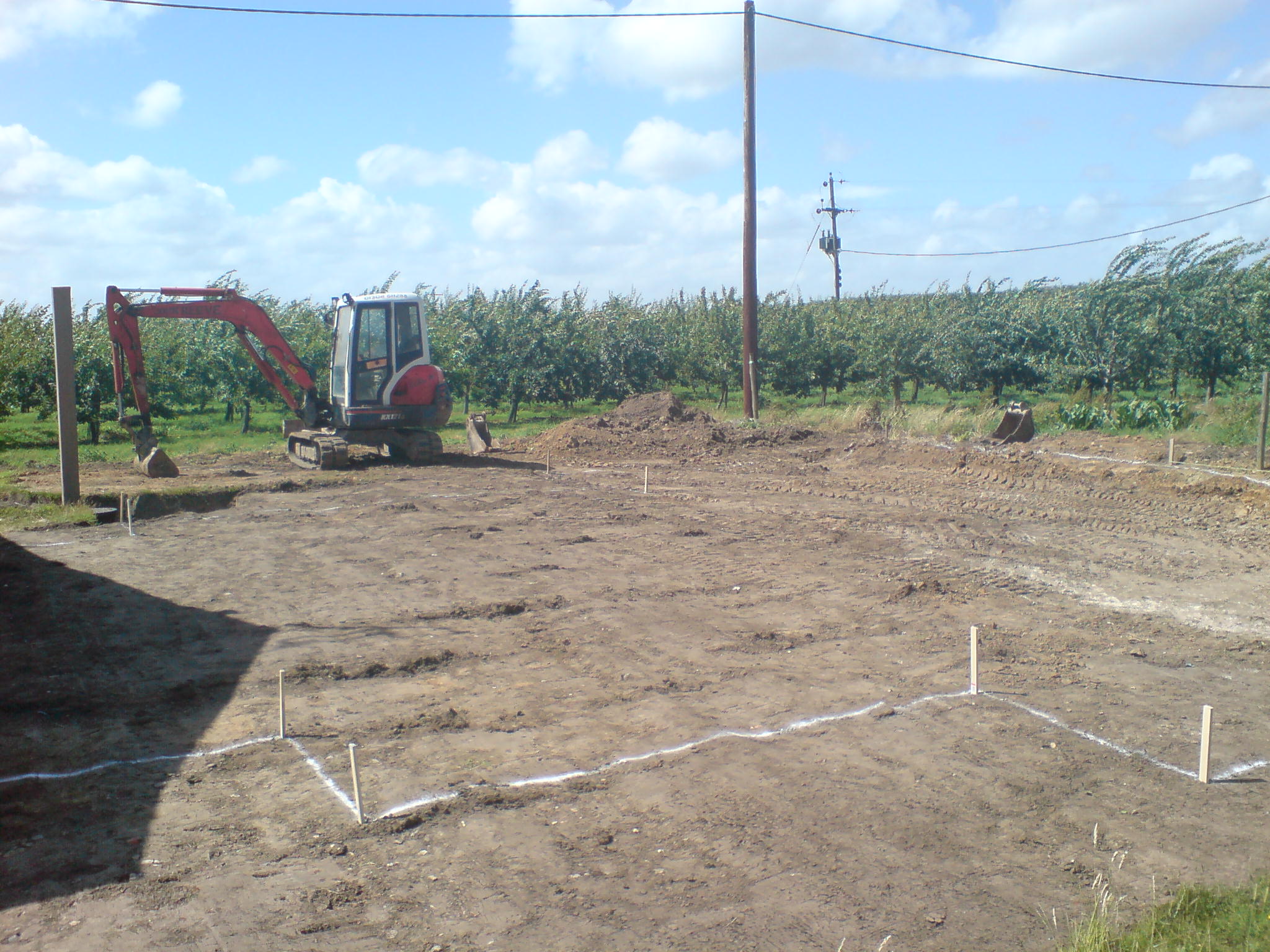

You can easily. Make the area a little larger than the plans and mark out with wooden pegs and string lines. Mark out the string lines on the ground with spray paint. Make sure distances to boundaries are correct and corners are square. Ours was a complex shape so took a while double checking everything but was relatively straightforward. We hired a digger with operator for £370 and he dug out around 90 tons of soil which he piled up in the orchard next door.

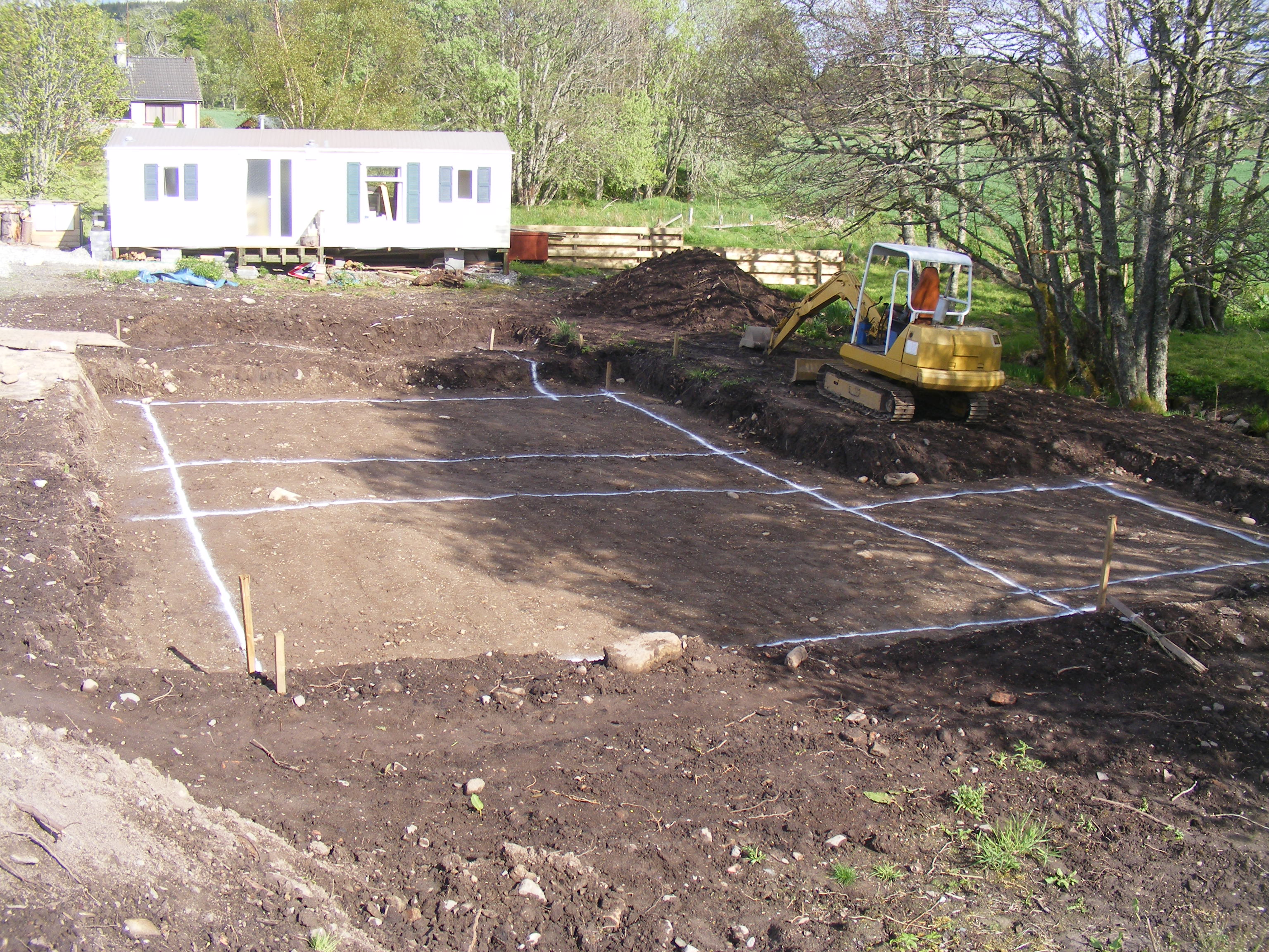

I did the same as Peter. Stripped the top soil off part of the site where the house was going down to a level base.  I then got about 10 tons of hardcore and spread that, just to give a more firm surface that was less likely to get chewed up by the digger tracks.
Then as Peter, I marked out the centre of each wall and marked with floor marking paint. Checking measurements for length, and diagonals to ensure it was square.
I then dug the trenches, it being easy to dig to a line marked as the centre of where you want it.
When the builders turned up, the first thing they did before pouring concrete was set up their profiles. They did not believe that this method would have got the trenches in the right place. At the end of the day they agreed it was all spot on.

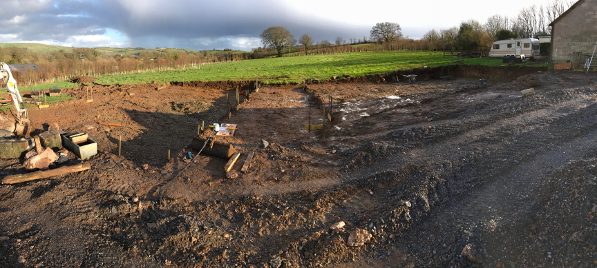

Exactly as Prodave and Peter.. I think we moved 500 tonnes +. We used a 3 tonne digger which was a bit small tbh. I set the profiles as far back as possible on the site so we could reuse them, checked again for the blockwork after the concrete pour. It was all quite enjoyable.
