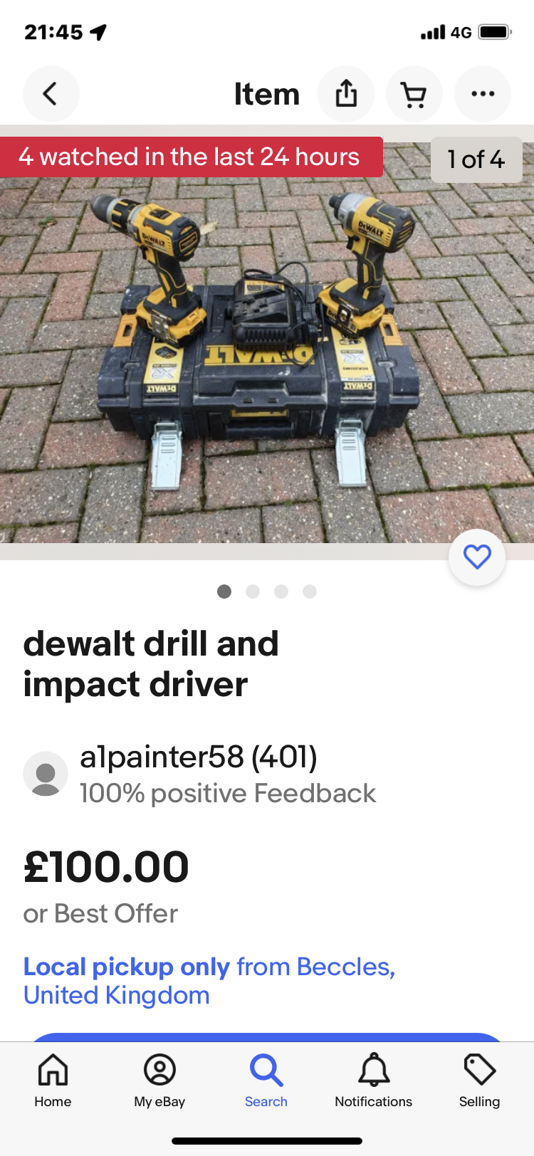

Nickfromwales Posted October 12, 2023 Share Posted October 12, 2023 Link to comment Share on other sites More sharing options...
Nickfromwales Posted October 12, 2023 Share Posted October 12, 2023 The issue you’ll have with a 230v drill is how big (long) it will be and how few places you can practically utilise it. The above kit for change of £100 will probably do you down to a T, and even though you probably won’t, you could sell it for £60-£80 after you’re done with it. You’re not going to get the tool you want any cheaper than that, I very much doubt, plus this is an impact and a combi! Link to comment Share on other sites More sharing options...
