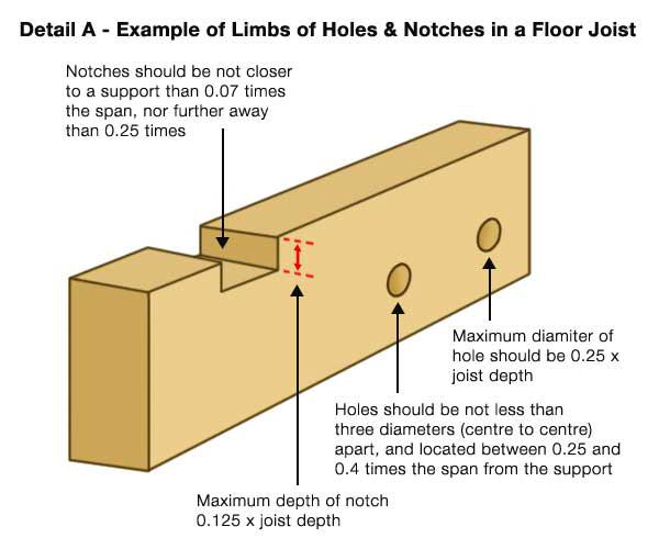

Temp Posted October 8, 2023 Share Posted October 8, 2023 On 08/10/2023 at 08:40, Sparrowhawk said: Are there any products approved for use here? Expand I doubt they can blanket approve something like this as too many variables. I suppose it's upto your BCO to approve it and they might want to see the design justified by a SE to cover their backside. Normally joists are sized to allow some holes without reinforcement. These should be on the vertical centre line and a diameter no more than a quarter of the joist height. There is also a limit of where they can be along the joist. Not sure if these are the latest rules.. https://www.diydoctor.org.uk/projects/Notching_joist.htm 1 Link to comment Share on other sites More sharing options...

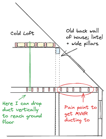

Sparrowhawk Posted October 11, 2023 Author Share Posted October 11, 2023 (edited) On 10/10/2023 at 19:45, Gus Potter said: Each case needs considered on it's merits. Can you tell us a bit more about what you want to do? Expand While I've got the floors up I want to install MVHR ducting. There are ground floor rooms where there's no vertical drop from the loft, and the joists run across the direction the ducts need to go. So I started looking at how I could cut big holes in joists. FWIW the first floor joists are 7 inches deep. Edited October 11, 2023 by Sparrowhawk Link to comment Share on other sites More sharing options...

Gus Potter Posted October 13, 2023 Share Posted October 13, 2023 On 11/10/2023 at 07:29, Sparrowhawk said: While I've got the floors up I want to install MVHR ducting. Expand Can you run rectangular ducting from the attic void under the ridge within the depth of the rafters insulate the duct then drop that down to the first floor ceiling? Link to comment Share on other sites More sharing options...
Sparrowhawk Posted October 22, 2023 Author Share Posted October 22, 2023 On 13/10/2023 at 20:14, Gus Potter said: Can you run rectangular ducting from the attic void under the ridge within the depth of the rafters insulate the duct then drop that down to the first floor ceiling? Expand Yes I think I could. Currently there's 100mm gap and 50mm PIR between the rafters, so if I used a 60x200mm rectangular duct, had a 40mm layer of PIR and packed either side of the duct with insulation that would do the job. I'm not going to be able to insulate it properly where it passes over the wall, but that's a short max 0.5m length that will be cold. Link to comment Share on other sites More sharing options...
