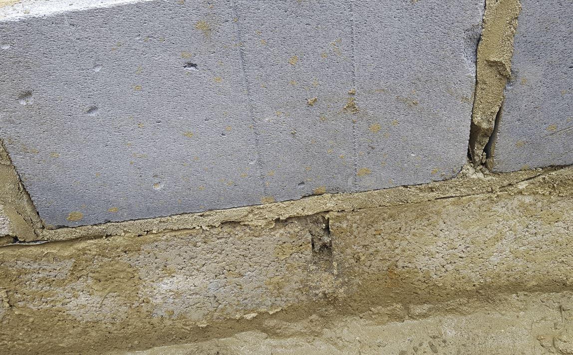

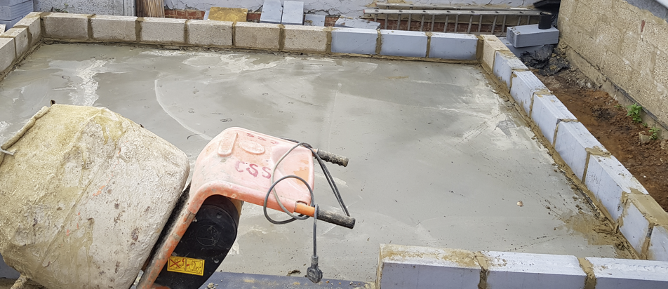

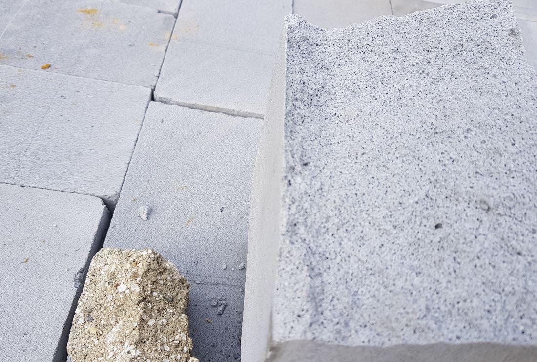

Janan Jai Posted October 4, 2023 Posted October 4, 2023 (edited) We are building a shed in our garden. Need this to last for 2 generations atleast. The one my neighbour built 40 years ago himself still stands good without any issues. Work started. Nice chaps working on it. But I am a little bit worried about the quality of materials being used. 2 different types of concrete blocks are being used (as you can see from the brick block colours). The dark coloured block appeared solid. They had small stones and i can feel the sand as well in it. These both are completely different from how it looks and how it feels and how it weighs. Is it ok to use 2 different blocks of completely different types, right ? Now all the new blocks which were delivered appears different and they seem very fragile. It appears they can be broken easily ? They dont look like real blocks. Not sure if the builder is cutting costs here ? When I looked for details from the delivery crate, this is what i found. The blocks are from H+H - Celcon Block - Standard Block 3.6N 440 SRC140. In the picture below, I have placed the other type of block which was used initially and it was solid and not as fragile as the new delivered ones. Can you all please check and advise ? Thanks Edited October 4, 2023 by Janan Jai
JohnMo Posted October 4, 2023 Posted October 4, 2023 You have a mix of concrete and aircrete blocks. What did your drawings state should be used?
ProDave Posted October 4, 2023 Posted October 4, 2023 You need to work out if your builder is deliberately trying to use the wrong blocks, or he doesn't know the difference.

ProDave Posted October 4, 2023 Posted October 4, 2023 The lightweight blocks would be more prone to water damage and splitting when frozen. What will be on the outside? I would want the high density blocks, apart from anything else easier to fix things like shelves to and bomb proof even if left bare. Whatever you do you certainly don't want't to mix them.
Mr Punter Posted October 4, 2023 Posted October 4, 2023 Concrete blocks or medium density aggregate blocks will be much better than Celcon.
Janan Jai Posted October 4, 2023 Author Posted October 4, 2023 7 minutes ago, ProDave said: The lightweight blocks would be more prone to water damage and splitting when frozen. What will be on the outside? I would want the high density blocks, apart from anything else easier to fix things like shelves to and bomb proof even if left bare. Whatever you do you certainly don't want't to mix them. Cement Rendering on the outside.
Big Jimbo Posted October 4, 2023 Posted October 4, 2023 It would imo be better built from the aggregate blocks. Stronger and no cracking. Probably cheaper than the Celcon blocks.
joe90 Posted October 4, 2023 Posted October 4, 2023 +1 to not using celcon blocks but if nothing was specified he is using whatever he can find (probably left over from another job).
