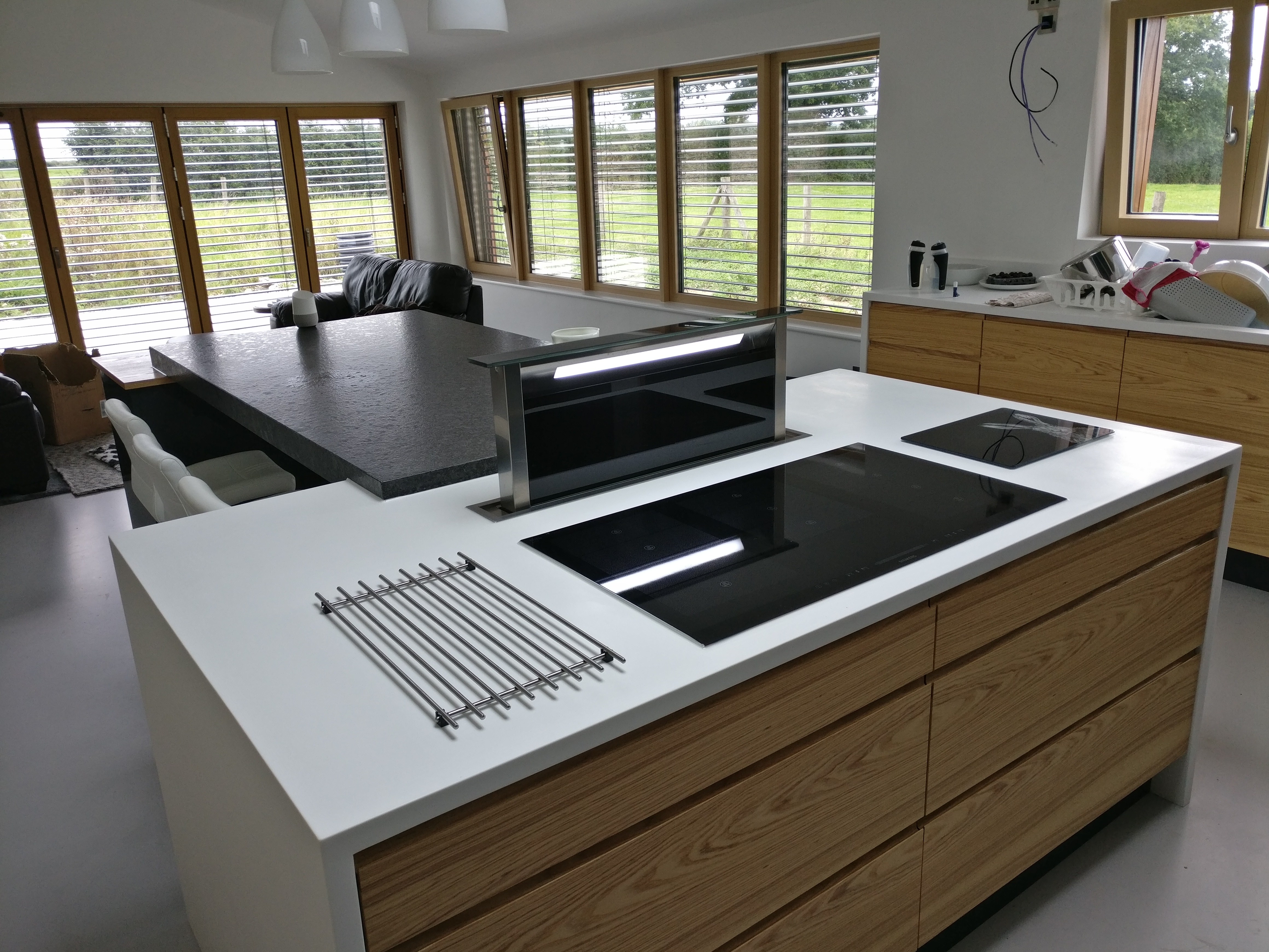

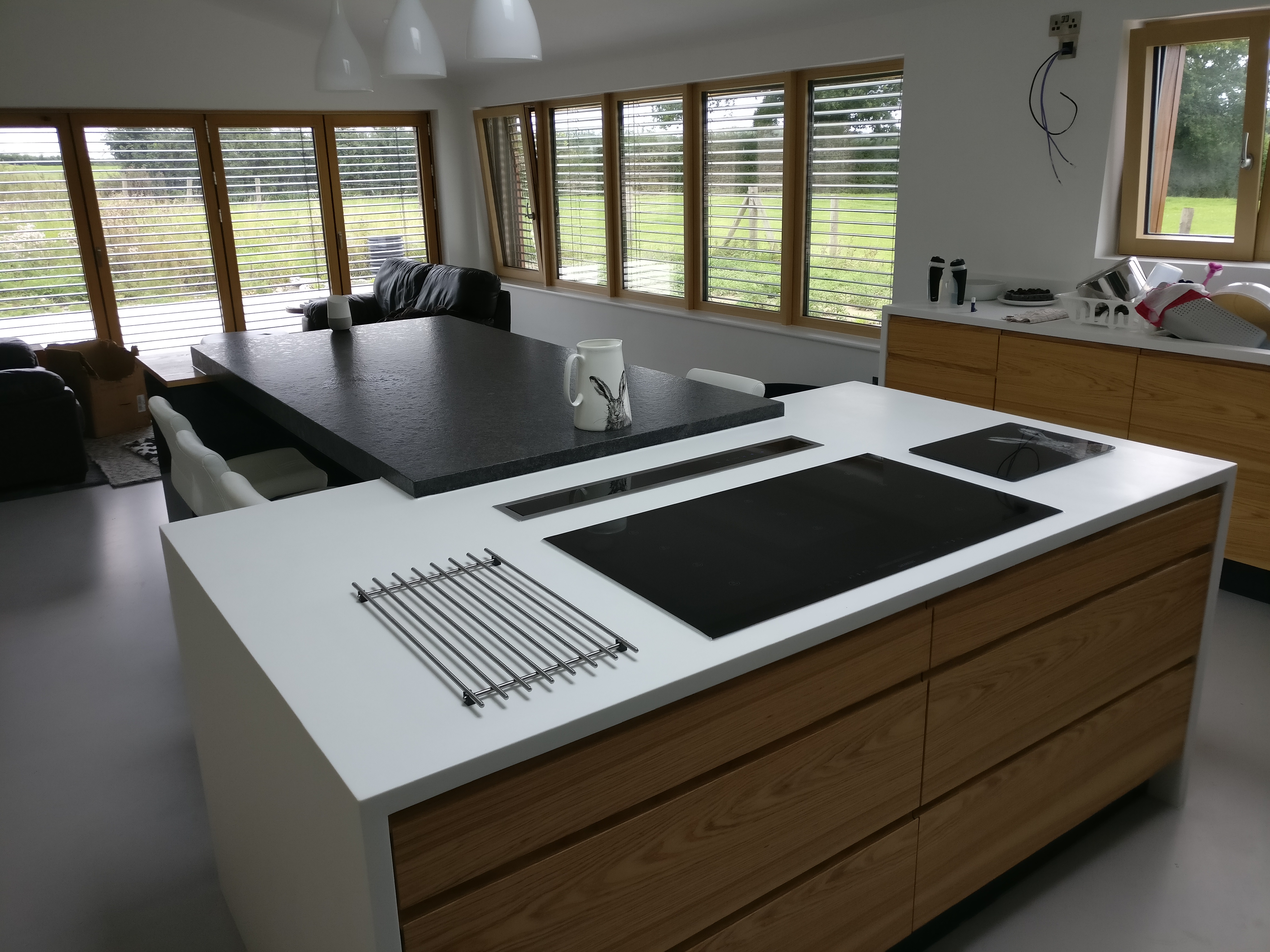

IanR Posted September 3, 2017 Share Posted September 3, 2017 We went with a downdraft, recirculation unit from Elica. Very powerful, but a conversation stopper on full chat. Thankfully you seldom need to run it on full speed. Exhausts through the kick board under the hob unit, which isn't noticeable. Added bonus is it puts a physical barrier between the young family at the breakfast bar and any hot pans on the hob. 2 Link to comment Share on other sites More sharing options...

stepheni Posted September 3, 2017 Author Share Posted September 3, 2017 amazing looking kitchen Ian. What about something like this on ebay for £569 http://www.ebay.co.uk/itm/Orion-T1-100cm-Stainless-Steel-Ceiling-Cooker-Hood-700m3-h-Motor-AUGUST-SALE/182698602731?_trkparms=aid%3D111001%26algo%3DREC.SEED%26ao%3D1%26asc%3D20131017132637%26meid%3D65998f82dd5a4c54b81d01344fd68f13%26pid%3D100033%26rk%3D3%26rkt%3D7%26mehot%3Dlo%26sd%3D152002824031&_trksid=p2045573.c100033.m2042 Link to comment Share on other sites More sharing options...

ultramods Posted October 9, 2017 Share Posted October 9, 2017 On 03/09/2017 at 12:31, Alphonsox said: Your pricing is well off - our Bora Basic was just under £2k for the recirculating induction hob version ( BIU version). This is in the same ball park as a decent induction hob and quality ceiling mount extractor. We have a two unit deep by three unit wide island with a 10 cm gap between the two rows of units into which the Bora fan exits. The exhaust then returns to the kitchen at floor level via a 10mm gap above the kick boards. Can you tell me where you bought your Bora from please as we were quoted £3200 for the Basic in June? Link to comment Share on other sites More sharing options...
Guest Alphonsox Posted October 9, 2017 Share Posted October 9, 2017 11 hours ago, ultramods said: Can you tell me where you bought your Bora from please as we were quoted £3200 for the Basic in June? We ordered ours at the Belfast Self Build Show at a "Special show price". The supplying company were Woodvale Interiors Campsie Industrial Estate, McLean Rd, Eglinton, Londonderry BT47 3XX 028 7181 0005 I cant find a link to a website for them so you'll probably need to phone. Link to comment Share on other sites More sharing options...
