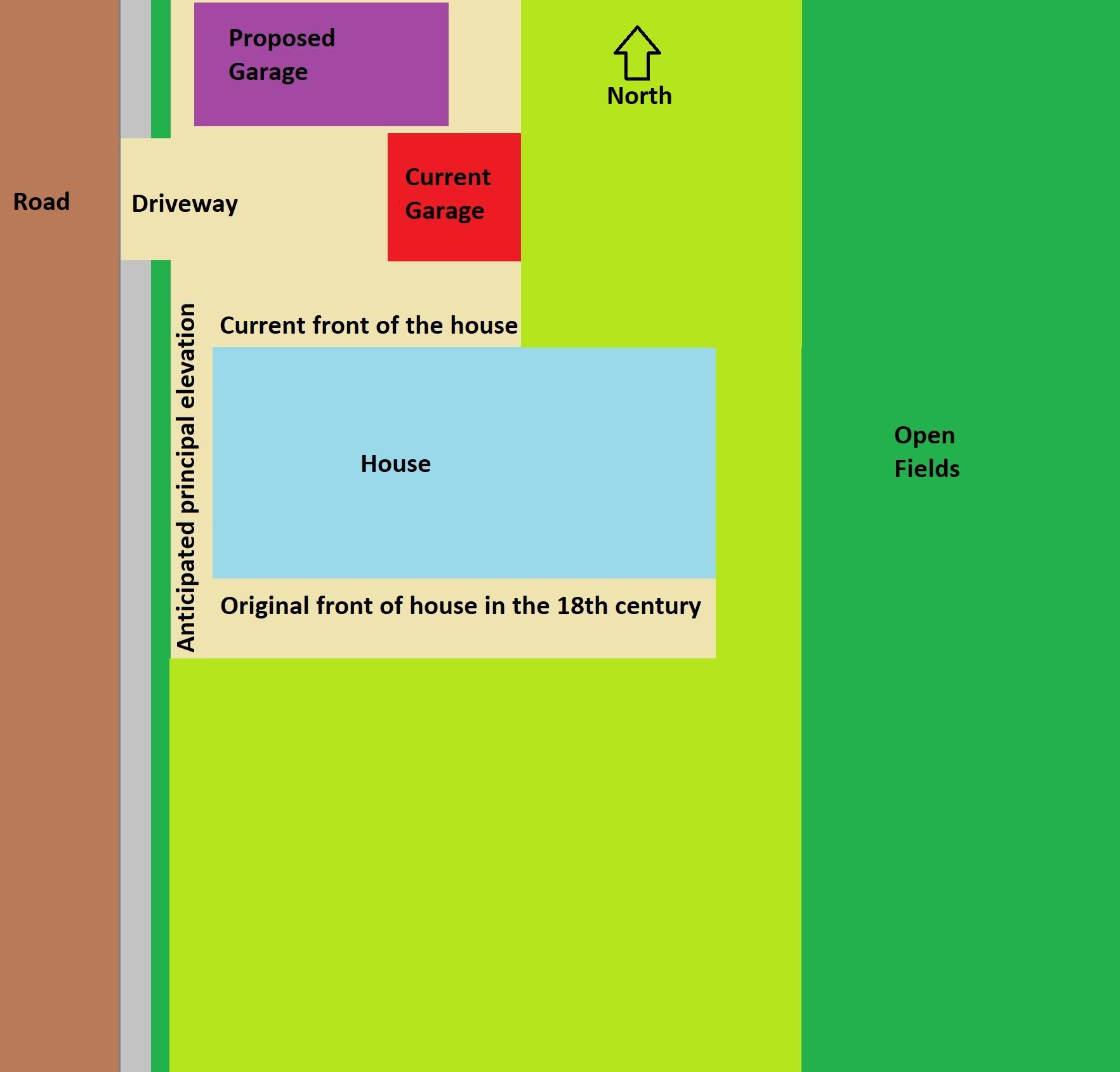

phykell Posted October 1, 2023 Posted October 1, 2023 Hi, I've just had an extension completed after a great deal of wrangling with the LPA and managed to achieve a slightly less than 50% increase in volume. I now want to demolish my existing garage and build a 50% larger version to the corner of my plot but the LPA has complained that it's disproportionate to the size of the one it's replacing and they're insisting I use timber for the doors/cladding - hardly ideal in terms of maintenance. I've attached a basic diagram which will hopefully illustrate the issues and my arguments are that: 1. The existing garage is disproportionate to the (extended) house. 2. It's in the middle of the front garden area and effectively obscures a view of open fields to the east - not great for greenbelt "openness". The LPA seems to disagree with this and would prefer me to keep the garage where it is - makes no sense to me at all. 3. The existing garage is too small for solar panels but the larger version would allow me to have up to 10 panels. Using the garage for a roof-integrated PV array is better than using the main (historic) house. 4. I should be able to build any size garage I want as long as it fits in with Permitted Development - the curtilage is huge so no problem there and the maximum roof/eaves height I want is fine plus there's no Article 4 directive in place - according to this article I should be fine but how does the conservation area affect this? https://urbanistarchitecture.co.uk/green-belt-permitted-development/ Can anyone offer any insight into how PD would work in my example? Would I have the option of just building a three-bay garage and forget about planning permission? Thanks
joe90 Posted October 1, 2023 Posted October 1, 2023 (edited) In your diagram the proposed garage is slightly forward of your principle house elevation (is this the case?) as not allowed under permitted development, other than that….I don’t see why you cannot build what you want. https://www.gov.uk/government/consultations/permitted-development-rights Edited October 1, 2023 by joe90

ProDave Posted October 1, 2023 Posted October 1, 2023 You say that is your "front" garden. The context is not clear in particular where are the neighbouring houses, where do they front to? Normally the elevation facing the road is the principle elevation, so that to me is a side garden. Where the building line lies depends to some extent on what neighbours there are. but if you move your garage just a little to the right so it is inline with the house wall that faces the road I would say it is okay. Won't that make it a tight turn into the garage or will a car never go in there?

phykell Posted October 2, 2023 Author Posted October 2, 2023 23 hours ago, joe90 said: In your diagram the proposed garage is slightly forward of your principle house elevation (is this the case?) as not allowed under permitted development, other than that….I don’t see why you cannot build what you want. https://www.gov.uk/government/consultations/permitted-development-rights Sorry about that - yes, it's supposed to be in line with the principal elevation. 21 hours ago, joe90 said: However….. Here’s the very surprising truth: permitted development rights for homeowners are exactly the same in the Green Belt as they are in your average suburb or town centre. 🤷♂️ so @phykell is it green belt or a conservation area ? It's definitely a conservation area and in the greenbelt. For the main property, I had to jump through all sorts of hoops, using reclaimed slates, specific bricks, specific types/materials for the windows, etc. I had to use flush sash UPVC windows in the original bit and aluminium in the new bit - you can't make this kind of nonsense up! The existing garage is a 1950s-70s style with rendered brick, a slate roof and steel up and over doors. For the new garage, they're insisting on reclaimed slate, timber doors/cladding and even cast iron rainwater goods - I think we'll be able to forego the latter though as the main property used a cast-iron effect aluminium. 1
phykell Posted October 2, 2023 Author Posted October 2, 2023 22 hours ago, ProDave said: You say that is your "front" garden. The context is not clear in particular where are the neighbouring houses, where do they front to? Normally the elevation facing the road is the principle elevation, so that to me is a side garden. Where the building line lies depends to some extent on what neighbours there are. but if you move your garage just a little to the right so it is inline with the house wall that faces the road I would say it is okay. Won't that make it a tight turn into the garage or will a car never go in there? Yes, there's one neighbour at the side - the garden to the south extends a long way to the end of the road. It's a block diagram and is far from accurate regarding the turn in to the garage. If PD does apply in this case, it worries me that the LPA didn't tell me I didn't need planning permission; further, I need not have paid out for bat surveys and arboricultural reports
DevilDamo Posted October 2, 2023 Posted October 2, 2023 Any outbuildings to the side of properties (which this would be) within a Conservation Area require Planning. 1

phykell Posted October 2, 2023 Author Posted October 2, 2023 23 minutes ago, DevilDamo said: Any outbuildings to the side of properties (which this would be) within a Conservation Area require Planning. Unfortunately, I have to concur: https://www.gov.uk/government/publications/permitted-development-rights-for-householders-technical-guidance E.3 In the case of any land within the curtilage of the dwellinghouse which is article 2(3) land, development is not permitted by Class E if any part of the building, enclosure, pool or container would be situated on land between a wall forming a side elevation of the dwellinghouse and the boundary of the curtilage of the dwellinghouse. It looks like I'll have to build it at the rear of the property if I want anything larger than the existing garage then but at least it can be via permitted development. The confusing issue is that it can be argued that the south elevation is the original front of the property and the north elevation is the "new" front of the property but I can't find any guidance on whether the roadside elevation, in this case, trumps the old/new fronts as the "principal elevation". 19 minutes ago, DevilDamo said: LPA’s amongst other things are there to protect the heritage of the conservation area. Surely you were aware of the site restrictions when you purchased the property? Or did the agents caveat any development options with “subject to Planning permission”? Count yourself lucky you’re not also dealing with a listed building. I knew there would be issues and went to huge effort, time and expense to renovate the main dwelling. Unfortunately, I then thought it would be OK to build a decent garage instead of the undersized, ugly, badly positioned one I have.
DevilDamo Posted October 3, 2023 Posted October 3, 2023 The principal elevation would be the elevation facing the road, i.e. the west. What’s stopping your from trying to secure Planning? You could use the floor area and volume of the existing as a trade off towards the new. Then providing the external materials are in keeping, then it should not be a massive issue. Or perhaps consider a carport? Are there any nearby trees to contend with?

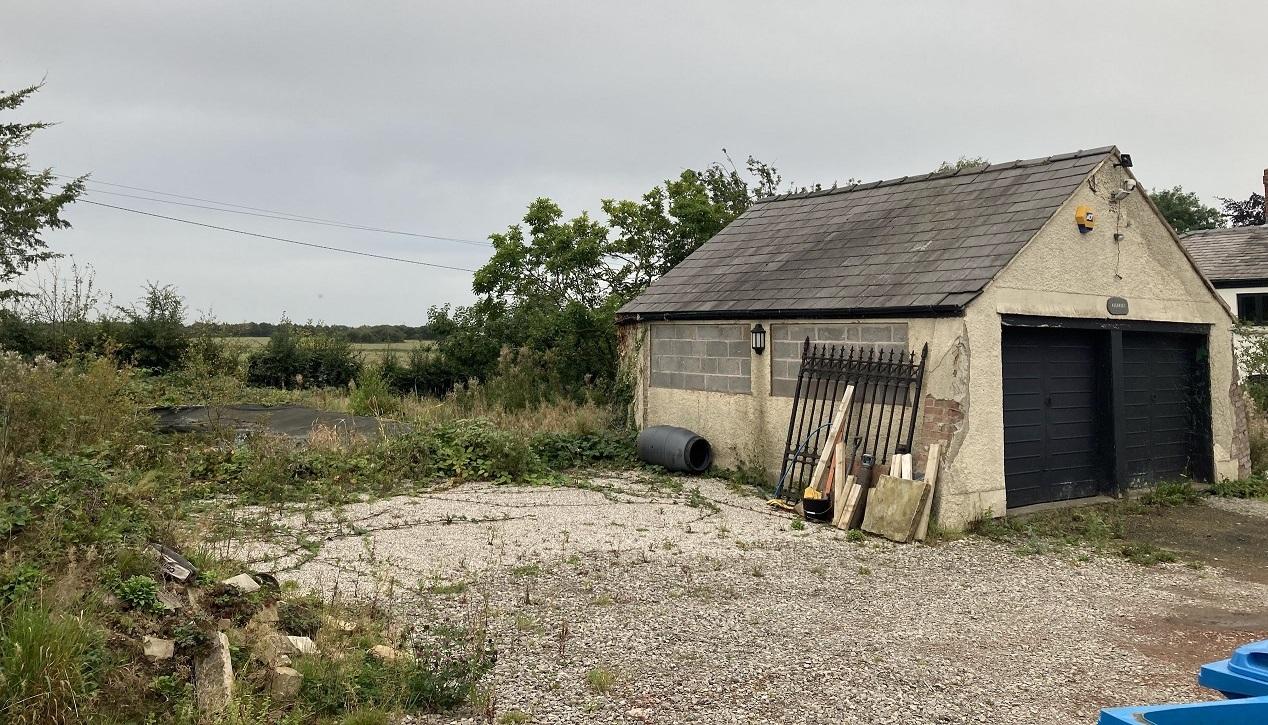

ProDave Posted October 3, 2023 Posted October 3, 2023 21 minutes ago, phykell said: Sadly, whilst I have submitted a planning application, they won't allow me to build anything bigger than the existing one and they've told me to move it well away from the road and reduce the height to less than the current garage so I'm getting even less than current have plus I doubt they'll let me build a carport or add any other outbuildings. For the record, there's a 7' hedge so you can't see much from the road and the "conservation area" itself isn't exactly the Cotswolds. There are no trees that are in scope. Then let them refuse it and appeal. My first house I wanted to build a garage (there was none) The planners wanted me to stick it tucked away behind the house taking up the best bit of the back garden, I wanted it alongside the house on a corner plot. Planners refused it, I appealed and won the appeal and the inspectors report praised the siting of the garage. 2
joe90 Posted October 3, 2023 Posted October 3, 2023 (edited) I second going to appeal, easier in my opinion than applying for planning and they are far more “practical “ IMO. Frankly with a current refusal it’s your only option and as you say the new one is far more appealing than the existing one. see if you can get a picture of what you propose, a picture is worth a thousand words (as they say). Edited October 3, 2023 by joe90 1
ProDave Posted October 3, 2023 Posted October 3, 2023 I would also add, that you should make it clear to your local planners that you believe your new garage will be a better replacement to the old one, and if it is refused by them you WILL appeal. 1
DevilDamo Posted October 3, 2023 Posted October 3, 2023 Do you “need” a triple garage? Can you not make do with a nicer designer double garage or carport that would therefore be a similar size and height as the existing? If you went for an open fronted garage, then you could achieve something like this. But note they would condition the approval that it could not be fully enclosed so you may want to include doors for the submission so you have option of having them or not.
joe90 Posted October 3, 2023 Posted October 3, 2023 (edited) 2 hours ago, phykell said: there's a 7' hedge so you can't see much from the road and the "conservation area" itself isn't exactly the Cotswolds. Include a photo of that 7’ hedge in your appeal to show that from the road little will be seen. Also point out that a well designed oak framed garage is less of an eyesore than vehicles parked on the drive 🤷♂️. Edited October 3, 2023 by joe90
