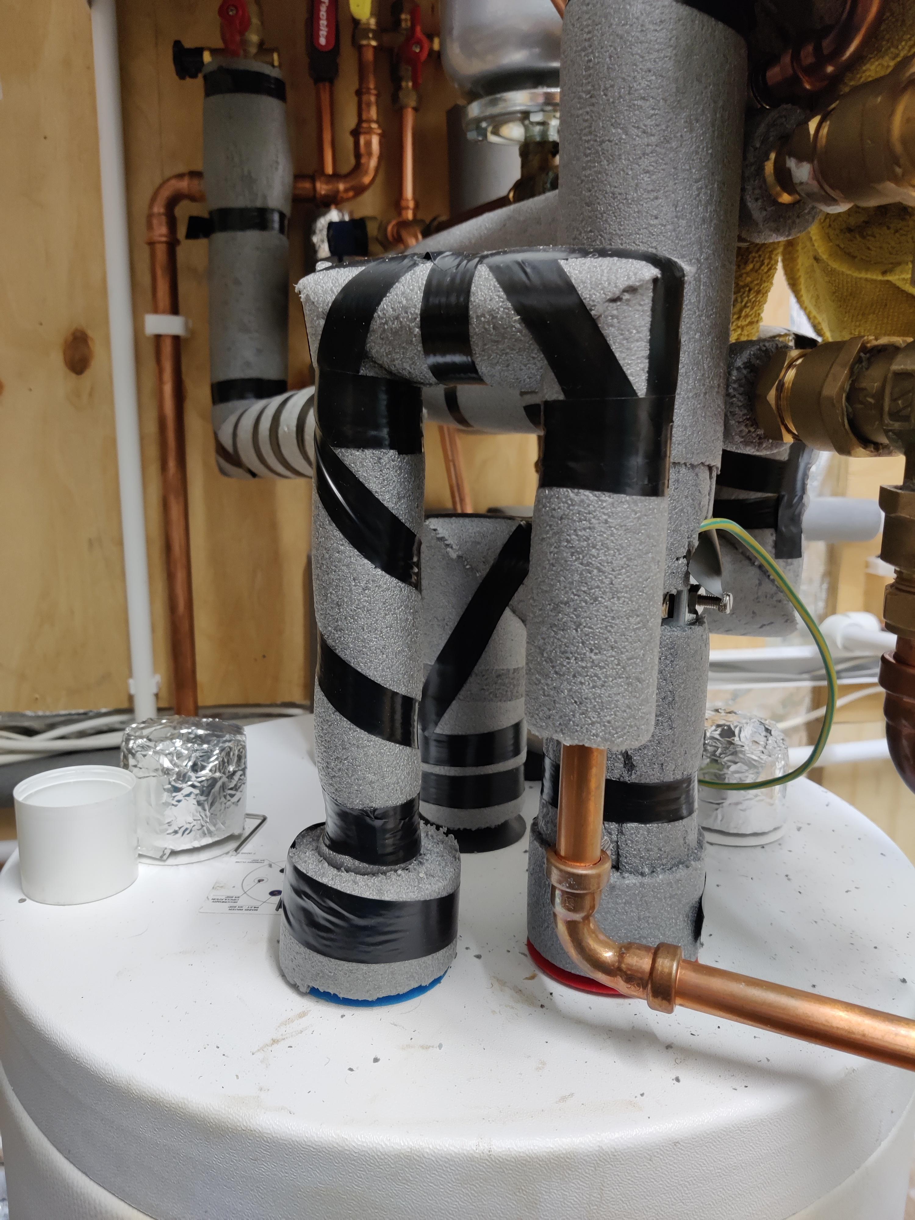

JohnMo Posted September 28, 2023 Posted September 28, 2023 2 hours ago, ReedRichards said: My feeling is that in the real world DHW cylinders lose a lot of heat by conduction down the connected pipes Would agree with that, I was looking for some info the other day and found some info on a USA site, and it reminded me you don't see many heat traps these days on cylinder installations.
sharpener Posted September 28, 2023 Posted September 28, 2023 How is it supposed to work? Doesn't prevent conduction. Might prevent parasitic convection currents. Also we would not allow a shut-off valve between tank and expansion vessel!
JohnMo Posted September 28, 2023 Posted September 28, 2023 2 hours ago, sharpener said: How is it supposed to work? Doesn't prevent conduction. Might prevent parasitic convection currents. Also we would not allow a shut-off valve between tank and expansion vessel! Basically hot water rises, due to density, it can only rise to the high point, the deliberate vertical fall arrests the heat rise. I tried it out on a temporary cylinder I have installed, its the cold water feed in to a DHW coil. At top of the cylinder the pipe exiting the cylinder is 46 degrees, while bottom of the insulation/vertical section to horizonal section is 23 degs.

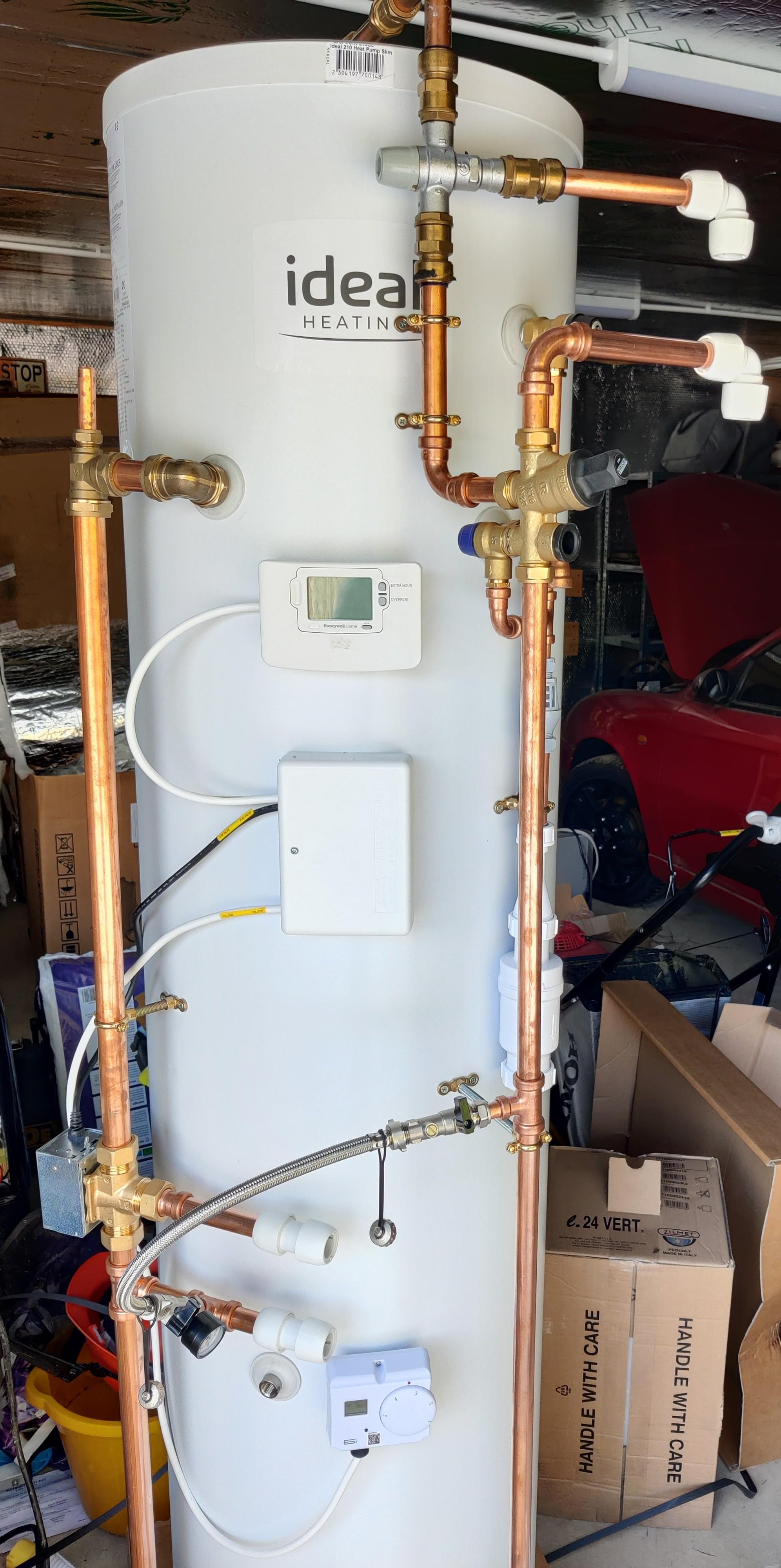

JohnMo Posted September 28, 2023 Posted September 28, 2023 1 minute ago, sharpener said: Tectite fittings, Two versions are available Sprint and classic. The sprint ones are single use. Only had one issue, where I tried to fit in a tight space, and got it miss aligned, had to cut the fitting off. Other than that, no issues. Have some classic fittings on the new cylinder, they come apart again, which can be useful. No leaks so far. I like them as the are a nice radius curve, instead of a tight bend. Cost would be an issue if you used loads of tectite, I.e. full time plumber and availablity can be iffy. My new cylinder, starting to be plumped up, incorporating a few Tectite fittings, but transitions to Hep2O after the copper.
sharpener Posted September 28, 2023 Posted September 28, 2023 29 minutes ago, JohnMo said: I like them as the are a nice radius curve, instead of a tight bend. Thanks. Didn't know about the Classic kind. Thinking of fitting my own upgrade rads for HP, Tectite Sprint look nice for that and as you say not constrictive unlike some cheap solder ring fittings e.g. Screwfix unbranded. Anyway am getting too old for lots of hot work (7 bigger rads will need min 28 elbows). Haven't tried the Hep2O but am a fan of Polyplumb, my rainwater system has quite a few as (unlike JG Speedfit) you can be confident they are done up but are easy to dismantle without tools e.g. to service the pump and controller. Nice looking job, I read somewhere that Ideal cylinders are in fact made by one of the major cyl mfrs but are nevertheless cheaper to buy from Ideal.
JohnMo Posted September 28, 2023 Posted September 28, 2023 1 hour ago, sharpener said: Ideal cylinders are in fact made by one of the major cyl mfrs Made by Gledhill, only differences between a Gledhill and Ideal Heat Pump cylinder is Ideal supply a 3 port diverter, and Gledhill a 2 port valve, the temperature thermostat is different. I changed mine to a digital dual thermostat for £15. Most heat pump installs will have a thermistor tied direct into the heat pump.
