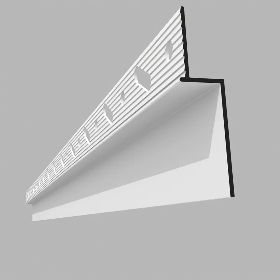

thefoxesmaltings Posted September 26, 2023 Share Posted September 26, 2023 We are laying an engineered wood floor in conjunction with a shadow gap trim. The shadow gap trim screws directly onto the plasterboard, lips back in and then down to form the detail. I understand that a expansion gap is needed around the entire perimeter of the engineered wood floor at approx 10mm. How would this typically work with a shadow gap detail like this? We have no skirting board to cover the expansion gap and the shadow gap trim is only a few mm thick. Certainly not 10mm, so if leave a 10mm expansion gap, we'd see a gap and raw edge of the engineered wood panel? Any advice or guidance on how to go about making this work? Shadow Gap Trim: Link to comment Share on other sites More sharing options...
TonyT Posted September 26, 2023 Share Posted September 26, 2023 Double sheet the plasterboard 1st layer hides the expansion gap 2 Link to comment Share on other sites More sharing options...
thefoxesmaltings Posted September 27, 2023 Author Share Posted September 27, 2023 8 hours ago, TonyT said: Double sheet the plasterboard 1st layer hides the expansion gap Ah got you. It's a bit too late for that now unfortunately. Are there any other solutions? Link to comment Share on other sites More sharing options...
ProDave Posted September 27, 2023 Share Posted September 27, 2023 Are the boards on battens (e.g service void) If so boards can go back further than the recess of the trim and the trim goes down onto the top of the floor board not behind it. Link to comment Share on other sites More sharing options...
