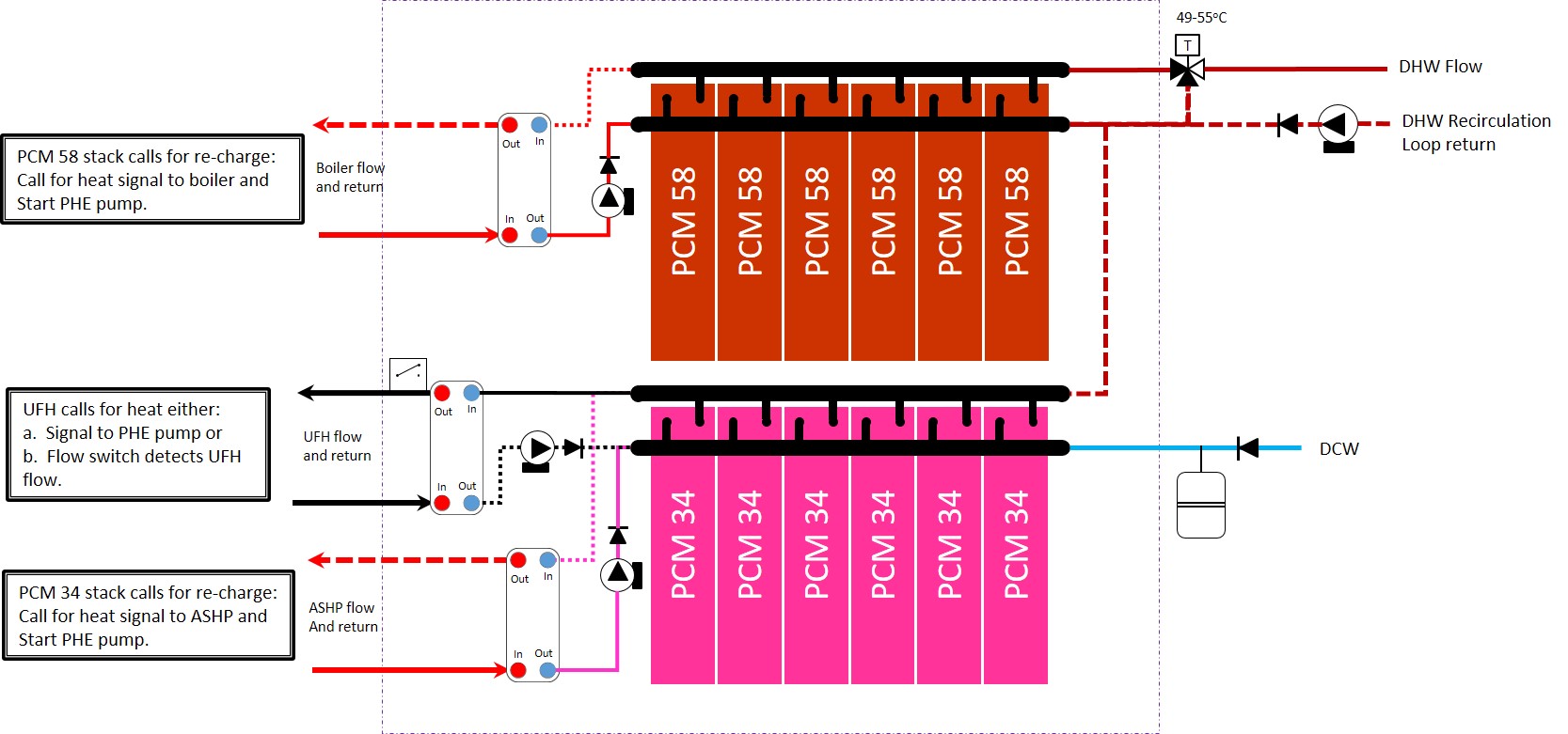

le-cerveau Posted September 3, 2017 Share Posted September 3, 2017 I am installing a SunAmp Stack, but a bespoke one with dual temperature cells: The Low temp cells will be charged from the ASHP whilst the high temp ones from the boiler (I have mains gas). This allows mem to take the best of the high CoP from the ASHP for both UFH and DHW pre heat, the High temp (normal) cells will provide the boost. This is for a 5½ bed house allowing for 3 concurrent 12 l/m showers, and the capacity for fill a stupidly large bath. The diagram is the latest from SunAmp, they are building it at the moment, final details will be known in the near future. Link to comment Share on other sites More sharing options...
Barney12 Posted September 3, 2017 Share Posted September 3, 2017 34 minutes ago, le-cerveau said: I am installing a SunAmp Stack, but a bespoke one with dual temperature cells: The Low temp cells will be charged from the ASHP whilst the high temp ones from the boiler (I have mains gas). This allows mem to take the best of the high CoP from the ASHP for both UFH and DHW pre heat, the High temp (normal) cells will provide the boost. This is for a 5½ bed house allowing for 3 concurrent 12 l/m showers, and the capacity for fill a stupidly large bath. The diagram is the latest from SunAmp, they are building it at the moment, final details will be known in the near future. Thats interesting. When I asked Sunamp if using as a heat source for UFH they said that it wasn't recommended? Perhaps though that's jus the case for the 'standard' units. Link to comment Share on other sites More sharing options...
Jeremy Harris Posted September 3, 2017 Share Posted September 3, 2017 (edited) 1 hour ago, Barney12 said: Thats interesting. When I asked Sunamp if using as a heat source for UFH they said that it wasn't recommended? Perhaps though that's jus the case for the 'standard' units. Yes, the standard cells use the PCM 58 material, which runs at around 58 deg C, the newer material is PCM 34, that runs at around 34 deg C, and is better suited to UFH. The Sunamp PV uses the PCM 58 material, AFAIK, hence the earlier comments about it not being best suited for use with UFH. One option that I may well consider in future is to replace our buffer tank with a Sunamp Stack fitted with PCM 34 cells. That would be charged via the ASHP and provide both DHW preheat and UFH buffering. The big advantage is that I could get around 3 times the thermal storage capacity in the existing space, which would be a very useful benefit. Edited September 3, 2017 by JSHarris 1 Link to comment Share on other sites More sharing options...

le-cerveau Posted September 4, 2017 Share Posted September 4, 2017 On 03/09/2017 at 12:56, JSHarris said: One option that I may well consider in future is to replace our buffer tank with a Sunamp Stack fitted with PCM 34 cells. The big issue is hydraulic separation between potable and non-potable water. My setup keeps the water in the cells potable and uses PHE's to charge and take out the UFH circuit, for your setup if you keep the cell as non-potable you only need one PHE for your DHW, but loose the instant slug of warmer water, otherwise you will need 2 x PHE, one for ASHP charging and one for UFH take off. Link to comment Share on other sites More sharing options...
Jeremy Harris Posted September 4, 2017 Share Posted September 4, 2017 15 minutes ago, le-cerveau said: The big issue is hydraulic separation between potable and non-potable water. My setup keeps the water in the cells potable and uses PHE's to charge and take out the UFH circuit, for your setup if you keep the cell as non-potable you only need one PHE for your DHW, but loose the instant slug of warmer water, otherwise you will need 2 x PHE, one for ASHP charging and one for UFH take off. My existing system uses a PHE upstairs, with the buffer downstairs, and the PHE is always pre-heated by thermosyphon action, so I would guess the same would be true if I just swapped the buffer tank out for a Sunamp Stack fitted with PCM 38 cells. Link to comment Share on other sites More sharing options...

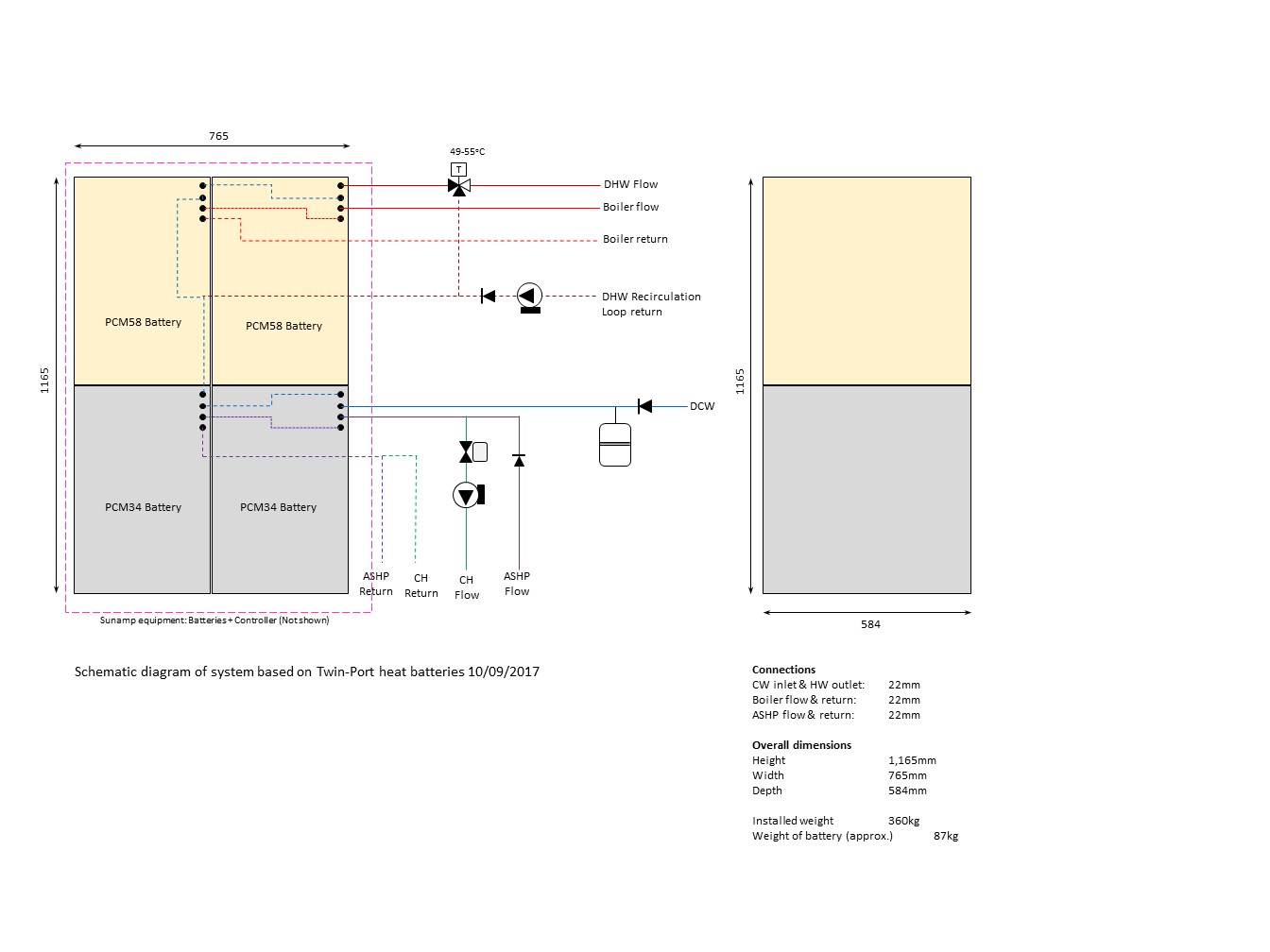

le-cerveau Posted September 13, 2017 Share Posted September 13, 2017 I have had an update from SunAmp who will now supply my equipment based on the new Dual Port (??) more when I know about it however here is the latest schematic. Link to comment Share on other sites More sharing options...
dogman Posted September 23, 2017 Share Posted September 23, 2017 @le-cerveau based on your posts i went back to Sunamp as I was going for two PV's. They sent me information on the new dual port but it will not be available till Q1 next year which is no good for me. Is your option the new Dual port or stack built to work like a the new dual port Link to comment Share on other sites More sharing options...
