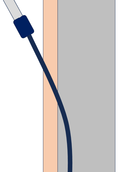

MortarThePoint Posted September 22, 2023 Author Posted September 22, 2023 27 minutes ago, Nickfromwales said: Do you mean how would I convert what’s ‘on display’ if the pipe is Hep and it’s that which is poking out, vs having been converted to copper? Is the Hep fixed or does it have play? Issue may be, gripping hold of the pipe to push a fitting on, but if you be Hep on display you’ll need a minimum of one Hep fitting to get you to copper. If you want / need to convert to copper that is? Pics? It's a more general question of when you have a Hep2O pipe that leads to a basin and is coming up from floor level. Do you: make the Hep2O visible out of the floor and do the vertical all on the wall surface keep the Hep2O in the wall and then exit at a shallow angle part way up and then connect to a flexi adapter swap to copper in the wall and exit the wall in copper Here is a rough diagram of option 2 with the blockwork in grey and plaster in pink. The Hep2O is dark blue and then it's connected to the flexi. Just plastering round the pipe would make it hard to have a nice finish and also risk damaging the pipe. It's a common thing to do with radiator pipe and I have seen a number of products for 10mm pipe but also found this: https://www.manthorpebp.co.uk/air-leakage/radiator-pipe-guides-and-seals-–-increased-thermal-efficiency/grs-duo-15-15mm-radiator

Nickfromwales Posted September 25, 2023 Posted September 25, 2023 In my GF bathroom I brought the pipes up in the footprint of the pedestal, so you can’t see any plumbing other than the waste pipe existing horizontally through the wall. On 22/09/2023 at 09:26, MortarThePoint said: make the Hep2O visible out of the floor and do the vertical all on the wall surface keep the Hep2O in the wall and then exit at a shallow angle part way up and then connect to a flexi adapter swap to copper in the wall and exit the wall in copper 1, best of the worst, but defo convert to copper and clip it. 2. not whilst I’ve a hole in my you-know-where 👎👎👎 3. #1 choice, using a Hep 90 in the wall to allow copper to be on show. Behind a radiator is where those plates get used, eg where they’ll never be seen and where there is no need to fill / sand / decorate around them. 1 1

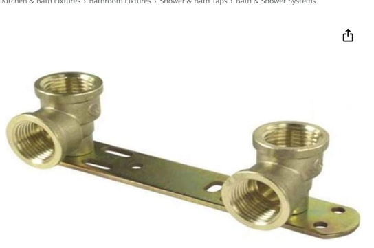

crispy_wafer Posted September 25, 2023 Posted September 25, 2023 Nice elegant solution! So one of these from your link. to one of these? (Grohe, others are available too!) 1
markocosic Posted September 25, 2023 Posted September 25, 2023 That looks like a 1/2" male tap > 10 mm soft copper connection (probably comes with a thread for a 3/8" tap connector, a flat faceish coupling, and a special adapter to take 10 mm copper pipe) for a bog. You also get them for 1/2">1'2", 1/2">3/4", or indeed dual outlet for a kitchen basin and dishwasher simultaneously. Usually start with a 1/2" elbow: https://online.depo-diy.lt/product/24002 Into a 10 mm compression or 3/8" thread: https://online.depo-diy.lt/product/25638 1/2" thread: https://online.depo-diy.lt/product/25639 3/4" thread: https://online.depo-diy.lt/product/25640 Or combo units for doing a dishwasher and a kitchen sink: https://online.depo-diy.lt/product/25630 https://www.senukai.lt/p/ventilis-schell-kampinis-skalbimo-masinai-3-8-colio-isorinis-sriegis-1-2-colio-isorinis-sriegis-10-mm-suverziamas/302d?mtd=search&pos=regular&src=searchnode It may be easier to use a shower fitting even for a basin etc: https://www.ebay.co.uk/itm/322273391778 And a couple of hep2o adapters: https://www.screwfix.com/p/hep2o-plastic-push-fit-adapting-male-coupler-15mm-x-1-2-/5970f As that gives you more meat to screw to the wall. At the expense of more joints. If anybody wants a 1/2" to 3/8" BLACK valve I have one on my desk that's yours for a donation to the forum. Pocketed and Ryanaired for a friend only to find he wanted 1/2" to 1/2" doh! https://online.depo-diy.lt/product/360380 1

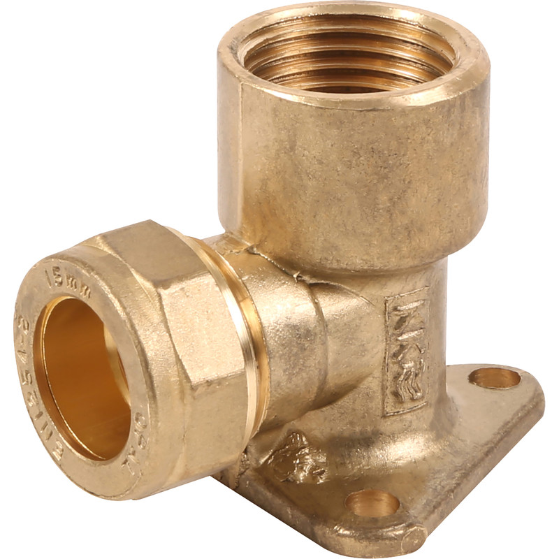

MortarThePoint Posted November 19, 2023 Author Posted November 19, 2023 Sadly Wavin don't appear to make the brass wallplate elbows any more, just the plastic ones which look rubbish. The only option left is 10mm(F) to 15mm(F) coupler with 15mm copper in and then a 15mm to 1/2" compression wallplate elbow. Heeding @Nickfromwales advice to avoid Hep2O into compression fittings.

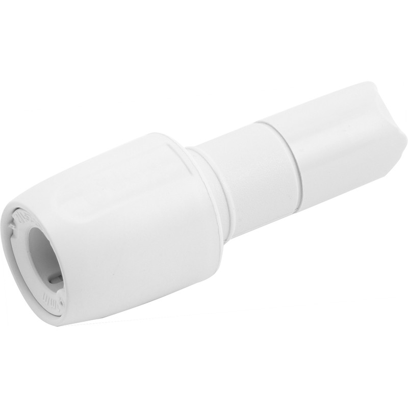

MortarThePoint Posted November 21, 2023 Author Posted November 21, 2023 (edited) @Nickfromwales I know you warn against mixing Hep2o pipe and compression fittings, but should I also avoid compression fittings on their spigots? I'm wondering about using the two parts below to replace the now discontinued brass wallplate elbow. I can't find 1/2 X 1/2 wallplate elbow to use the hep2o BSP adapter. Edited November 21, 2023 by MortarThePoint
