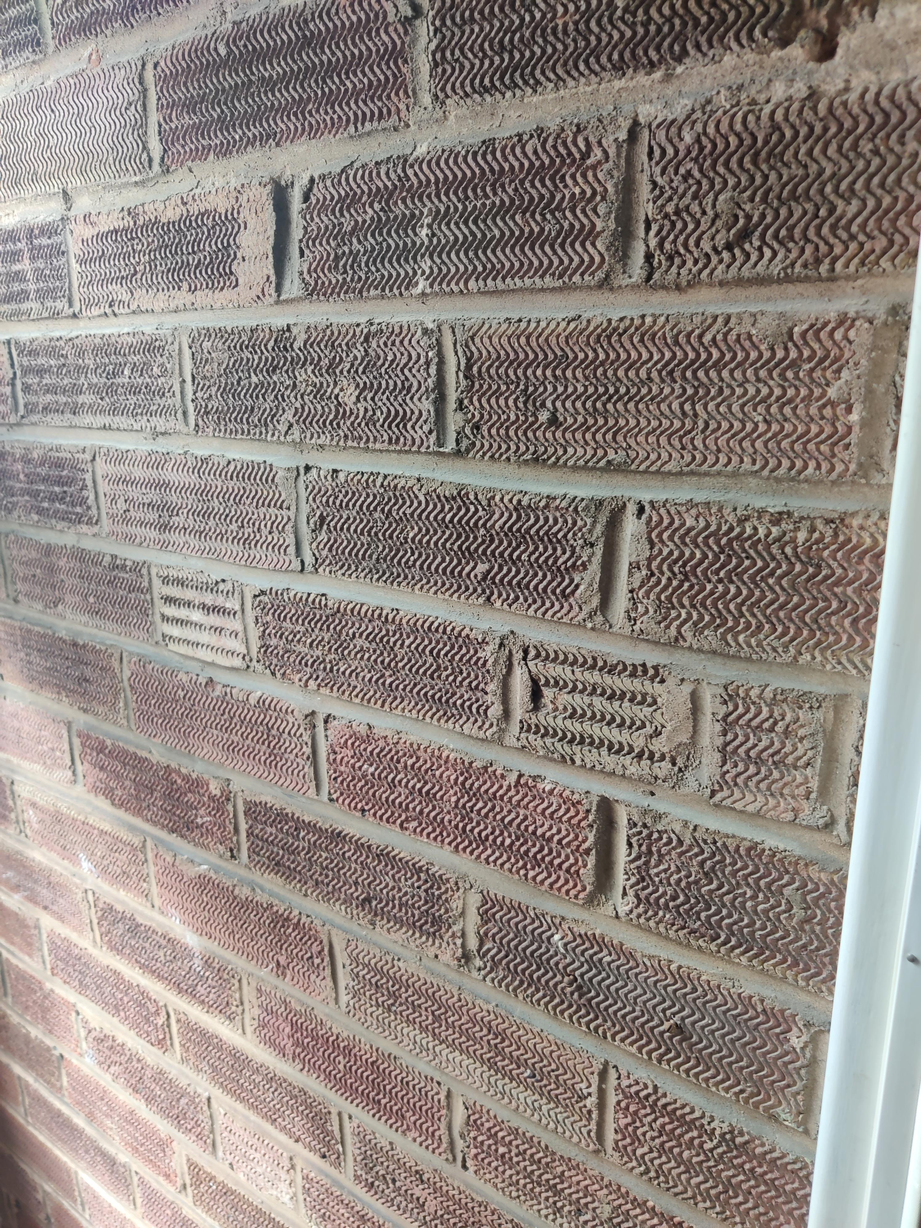

Marvin Posted September 24, 2023 Share Posted September 24, 2023 (edited) These Tudor bricks are the crap I am having to use... I have exactly the same problems... oh and bent ones! Edited September 24, 2023 by Marvin Link to comment Share on other sites More sharing options...
gaz_moose Posted September 24, 2023 Share Posted September 24, 2023 my whole housing estate is made from them its wild. loads are bent like bananas and loads are chipped but they obviously just laid them anyway and that was 40 years ago. Link to comment Share on other sites More sharing options...

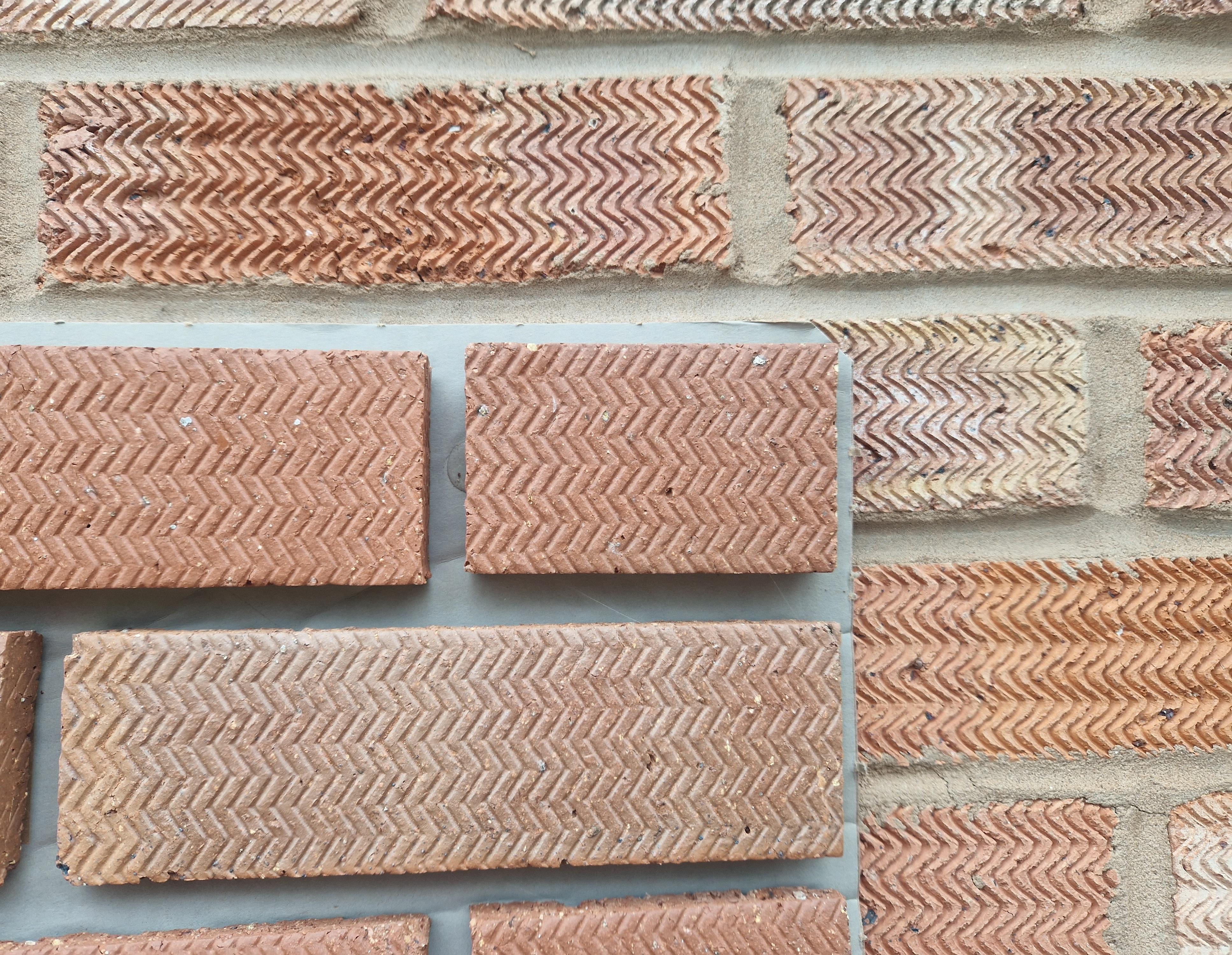

stu w Posted March 14 Share Posted March 14 They are a good brick , water absorption is good vs LBC , and as you say cheaper There is a like for like picture in good light . 1 Link to comment Share on other sites More sharing options...

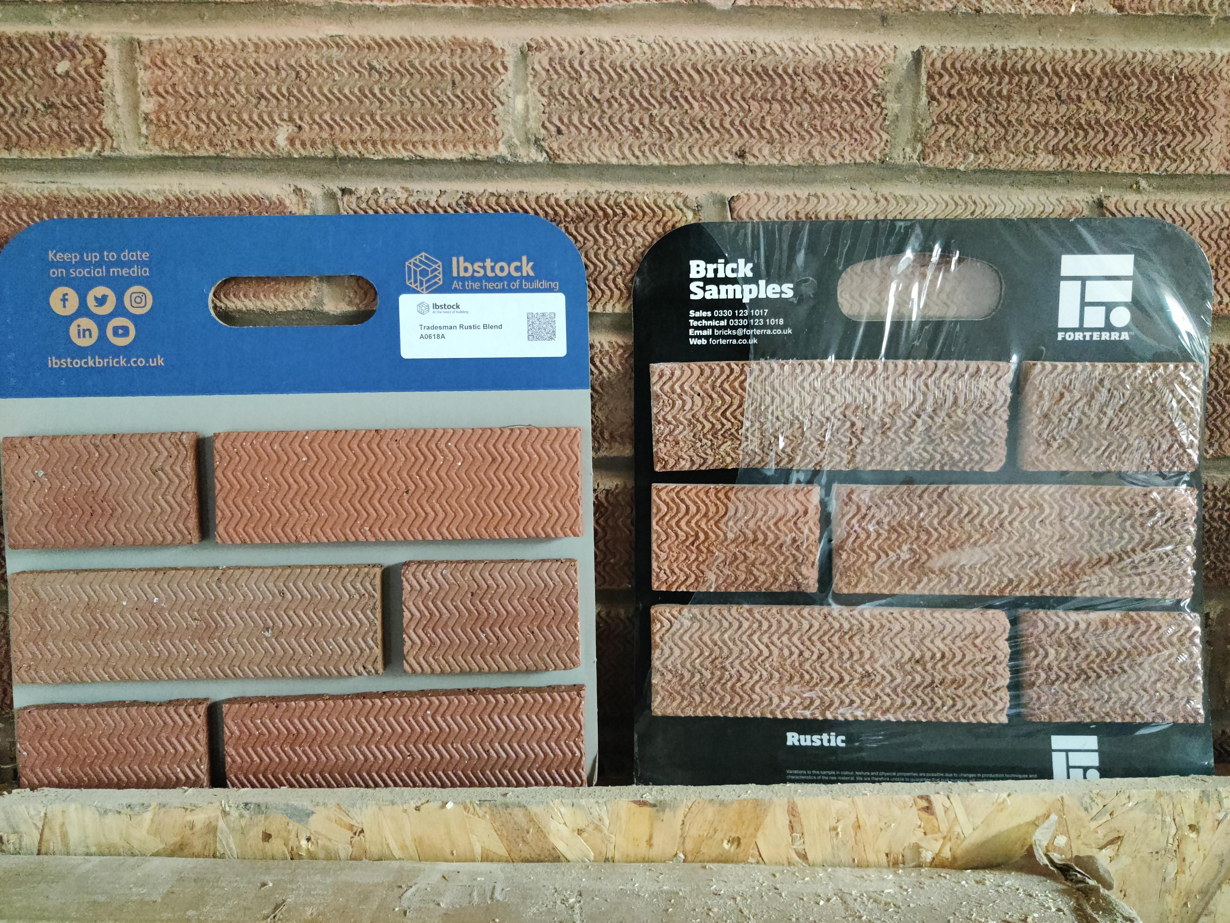

NandM Posted March 23 Share Posted March 23 I got my samples and am impressed with the quality. From your pic and my samples, you can see some wonky LBC bricks, whereas ibstock are uniform. The big question for me is if I could live with the slight difference on the front of the house, or chance my luck and try LBC just for the front. I'll definitely be getting the ibstock for the bulk of the extension. Link to comment Share on other sites More sharing options...
stu w Posted March 23 Share Posted March 23 2 hours ago, NandM said: I got my samples and am impressed with the quality. From your pic and my samples, you can see some wonky LBC bricks, whereas ibstock are uniform. The big question for me is if I could live with the slight difference on the front of the house, or chance my luck and try LBC just for the front. I'll definitely be getting the ibstock for the bulk of the extension. I found with an extension they are ok as don't catch your eye, if you are toothing they will stick out like a sore thumb. Good thing with the ibstock is very little waste , last time I used LBC around half were unusable Link to comment Share on other sites More sharing options...
NandM Posted March 23 Share Posted March 23 I don't think the brickie will be doing any toothing, it makes more sense just to have a wall starter...but I need to check with him. So much wastage for a more expensive brick (LBC) is concerning. Link to comment Share on other sites More sharing options...
