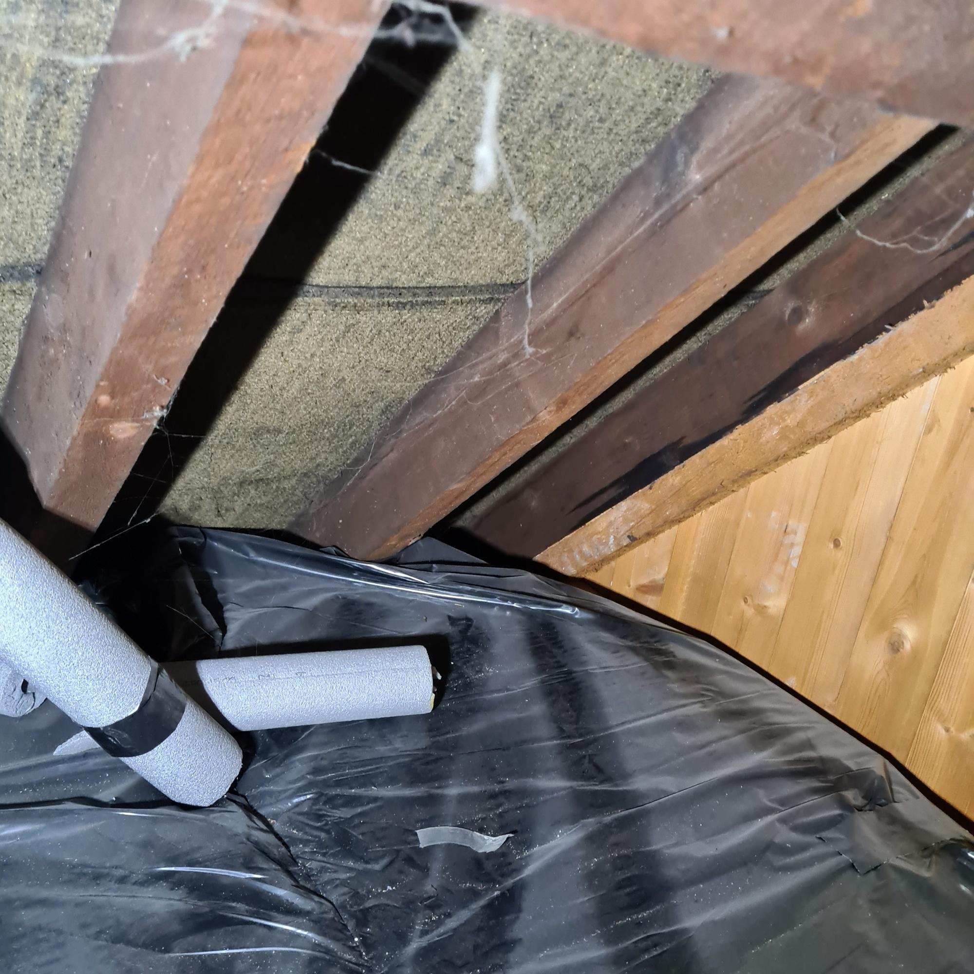

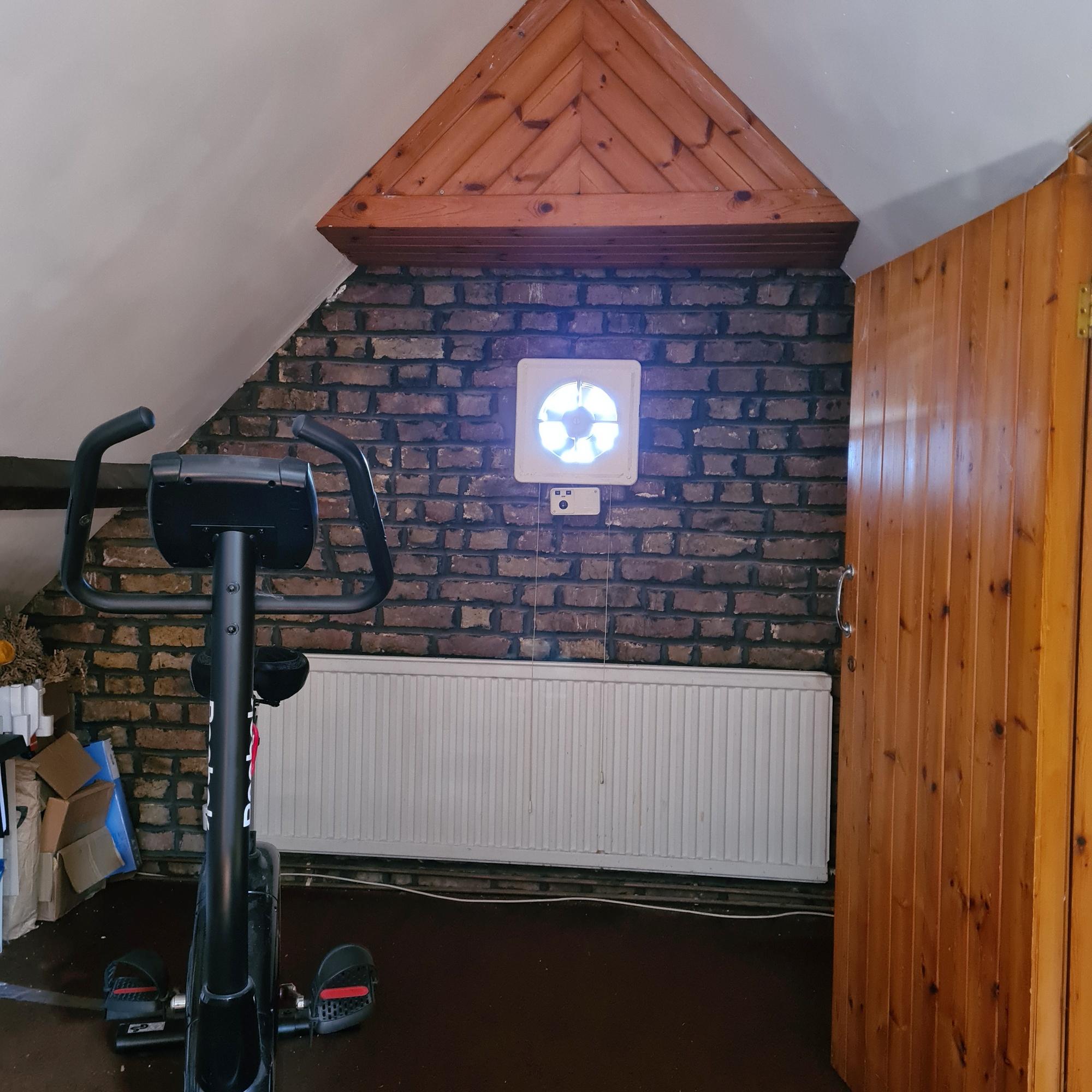

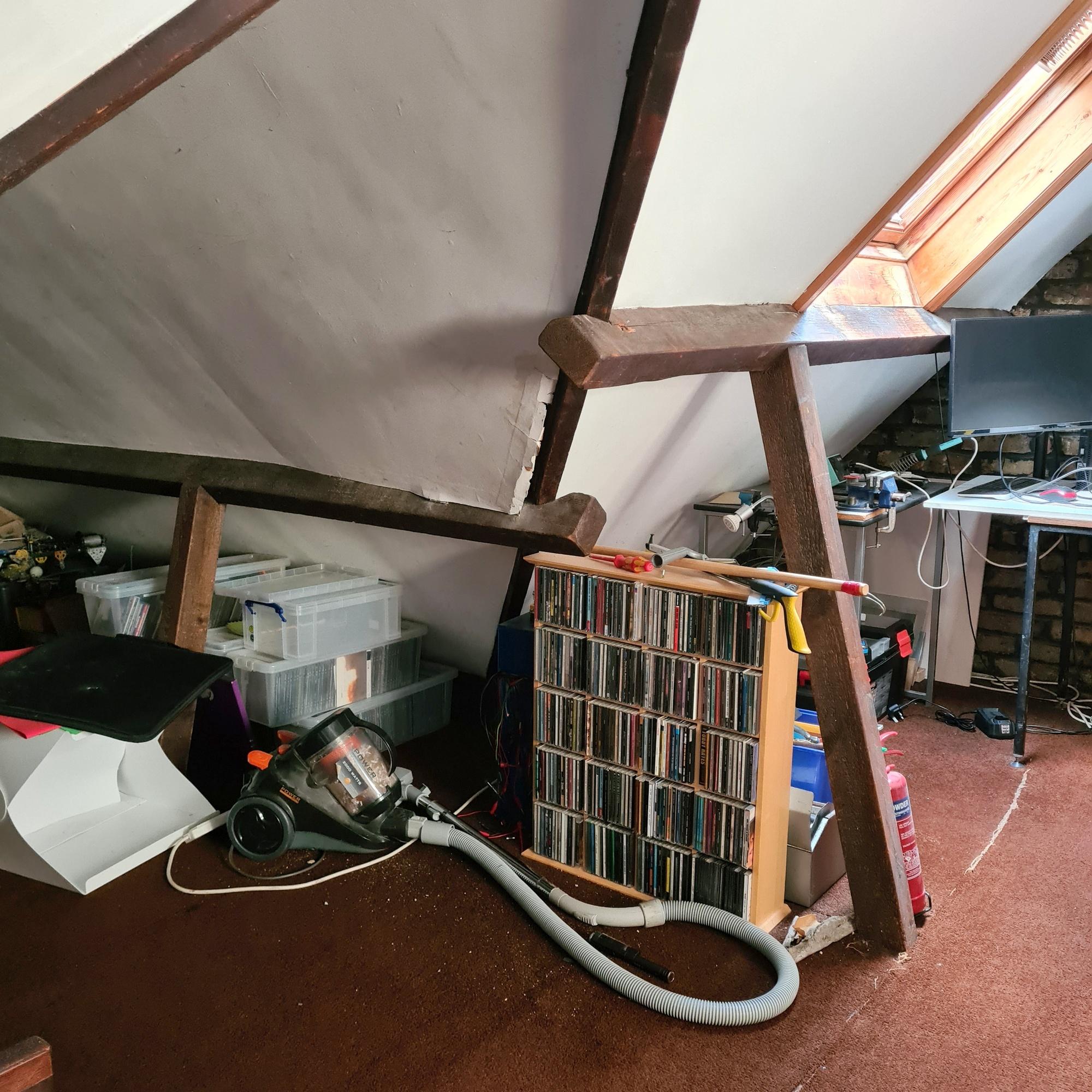

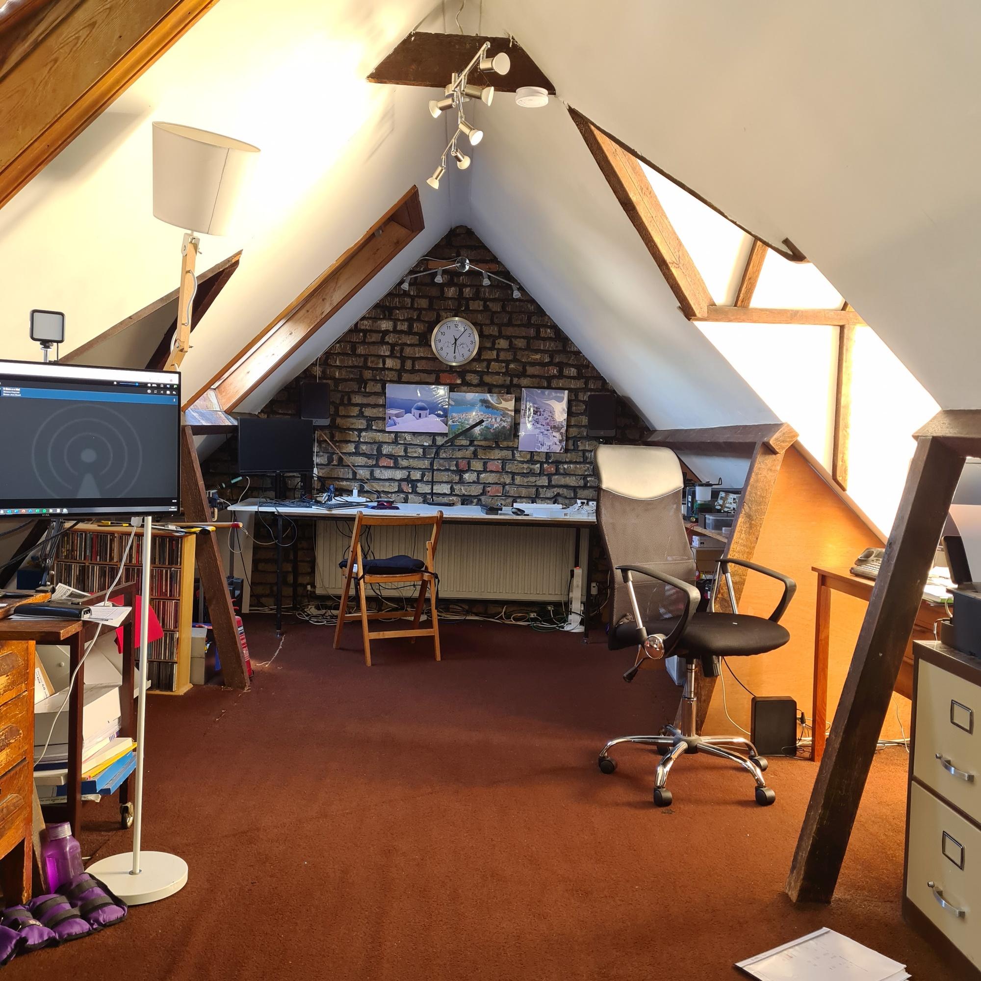

We've a Victorian detached house solid walls and double pitch roof in Kingston, Surrey. An energy analysis tells us that after the walls our roof is losing the most energy. We've a 2nd floor room conversion 'room in roof' which we use as an office .
It's very hot in summer and cold in winter. Entered by full staircase but without 2m head clearnance. Ther's no insulation in the roof between the slate tiles/mebrane and plasterboard. We'd like to make it more comfortable and lose less energy.

Option 1 - Provisional quotes to remove the existing plasterboard, fill the rafter gaps with PIR/Wood Fibre and then line with 50mm insulation are coming in at £15K to £25K (includes rad moving and electrics). This would include 50mm insulation between the rafters and say 50mm on top to cover the rafters. Total insulation 100mm say. We've also requested that we cover the 3 gable walls. Advantages of this approach, gives us 100mm of insulation overall, Disadvantages, potentially blows our complete budget with existing quotes. There's 100+ square meters of plasterboard to carefully remove and rafter gaps to fill. (this alone doesn't get us a fully compliant room as don't have 2m height on stair access).

Option 2 - cover the existing plaster board with say 60-75mm of wood fibre/PIR , and plaster over. (We'd still go with 100mm for the gable ends ) Screw/fix on top of the existing lining.  (Nothing to clear or dispose of less mess.)  The expectation is this would be much cheaper to carry out and leave monies say to do the PV and Curtains. My questions are simply (a) Is this approach a waste of time with no rafter insulation (b) will it provide useful energy reduction in view of the compromised approach ?

Agree with @ProDave that it won't, as you describe it, have been done under Bldg Regs. Agree that the 'joists' may be spindly, but until you have looked further I would not automatically say don't spend £15k insulating it. A significant percentage of the 19th Century terraces where I live (many  of which were built with attic rooms - and some which weren't) have approx 75 x 55 joists. Yes, things get a bit 'springy' if you push the stud walls further into the void, and I am not saying that a SE would be deliriously happy, but delve a bit first. In the terraced house example above there is a spine wall mid-way through the (?9m) depth of the house and stud walls which (albeit with too few nails) to some extent 'hang' the floor from the purlins reducing the front-to-back floor measurement to around 4m. If you can do the insulation work without significantly increasing the loads (and if there are no signs thus far of 'distress')then do consider it, after the aforementioned 'diligent investigation'.
What are the joist and rafter sections?
It's worth noting that although since 2010 common practice has been to put 50mm PIR between 75mm rafters leaving a 25mm vent path, the 'new' (and poorly-publicised) Gov't guidance (search room-in-roof best practice) suggests min 50mm vent gap, leaving you only 25mm of PIR. Of course we don't have dimensions but it looks like there's little room to spare. In your exploration I would include checking that cross-ventilation is not blocked at the ridge. Even with PIR it is highly unlikely you will achieve something 'Regs compliant' - that would need abt 150mm. Wood-fibre (undoubtedly 'nicer' in my view) would need nearly double that. Not much room left after that.

There are ways of stiffening rather than replacing joists. Doubling up, and/or fixing plywood above or below. Needs an SE, an interested one.
