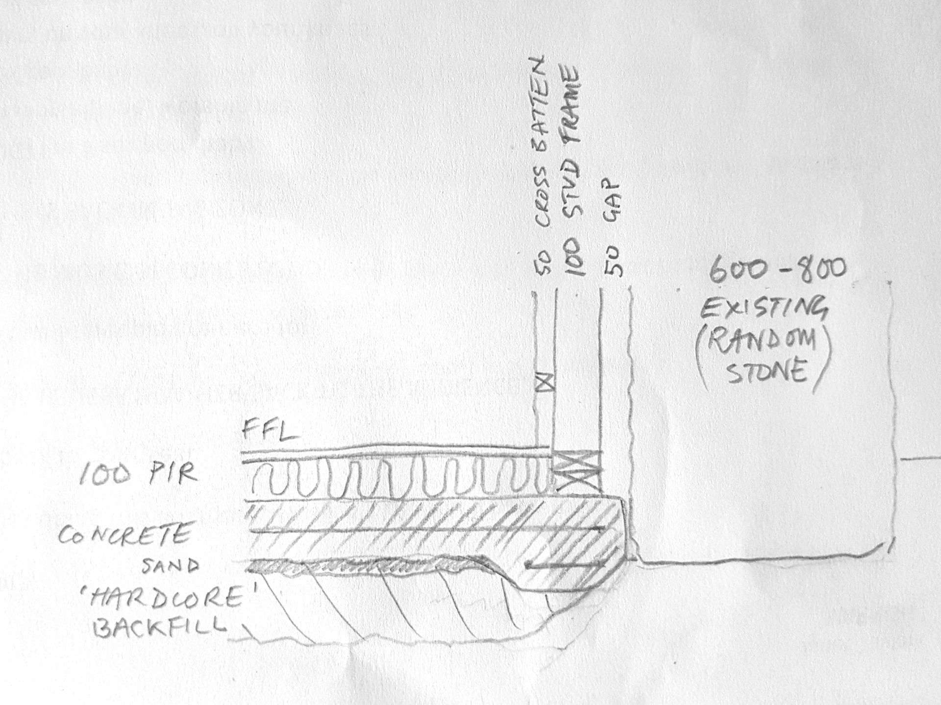

Hastings Posted September 17, 2023 Share Posted September 17, 2023 (edited) I have twice now put new insulated concrete floors into old buildings that have no founds to the walls and both times we had to dig below the level of where the old walls 'stopped'. With agreement from the structural engineer (who was initially prescribing underpinning) we stayed away from disturbing the solum under the old walls mainly by feathering/rounding the lower outer edges of the new inner slab/foundation. At the same time we also raised the new FFL (relative to the original) a little, which we worried about at the time would spoil the space but in practice we don't notice it now. The finished ground floor ceiling height is slightly less than 2.4m. Edited September 17, 2023 by Hastings Link to comment Share on other sites More sharing options...

Hastings Posted September 18, 2023 Share Posted September 18, 2023 (edited) We went airtight but weren't attempting PassivHaus level of insulation just current (2018) regs plus a bit more, where it was doable hence only 100mm underfloor insulation. The drawing shows roughly the average situation along 30m of existing 4 walls - but the sections where it was 'worse' were not long enough to worry about. It helped that the subsoil on which the old walls were built was gravel based (raised beach). The internal stud frame carries the weight of the new upper storey, hence the need for thickening of the slab at the perimeter. The engineer originally proposed that the new roof also rest on the new inner stud frame and that would have required even deeper digging and concrete. I vetoed that proposal in anticipation of the old walls being very shallow and I am very glad I did. The thickened reinforced concrete perimeter was wider than shown in my sketch. Sketch is not very to-scale. (Airtight and damp proof layers not shown, for clarity) Edited September 18, 2023 by Hastings Afterthought 2 Link to comment Share on other sites More sharing options...
mickeych Posted September 18, 2023 Author Share Posted September 18, 2023 OK got it. That looks and sounds remarkably similar to what we are discussing with the SE. The piece that we are struggling with at the moment is how far down we can dig as this dictates so much of the build. Do you remember just how far you dug down at the deepest point and what depth of concrete you maxed out at beneath the stud footings? We did start to discuss how the roof is supported but not sure that we ever agreed which route to take. Why did you veto your roof being suspended from the inner stud frame since you were building the concrete base anyway? Did you have to beef up the old walls to take the new roof structure? Our SE is excellent (very experienced with old barn refurbs) and has already made a lot of valuable contributions but I suspect that the levels or airtightness you have achieved are going to be pretty tough for us to achieve in a 250 year old agricultural building, but I have a desire to get as close to PH as possible. Link to comment Share on other sites More sharing options...
