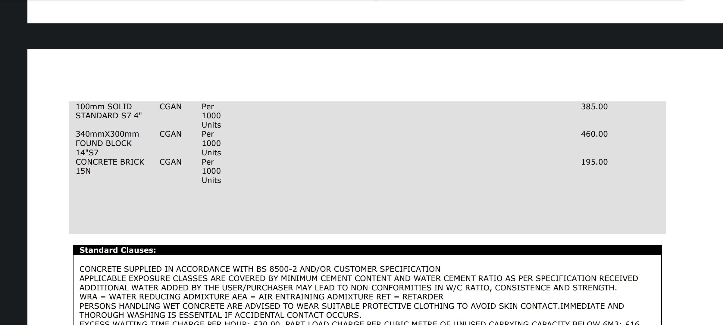

Conor Posted September 14, 2023 Share Posted September 14, 2023 (edited) Find a manufacturer and order direct. This is we got (back in early 2021). BMs were about 50p each at this time. Edited September 14, 2023 by Conor 1 Link to comment Share on other sites More sharing options...
