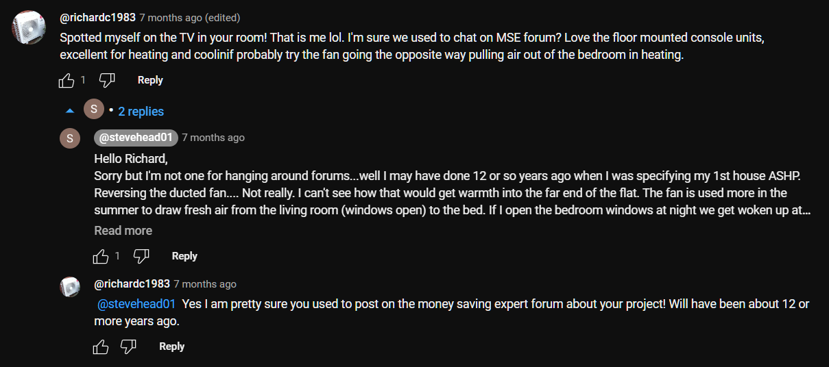

I had to laugh because I've watched the video he has in the background on the TV - and it's *extremely apparent* at one point where his concerns lie - that A2A is so simple, anyone might be able to do it 😱
