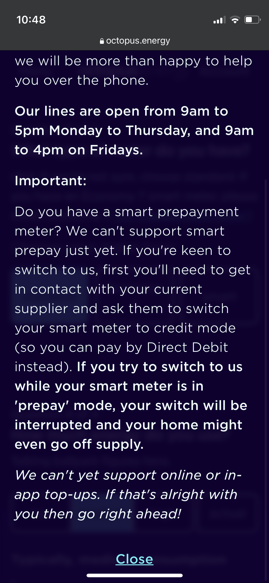

HughF Posted September 4, 2023 Author Posted September 4, 2023 (edited) 37 minutes ago, joth said: Any interest in ever using cheap overnight electricity like octopus Go? If so you want a nighttime boost rather than setback mode. Probably, but I need to get off prepayment with BG first, then start the long winded procedure of getting getting a smets2 installed and a new octopus tariff in my name. It will be used for ev charging though, I’ll probably need close to 30kWh/ day for my commute. Edited September 4, 2023 by HughF
JohnMo Posted September 4, 2023 Posted September 4, 2023 6 minutes ago, HughF said: long winded procedure of getting getting a smets2 installed I booked an appointment last week, they come on 26th September to install, so just under 4 weeks. 1
HughF Posted September 4, 2023 Author Posted September 4, 2023 1 hour ago, JohnMo said: That's ok for your rads, but not the UFH. To get a set-back you just need a simple thermostat with a timer. Basically reduce the target temp a couple of degrees at say a hour before you normally go to bed and set it back to the higher setting an hour or so before you get up. Depending on how long your house takes to cool will determine how long your heat pump stays off. Only thing to concider is your heating curve needs to take account of having to play catch-up to get the rooms back up to temp. So small set-backs are good. Or use your night setting which in effect do the same thing, but will leave the heat pump ticking over If you run WC, the moving a thermostat temp up will have zero effect on the heating, moving it down will. Planning a 2-3 degree setback… rads sized for 45 flow at -4 so we should be hovering around 38-40 on the WC at normal winter temps.
DanDee Posted September 4, 2023 Posted September 4, 2023 10 minutes ago, JohnMo said: I booked an appointment last week, they come on 26th September to install, so just under 4 weeks. 31th may I moved to Octopus through referral, 10th June I was able to book the appointment, received the confirmation for 16th June.
HughF Posted September 4, 2023 Author Posted September 4, 2023 Step 1. Get my wife to contact BG and move us to a credit account in my name… I suspect this will take ages to do and be impossible to get right.

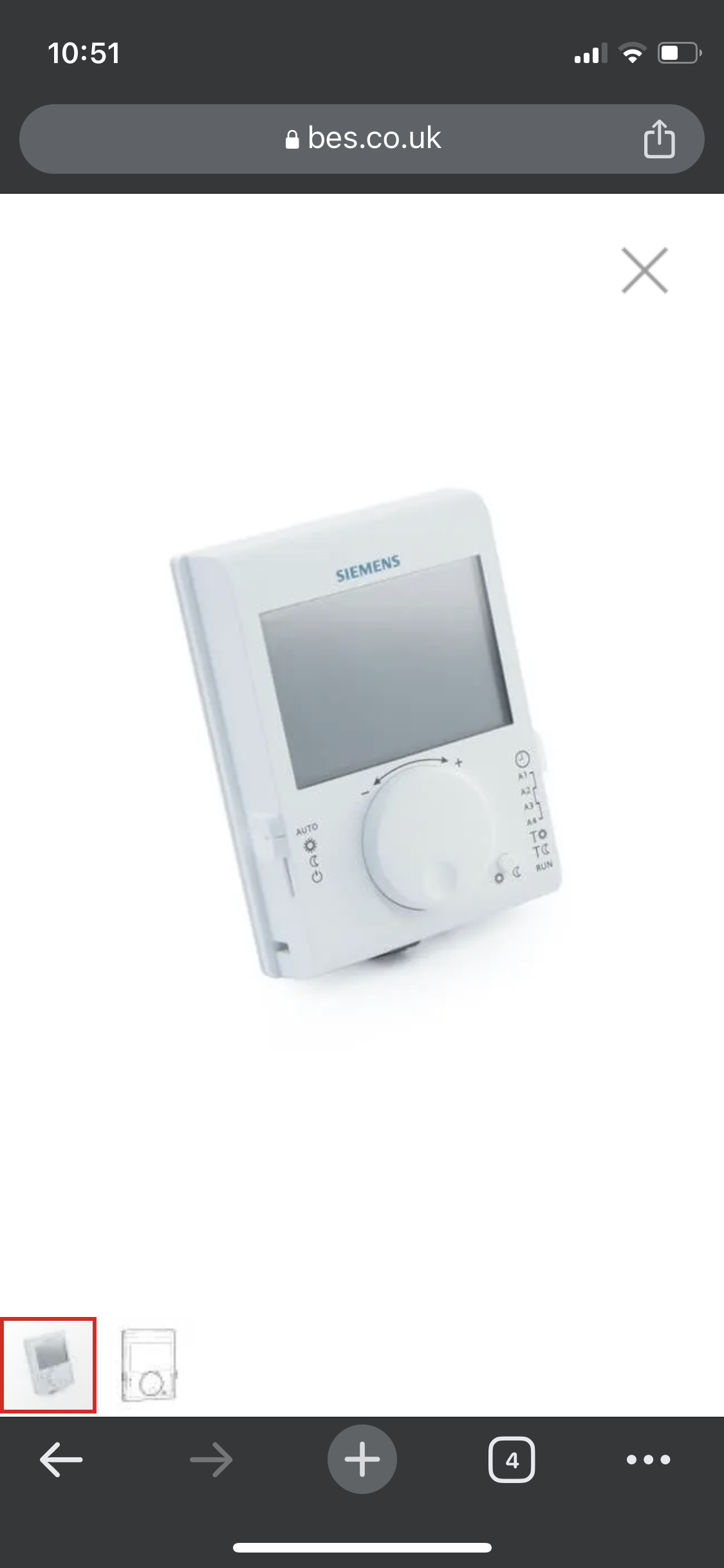

HughF Posted September 4, 2023 Author Posted September 4, 2023 (edited) Back to the thermostat choices, this one looks ideal. Has a nighttime mode with programmable times and setbacks, and a simple to use dial display. It’s either this, or a nest gen3 with the smart scheduling disabled. I suspect the nest will look nicer on the wall. Edited September 4, 2023 by HughF

HughF Posted September 4, 2023 Author Posted September 4, 2023 The more I look at this 'stat, the more I think it will be just the job. Datasheet attached, it has adjustable upper and lower limits (ideal, stops the wife turning it down to 10deg to turn the heating off, like she does at the moment. Stops sister-in-law turning it up to 25 thinking the place will heat up faster), and either on/off or PID control. And it's under £40... A6V10954415_Room temperature controller with 24-hour time swit_en.pdf
JamesPa Posted September 4, 2023 Posted September 4, 2023 1 hour ago, HughF said: The more I look at this 'stat, the more I think it will be just the job. Datasheet attached, it has adjustable upper and lower limits (ideal, stops the wife turning it down to 10deg to turn the heating off, like she does at the moment. Stops sister-in-law turning it up to 25 thinking the place will heat up faster), and either on/off or PID control. And it's under £40... A6V10954415_Room temperature controller with 24-hour time swit_en.pdf 750.04 kB · 0 downloads Just don't use it on PID control. That will mess with the heat pumps controller!

HughF Posted September 5, 2023 Author Posted September 5, 2023 6 hours ago, JoeBano said: I wouldn’t have a nest then the smart features can be a pain to turn off then randomly come back on. Yeah, I think I’ll stick with the Siemens.

HughF Posted September 5, 2023 Author Posted September 5, 2023 I must admit, they are pretty, and that outer ring is very satisfying to operate...
