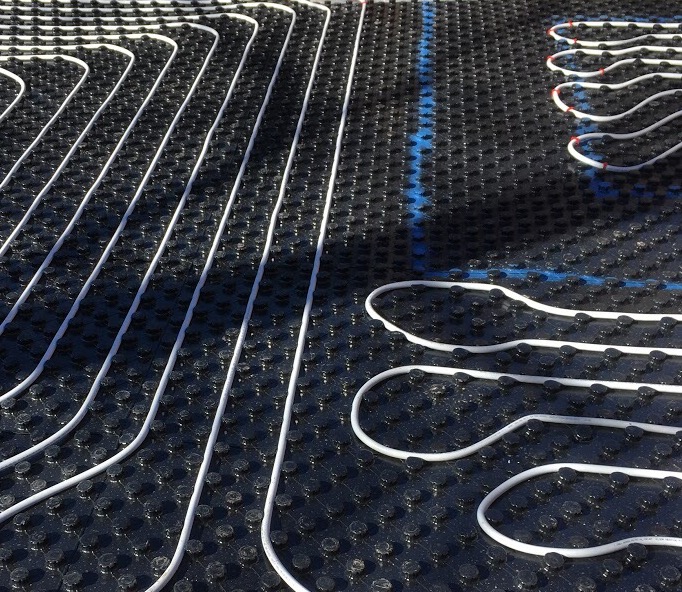

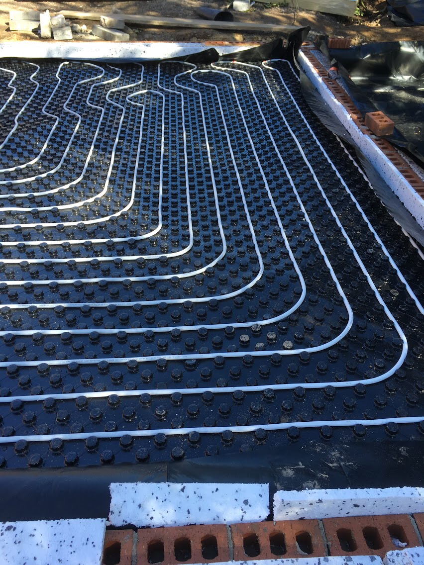

Polypipe trays as recommended to me by I think @PeterW way back and it's a piece of pi$$ and then some especially with a home made de-coiler:
20160101_143931
You do I think want a decent thickness of slab using them.

Heat rises, so as long as you've got at least 200mm of insulation then go for the trays as said. That'll lift the pipe slightly and make laying the pipe easy. It'll also absorb some of the volume of concrete required due to the castellations.
At 150mm I'd just add fibres.

Trays make life very easy - I laid 85 sqm in less than 2 days on my own. IMG_0730.thumb.JPG.920c2798a0a1361d1f6ee55b3e665e8f.JPG
Thats at 200mm spacing - had some fun with the dog bone ends but easy to do.
This was round the kitchen layout - means I know where I can and can't put screws in the floor ..!!
