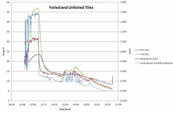

SteamyTea Posted August 26, 2017 Share Posted August 26, 2017 (edited) Is it worth trying out some aluminiumised mylar first, seem to remember that it is pretty cheap online. If you remember my old solar tile experiment over at the other place (several years ago now, April 2010), the old aluminiumised crisp packets worked well. http://www.greenbuildingforum.co.uk/newforum/comments.php?DiscussionID=5643&page=3&Focus=80703 Edited August 26, 2017 by SteamyTea Link to comment Share on other sites More sharing options...

Jeremy Harris Posted August 27, 2017 Author Share Posted August 27, 2017 9 hours ago, SteamyTea said: Is it worth trying out some aluminiumised mylar first, seem to remember that it is pretty cheap online. If you remember my old solar tile experiment over at the other place (several years ago now, April 2010), the old aluminiumised crisp packets worked well. http://www.greenbuildingforum.co.uk/newforum/comments.php?DiscussionID=5643&page=3&Focus=80703 That's a good idea. I've never been convinced that multiple reflective layers was much more than plain BS, as alumised mylar has both a very high long wavelength reflectivity and a very low emissivity. Rolls of reflective Mylar film are pretty cheap, and a quick look at the characteristics shows that a single layer will be around 95% as effective as multifoil in this application. Plus, being thinner it will be easier to roll up. In fact, looking at the physical properties, it's hard to see why, other than marketing BS, anyone contemplated stitching multiple reflective layers together. There is a direct parallel with a mirror - putting several mirrors, one behind the one in front, does not produce a better or brighter reflection. Link to comment Share on other sites More sharing options...
