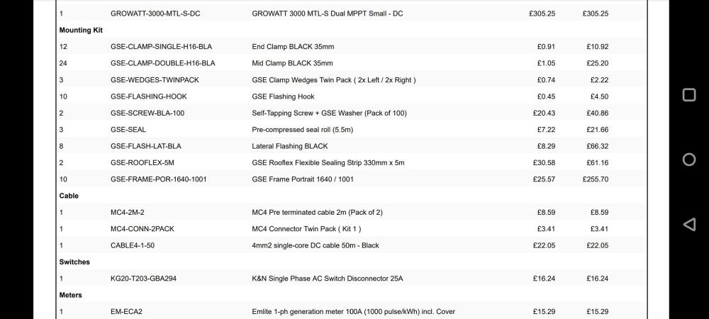

puntloos Posted August 29, 2023 Author Share Posted August 29, 2023 6 hours ago, JohnMo said: I bought my GSE trays from ITS, they were £25 each. I would double check your quantity of the sundry bits from GSE. £98 for each panel doesn't sound right. Here is my list of bits for 10 panels When was this quote/invoice done? Link to comment Share on other sites More sharing options...
JohnMo Posted August 29, 2023 Share Posted August 29, 2023 2 minutes ago, puntloos said: When was this quote/invoice done? 2020, so a while ago Link to comment Share on other sites More sharing options...

puntloos Posted August 29, 2023 Author Share Posted August 29, 2023 15 minutes ago, dpmiller said: Midsummer are still showing individual items Yep they're useful as a "list of quantities" but they are pretty expensive overall. Link to comment Share on other sites More sharing options...
dpmiller Posted August 29, 2023 Share Posted August 29, 2023 33 minutes ago, puntloos said: ep they're useful as a "list of quantities" but they are pretty expensive overall. so what does your £98/ panel include for GSE? Link to comment Share on other sites More sharing options...
puntloos Posted August 29, 2023 Author Share Posted August 29, 2023 55 minutes ago, dpmiller said: so what does your £98/ panel include for GSE? Kit includes: Mid Clamp BLACK H16 GSE Clamp Wedges Twin Pack ( 2x Left / 2x Right ) GSE Flashing Hook GSE Joint EDPM Pre Drilled Self-Tapping Screw + GSE Washer (Pack of 100) Pre-compressed seal roll (5.5m) Lateral Flashing - UNIVERSAL - 1290MM – BLACK NEW DPO GSE Rooflex Flexible Sealing Strip 330mm x 5m GSE Portrait Frame Link to comment Share on other sites More sharing options...
dpmiller Posted August 29, 2023 Share Posted August 29, 2023 Well that's not correct. You don't need 100 screws, 5.5m of foam strip or 5m of Rooflex for *each* panel But will you not need side flashings, regardless of using the Rooflex for top and bottom (if that's what you're doing)? We went with the proper top and side trims and Rooflex at the bottom... Link to comment Share on other sites More sharing options...
puntloos Posted August 29, 2023 Author Share Posted August 29, 2023 (edited) 43 minutes ago, dpmiller said: Well that's not correct. You don't need 100 screws, 5.5m of foam strip or 5m of Rooflex for *each* panel But will you not need side flashings, regardless of using the Rooflex for top and bottom (if that's what you're doing)? We went with the proper top and side trims and Rooflex at the bottom... Obviously I only copy/pasted from their own site - https://www.itstechnologies.shop/products/gse-in-roof-mounting-system-portrait - and the guy in question did add 23x this item. I think something screwy. is going on. I will certainly challenge them on this part, as JohnMo suggested, a more reasonable price per panel seems in the area of 50 quid (2 trays needed @ 22 GBP apparently) and then some screws, tape nuts and bolts. Did you design your system yourself? Edited August 29, 2023 by puntloos Link to comment Share on other sites More sharing options...
