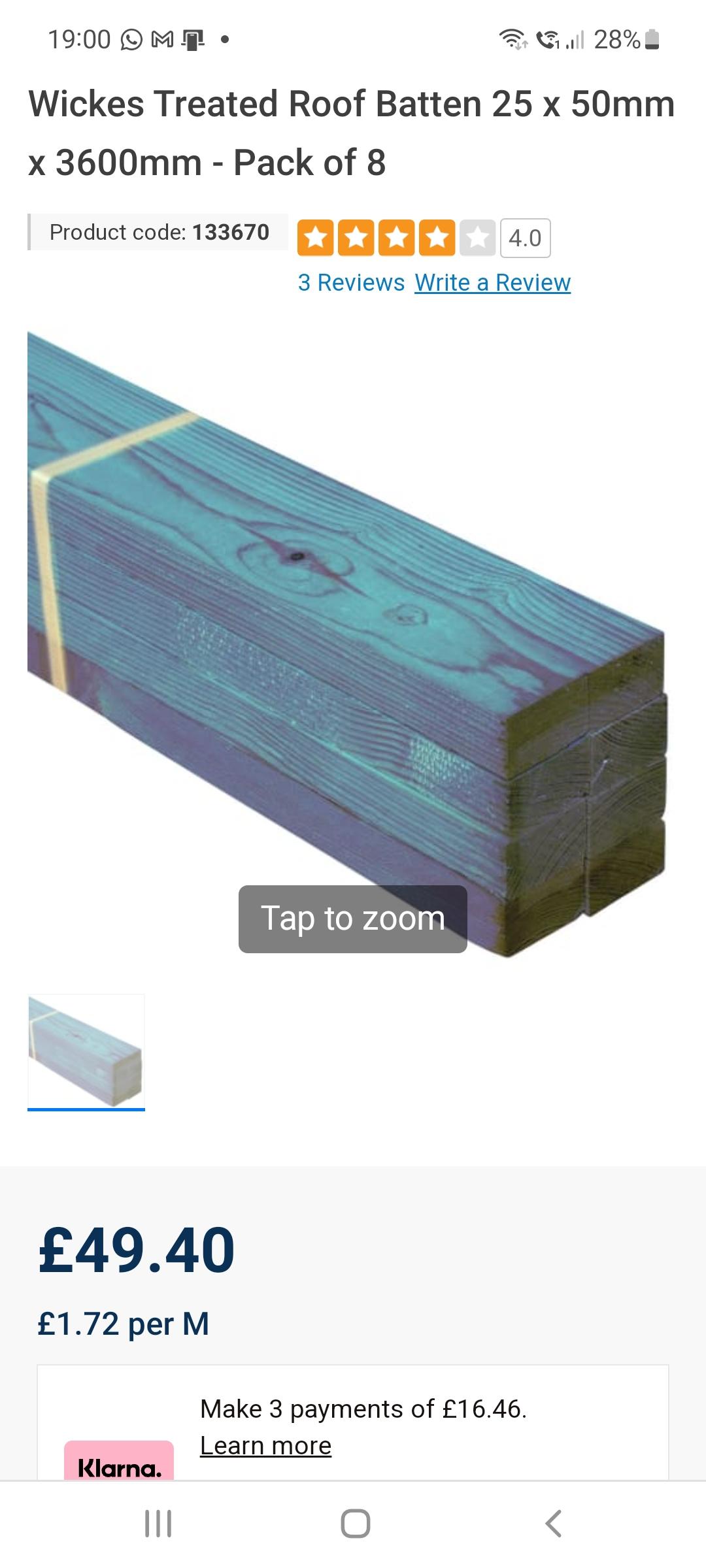

Dreadnaught Posted August 14, 2023 Share Posted August 14, 2023 I am currently doing my MF internal walls, GYPROC Metal C.Stud 70S50 (70mm). What have people used as the timber piece in the uprights. I tried Travis Perkin's C16 38mm x 63mm x 2.4m but it doesn't quite fit. Otherwise I can only find online treated battens of 50 x 25mm (i.e. roofing battens) or expensive PSE at 44 x 22.5 mm. What timber have others used in their doorways? @nod? Link to comment Share on other sites More sharing options...
Conor Posted August 14, 2023 Share Posted August 14, 2023 We used 25x50mm battens Link to comment Share on other sites More sharing options...
Dreadnaught Posted August 14, 2023 Author Share Posted August 14, 2023 7 minutes ago, Conor said: We used 25x50mm battens Thanks @Conor. The fact that they are treated and you are using them inside your dwelling isn't a concern? Link to comment Share on other sites More sharing options...

saveasteading Posted August 14, 2023 Share Posted August 14, 2023 2 hours ago, Dreadnaught said: using them inside your dwelling isn't a concern Only a concern if you are a woodworm moth looking for nice new timber. As long as it isnt still wet from the treatment process it is fine to use. Why online? This should be available at bm, and diy stores. You can then ensure it is a decent quality for knots and straightness. Link to comment Share on other sites More sharing options...
nod Posted August 14, 2023 Share Posted August 14, 2023 Battens are to thin You can buy door Timbers that are cut to width Push them in then tap them against a solid wall I normally by them by the pack with the metal But they will sell individually Just count your doors up Sold in 2.4 lengths Link to comment Share on other sites More sharing options...
