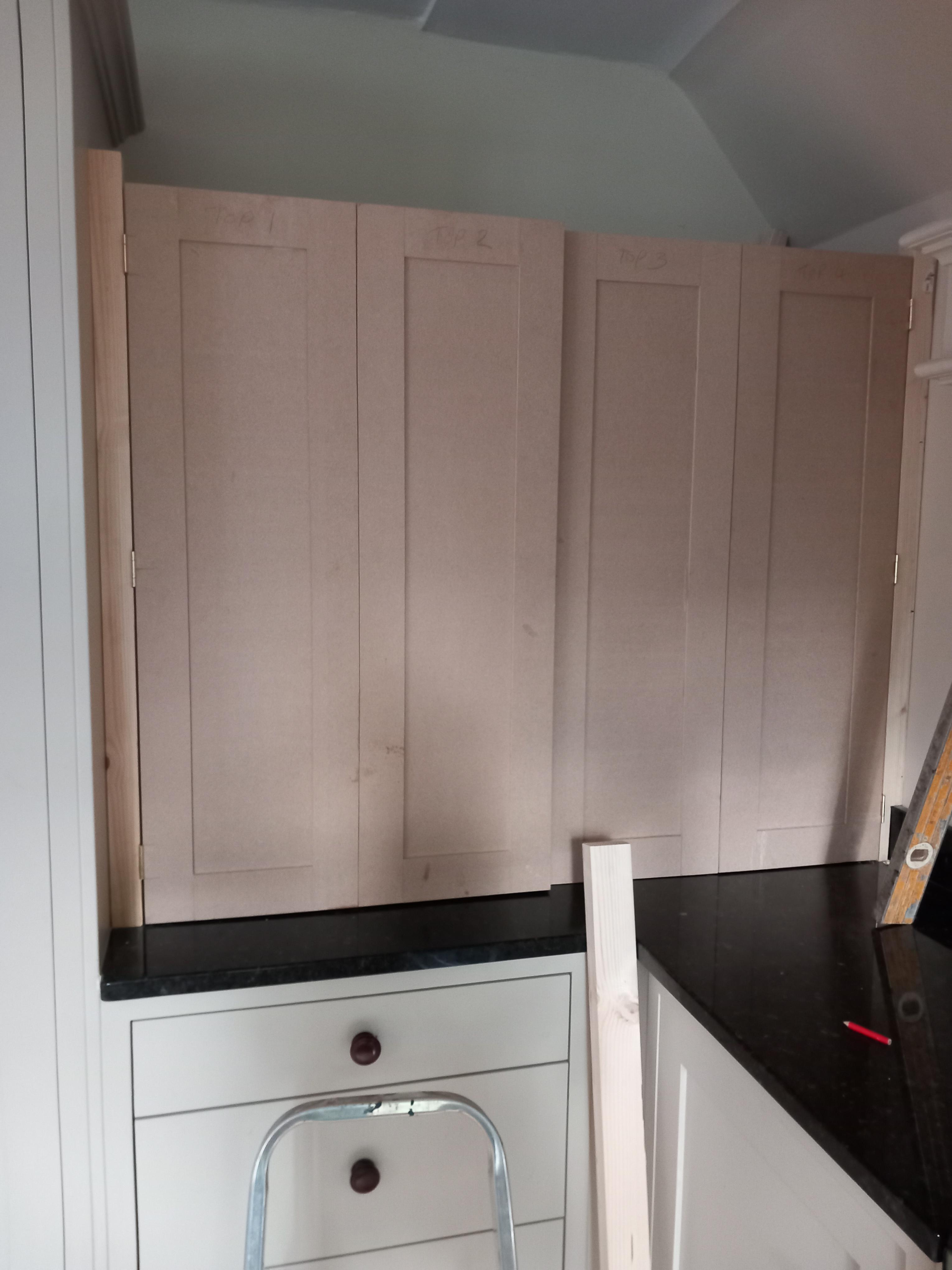

Dee Posted August 12, 2023 Posted August 12, 2023 (edited) Hi Made my own W30mm x H1050mm MDF doors to create 2x V bifold doors. Not using a track ( or should I?) What hinges do I use? Don't want to use euro hinges so would prefer traditional looking hinges. Any more tips much appreciated!! Edited August 12, 2023 by Dee Add image
Dee Posted August 12, 2023 Author Posted August 12, 2023 Also think I've made them too thin....18mm! Am I screwed?
Big Jimbo Posted August 12, 2023 Posted August 12, 2023 If the doors are only 18mm thick you could use a piano hinge. Available in various widths and colours. 1
Dee Posted August 12, 2023 Author Posted August 12, 2023 So would i be looking at 38mm hinge to fit an 18mm think door edge. I don't understand how they are measured and advertised

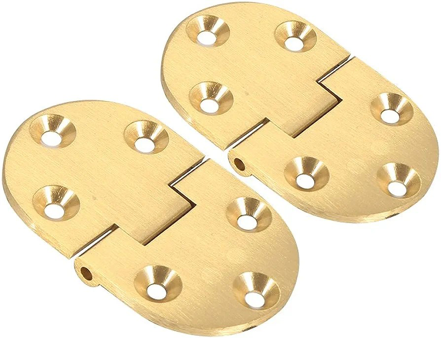

Dee Posted August 13, 2023 Author Posted August 13, 2023 (edited) Hi, it's the hinges for the door to door that I'm struggling with, not door to frame. I've got a total mental block on those hinges! Can't see in my head how they work??? Would these work ( or similar) I would recess into the inside face of the doors and also rout a vertical groove to recess the knuckle. Would that work? Edited August 13, 2023 by Dee
joe90 Posted August 13, 2023 Posted August 13, 2023 47 minutes ago, Dee said: Would these work Yes, IMO, (and look far better than standard kitchen hinges) BUT, you will need short screws which into 18mm MDF might not be good, a piano hinge fixed to the edge of the doors will allow far more screws and longer screws. 🤷♂️ 1 1
PeterW Posted August 13, 2023 Posted August 13, 2023 2 hours ago, Dee said: Hi, it's the hinges for the door to door that I'm struggling with, not door to frame. I've got a total mental block on those hinges! Can't see in my head how they work??? Would these work ( or similar) I would recess into the inside face of the doors and also rout a vertical groove to recess the knuckle. Would that work? You could use those and surface mount them on the inside and then countersink on the face for a small nut and washer - use decent epoxy filler and sand flat and it will create a strong hinge that won’t pull through as easy as screws. Other option is to make them a feature and get some brass plates made up to match the hole size and have brazed studs fitted to the back - using 3mm brass you would end up with a 15mm MDF sandwich but it wouldn’t be cheap. 1

Big Jimbo Posted August 13, 2023 Posted August 13, 2023 I have made and fitted at least 100 of these cabinets over a Twenty year period. to join the Two doors, simply use a length of piano hinge. Various colours and widths available.
joe90 Posted August 13, 2023 Posted August 13, 2023 4 hours ago, MikeSharp01 said: Ah I see - how about the Parliament hinge design to fold back on itself. True but a piano hinge will fold back on itself. Parliament hinges are used to allow doors to fold back on themselves beyond a door frame recessed into brickwork etc.
Dee Posted August 13, 2023 Author Posted August 13, 2023 Thanks guys for the hinge advice. Next problem is making a square frame! I'm fitting the bifolds doors into an existing alcove. The doors are dead square. I've rebated the hinges into the frame. I screwed the frame verticals to the left and right walls. The level says they're straight but the doors don't! What am i doing wrong?
Dee Posted August 15, 2023 Author Posted August 15, 2023 Figured it out now. Old fashioned trial and error. 1
