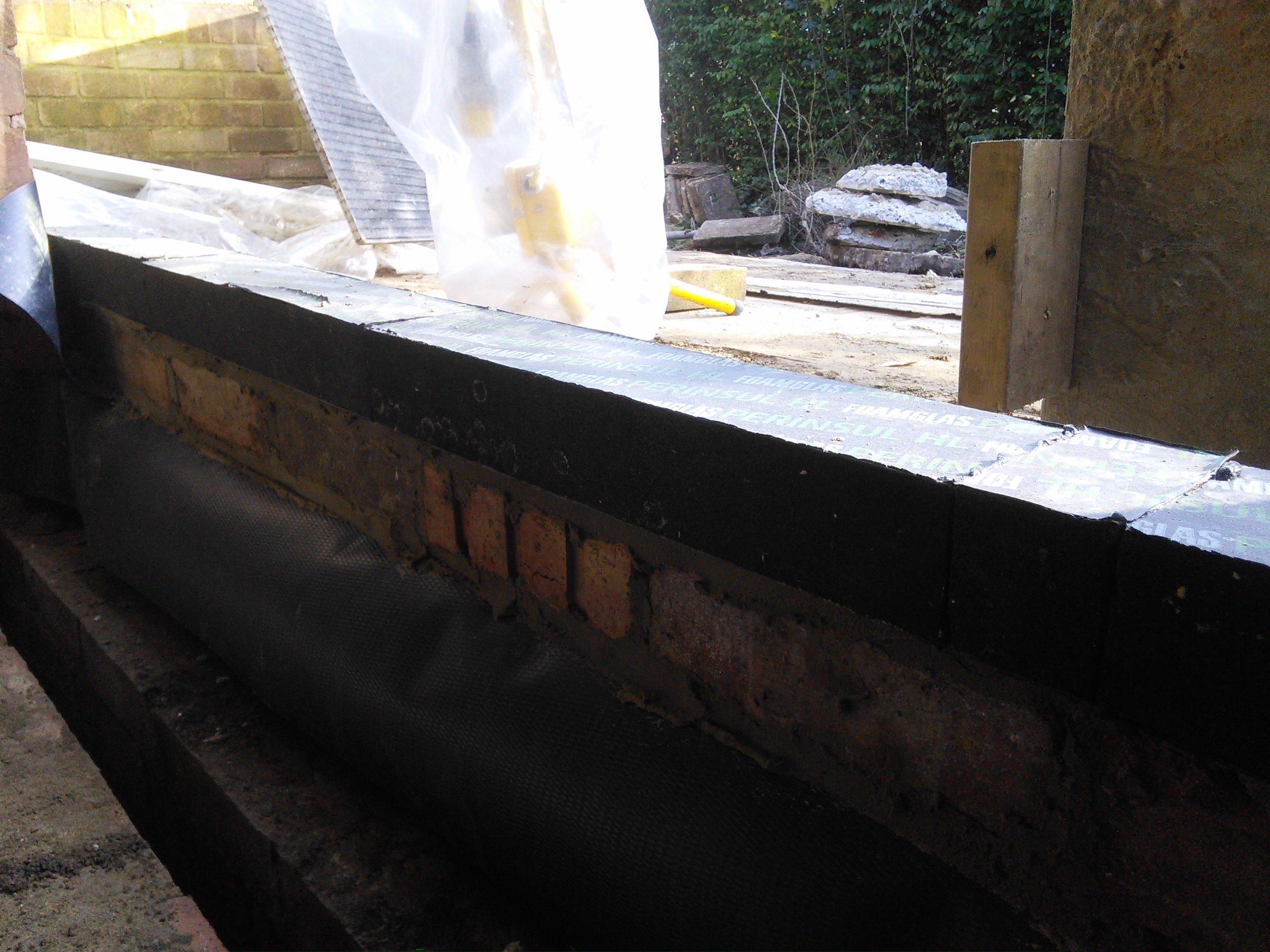

oranjeboom Posted August 22, 2017 Posted August 22, 2017 (edited) 18 minutes ago, Vijay said: Would you be able to use one of these? http://www.marmox.co.uk/products/thermoblock That's what some of my doors will be sitting on. Slab insulation up against it together with some perimeter upstand insulation. Edited August 22, 2017 by oranjeboom Photo

oranjeboom Posted August 23, 2017 Posted August 23, 2017 8 hours ago, JohnW said: Thanks @oranjeboom, good to know someone else is using this approach. What thickness is your thermoblock? 8 hours ago, JohnW said: Thanks @Vijay, that looks interesting. Someone else suggested a similar approach using a different product Foamglas. Have any of you heard or used it? If you look carefully in the pic above, you'll see that's a Foamglas (Perinsul) block. The one above is either around 65 or 100mm high. I've also used Marmox blocks for my SIP foundation walls and they are either 50 or 60mm high. I had to drive to the continent where the blocks vary in width a bit to the ones that were available here in the UK. And you can't stack them on top of each other like a normal brick i.e. one course only. http://marmox.com/products/61.pdf Not fitted my doors yet, but the intention is to screw through the blocks and into the brickwork below.
