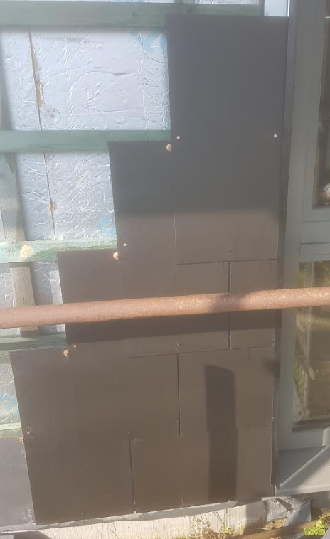

puntloos Posted August 6, 2023 Share Posted August 6, 2023 The tiles I've selected (quite a while ago at this point) are forticrete - https://www.roofingsuperstore.co.uk/product/forticrete-sl8-slate-effect-concrete-roof-tile-pack-of-108.html And a good amount of them look great, but a large amount of them have all types of "white" on them: My question: What's reasonable to expect? Of course the picture on the site is 'perfect' where arguably more than 50% have some level of either "white water stains" or some type of scratching: Could it be a good few raindrops will clear this right off? Or if not, is there some way to fix this e.g. I dunno, spray paint? Or should I complain? Frankly, from the ground level it doesn't look too bad since the viewing angle is pretty shallow, but not a great way to start your new roof.. Link to comment Share on other sites More sharing options...

MikeSharp01 Posted August 6, 2023 Share Posted August 6, 2023 We are cladding our build with the same slates as the roof, which was completed 18months ago - we kept the slates in dry storage, did a corner on Friday and my other half went ballistic, at a distance 2m+ they look great but close up you can see the efflorescence stains and small scratches, only very slight. So now I need to go through 2000 slates and choose the best ones for the front of the house and relegate the stained / scratched ones to high up on the sides (where nobody can see them). I have in the past managed to clean the efflorescence off with a weak vinegar solution. I will get a better picture tomorrow as this one does not really show the issues. Link to comment Share on other sites More sharing options...
MikeSharp01 Posted August 6, 2023 Share Posted August 6, 2023 PS - I was told by a roofer that acid rain sorts it all out, the efflorescence anyway, in the end! Link to comment Share on other sites More sharing options...
saveasteading Posted August 6, 2023 Share Posted August 6, 2023 It should disappear. I had an old tiled wall retiled. Roof tiles on the walls. The replacement tiles were sooty. The replaced and reused were green. They were all stripped and went on randomly. In a year, one side was green, one was clean, due to exposure. Link to comment Share on other sites More sharing options...
