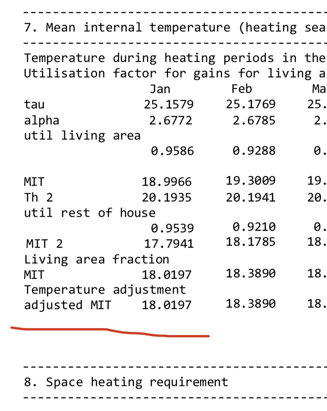

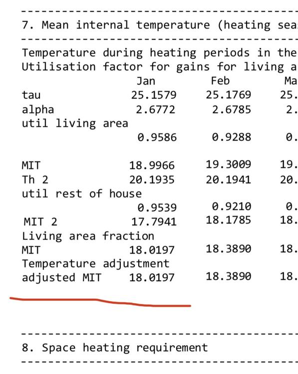

HughF Posted August 8, 2023 Posted August 8, 2023 1 hour ago, Post and beam said: Forgive my ignorance but if i want 21 degrees inside and work on an outside temp of -2 can you extrapolate what the requirement is. Isn't 21 and -2 the usual range? Your sap assumes 4.3 degrees for your location in the winter, which is a shit assumption. And the room temperature assumption comes from section 7, where the Mean Internal Temperature is shown…
HughF Posted August 8, 2023 Posted August 8, 2023 You’ll need to model this in heat engineer, heatpunk, or the freedom toolkit so that you know your heat loss for those required temperatures.
