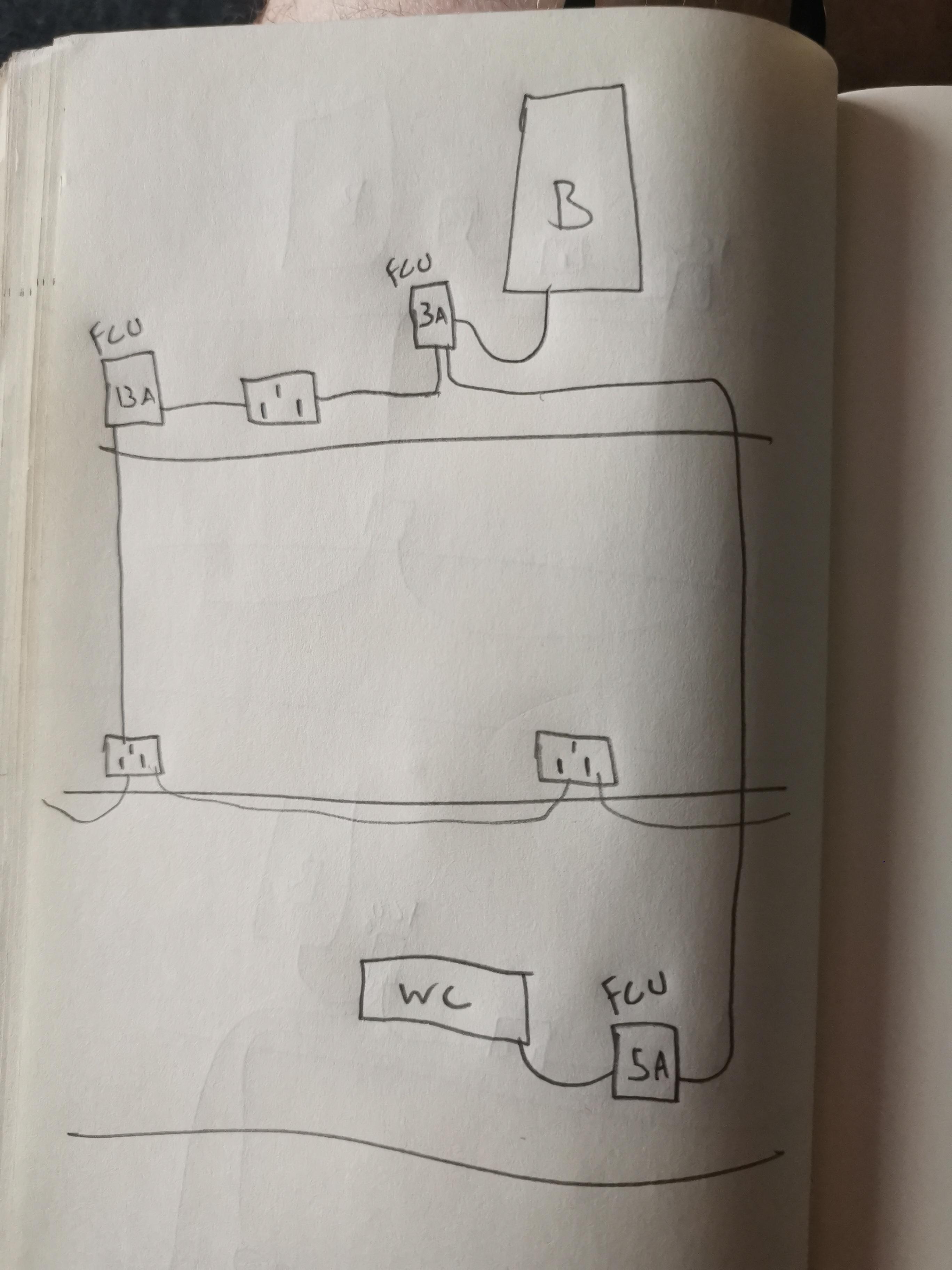

Super_Paulie Posted July 28, 2023 Posted July 28, 2023 I'm sure you knowledgeable lot can answer this in a jiffy, I can't seem to find the answer online. Boiler in the loft, wiring centre (and UFH gubbins) on the ground floor. Should both of these be powered from the same FSU? Just means they are a long way away from each other in terms of local isolation...

Super_Paulie Posted July 28, 2023 Author Posted July 28, 2023 If my Baxi needs protecting with a 3a and my Heatmiser a 5a, how can I run these from the same spurred FCU? Davinci level drawing attached.

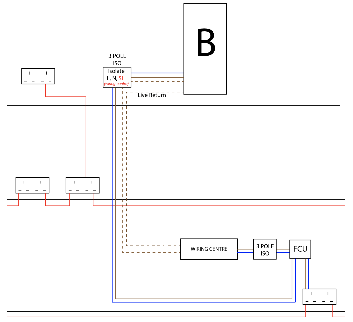

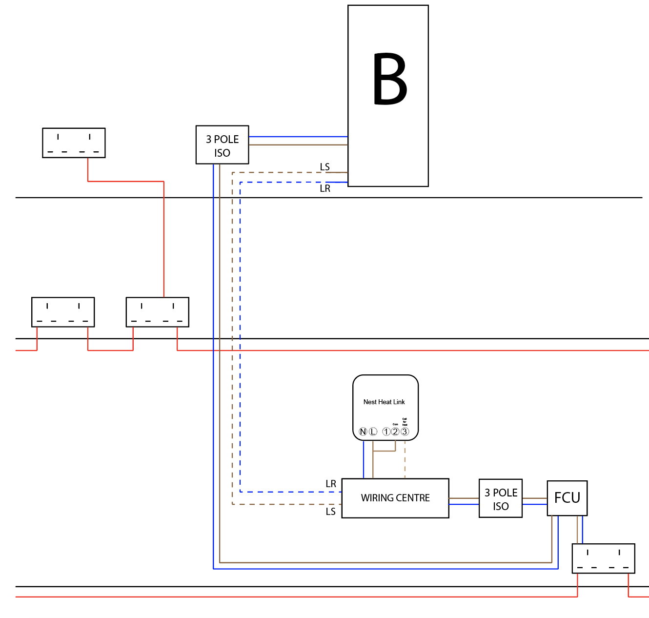

Super_Paulie Posted July 30, 2023 Author Posted July 30, 2023 (edited) On 28/07/2023 at 19:46, ProDave said: The main feed will be to the wiring centre. so FCU there. From there you will need a minimum of permanent L and N and switched L (call for heat) to the boiler. So use a 3 core and earth for that, and locally a 3 pole fan isolator switch would do the job of local boiler isolation. Cheers Dave. So like this? (earths omitted for clarity) I assume i wouldnt need to isolate the live return to the Heatmiser as it the live supply is clipped at the 3 pole. Quick couple of points if i may. Without a second isolator down at the wiring centre i wouldnt be able to isolate it without killing the juice to the boiler, so if i had an issue down there it would also cut off my potential for hot water only. Should i add in that secondary isolator or am i just being overly cautious in regards to future issues? The heatmiser needs fused down to 5a and the boiler 3a, what fuse should i be looking at in the FCU? Cheers fella. Im the type of bloke who needs to draw it all out in advance. Makes for slow work but thats all my brain will accept. Edited July 30, 2023 by Super_Paulie

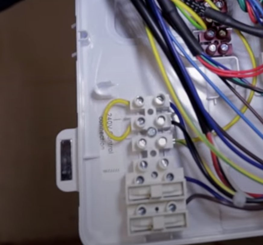

Super_Paulie Posted July 30, 2023 Author Posted July 30, 2023 (edited) 1 hour ago, JohnMo said: I would double check your boiler takes a live demand for heat. Ours needed a volt free demand for heat. its a Baxi 830. To keep it simple im using the "240v control connection" instead of anything OpenTherm as i dont think i need that. Attached picture i found online but mine is the same. The Heatmiser LS (live supply) and the LR (live return) are volt free, so connecting those in place of this yellow loop will call for heat, i believe. Edited July 30, 2023 by Super_Paulie
Super_Paulie Posted July 30, 2023 Author Posted July 30, 2023 1 hour ago, JohnMo said: I would double check your boiler takes a live demand for heat. Ours needed a volt free demand for heat. so i guess.... thats means i wouldnt need to run the LS though the isolator at all as it is never live.
JohnMo Posted July 30, 2023 Posted July 30, 2023 It doesn't look like you need to supply a 240v live as it already has it. The jumper just becomes a switch in the wiring centre. So the two wires just go from boiler to wiring centre not in to the isolation switch. If it wrong someone will be along to say I'm wrong
Super_Paulie Posted July 30, 2023 Author Posted July 30, 2023 12 minutes ago, JohnMo said: It doesn't look like you need to supply a 240v live as it already has it. The jumper just becomes a switch in the wiring centre. So the two wires just go from boiler to wiring centre not in to the isolation switch. If it wrong someone will be along to say I'm wrong i agree, was just drawing that up. Hopefully if we are off the mark someone will advise but im hoping to test this out at some point this afternoon.
TonyT Posted July 30, 2023 Posted July 30, 2023 (edited) No need for a 3 pole isolator. the fcu is the only isolator required. any thoughts for the boiler on its own circuit? Edited July 30, 2023 by TonyT

Super_Paulie Posted July 30, 2023 Author Posted July 30, 2023 23 minutes ago, TonyT said: Run 100 m if you want no reg to say otherwise Interesting, id read otherwise. I'll do more research on that. If I have the boiler 3a and the wiring centre 5a from the same FCU, how would I protect both from a single fuse?
TonyT Posted July 30, 2023 Posted July 30, 2023 Most cables radiate from the wiring centre out ( expect the weather comp that’s direct to the boiler) it’s a cable into the spur, out the the spur into the wiring centre 3a fuse for the lot. you are trying to minimise joints
Super_Paulie Posted August 12, 2023 Author Posted August 12, 2023 On 30/07/2023 at 18:46, TonyT said: Most cables radiate from the wiring centre out ( expect the weather comp that’s direct to the boiler) it’s a cable into the spur, out the the spur into the wiring centre 3a fuse for the lot. you are trying to minimise joints Ok just to confirm before I crack on. I'm ok to run 5 core flex from the wiring centre/spur downstairs up to the loft to power the boiler? Roughly 15m. It just seems I'm getting really contrasting information from 'the web about running such long flex. Cheers
TonyT Posted August 12, 2023 Posted August 12, 2023 Yes it’s fine, flex still has to have a conductor size capable of handling the current like fixed wiring. https://www.tlc-direct.co.uk/Products/CA0dot75HR5.html Max 6 amp current Remember to fit 3 amp fuses in the spurs. Brown sleeving/ tape on any conductors used a switched line/live. 1
