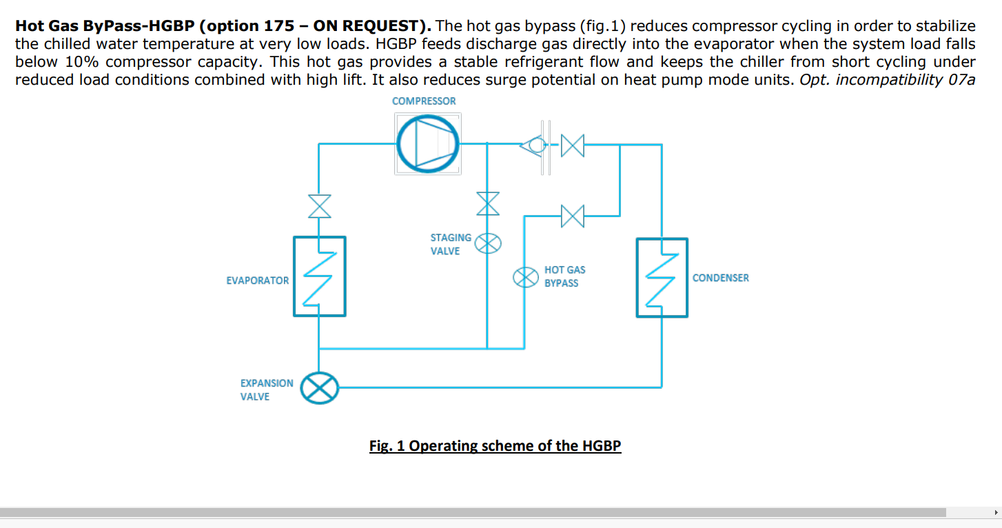

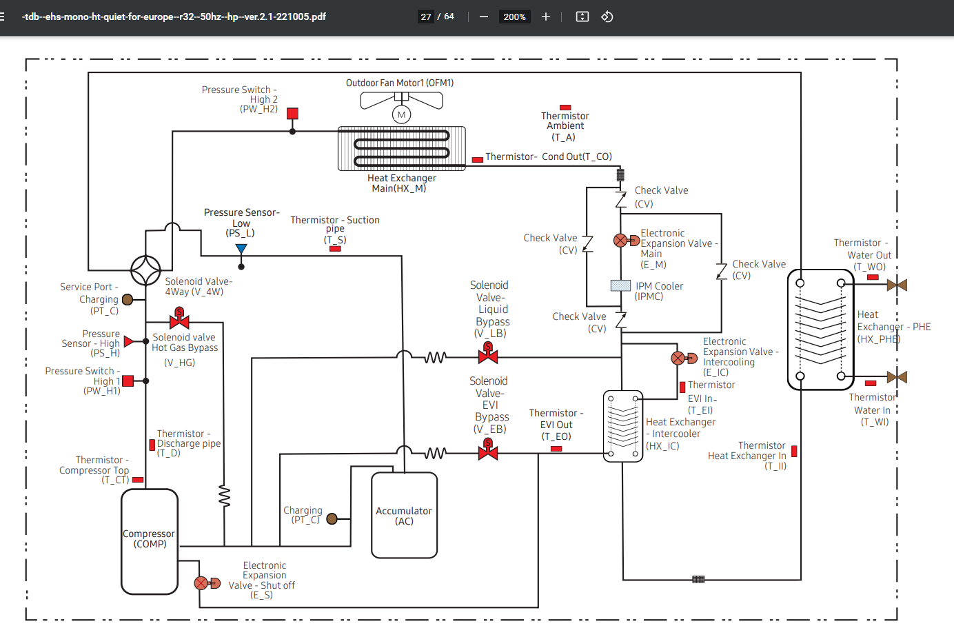

JamesPa Posted July 24, 2023 Share Posted July 24, 2023 3 minutes ago, sharpener said: IIRC @markocosic says they achieve their turn-down ratio by using hot gas bypass which knackers the CoP. I spotted this. The internal piping diagram shows that it does have hot gat bypass. The question, which I don't believe has been answered, is the hot gas bypass there to extend an otherwise respectable modulation ratio (in which case its arguably OK) or is it there because, without it, the modulation ratio is poor (in which case its definitely not OK). Maybe @markocosic knows. Some part load figures for Samsung would help, but so far I haven't seen any. Link to comment Share on other sites More sharing options...

sharpener Posted July 24, 2023 Share Posted July 24, 2023 3 hours ago, JamesPa said: The question, which I don't believe has been answered, is the hot gas bypass there to extend an otherwise respectable modulation ratio (in which case its arguably OK) or is it there because, without it, the modulation ratio is poor (in which case its definitely not OK). Maybe @markocosic knows. Some part load figures for Samsung would help, but so far I haven't seen any. Surely they would not add the mechanical complication unless it was necessary for some performance reason like achieving a reasonable turndown ratio - which may still be uncompetitive so they don't publish it. Hopefully @markocosic will be along to tell us, if he is not on holiday. Link to comment Share on other sites More sharing options...
JamesPa Posted July 24, 2023 Share Posted July 24, 2023 2 hours ago, sharpener said: Surely they would not add the mechanical complication unless it was necessary for some performance reason like achieving a reasonable turndown ratio - which may still be uncompetitive so they don't publish it. Hopefully @markocosic will be along to tell us, if he is not on holiday. They might add it to stop flow/temp errors either end of the season. It probably doesn't cost much, is a well known technique, and anything which avoids call outs is good. Alternatively their compressor modulation might be rubbish. Link to comment Share on other sites More sharing options...

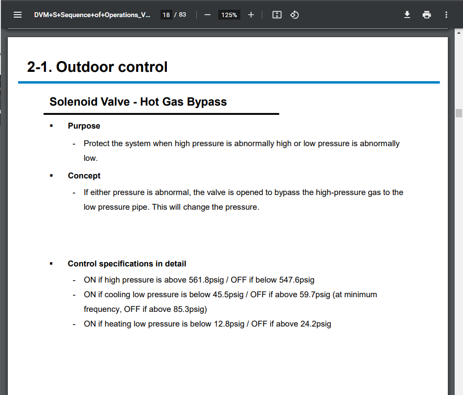

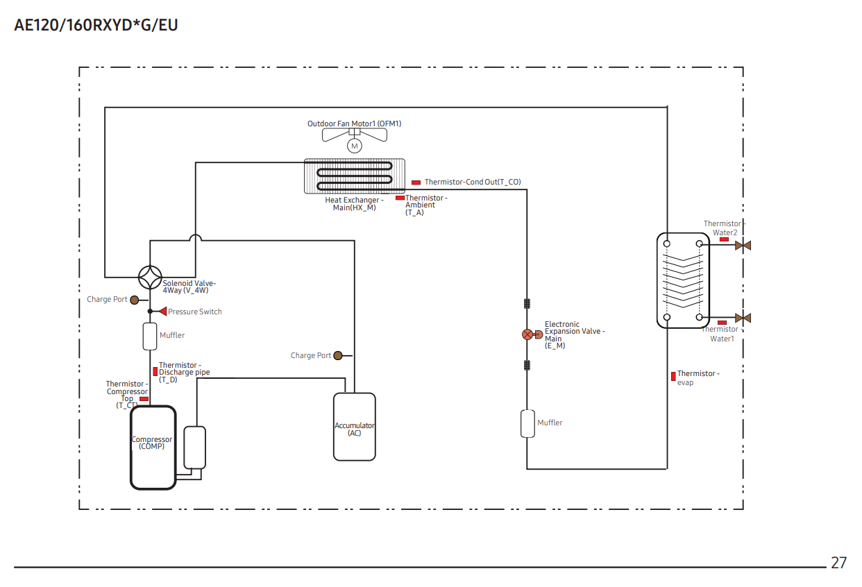

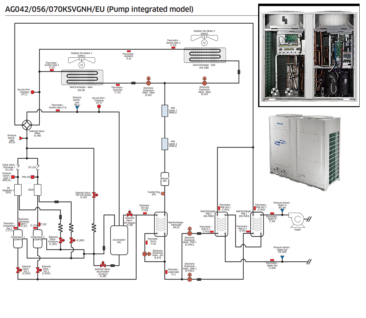

DanDee Posted July 24, 2023 Share Posted July 24, 2023 (edited) 8 hours ago, sharpener said: IIRC @markocosic says they achieve their turn-down ratio by using hot gas bypass which knackers the CoP. The Samsung old EHS range does not have any hot gas bypass/EVI injection, it's pure compressor horse power. The new HT quiet borrowed tech from the big old commercial units, but the hot gas bypass on the Samsung we are talking about should not be confused with the original hot gas bypass and their function on the chillers that used them due to non inverter compressors. In Samsung it has a pressure protection role. On keymark site you can see some data with lower capacity temps, but not what you are looking for. https://keymark.eu/en/products/heatpumps/certified-products HT quiet 8kW Edited July 24, 2023 by DanDee 1 Link to comment Share on other sites More sharing options...

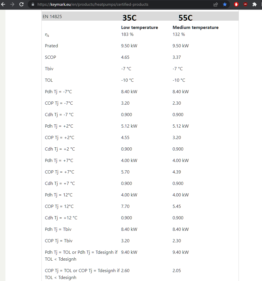

DanDee Posted July 24, 2023 Share Posted July 24, 2023 (edited) 14 minutes ago, Beelbeebub said: What is the bivalent temperature? I've seen it a few times. http://www.gorenje.com/heating-systems/en/heat-pumps/heat-pumps-aerogor/bivalent-systems Humm I found some product fiche from Greece and the COP is lower than Keymark(correction it's the 55C only in the fiche) https://www.ambientclima.gr/wp-content/uploads/2022/11/common-energylabel-ae080bxydeg-eu-ecodesign.pdf https://www.ambientclima.gr/wp-content/uploads/2022/11/common-energylabel-ae120bxydeg-eu-ecodesign.pdf https://www.ambientclima.gr/wp-content/uploads/2022/11/common-energylabel-ae140bxydeg-eu-ecodesign.pdf The lowest output at 12C is 4kW for the 8 and 4.7kW for 12/14 due to the bigger evaporator Edited July 24, 2023 by DanDee 1 Link to comment Share on other sites More sharing options...
markocosic Posted July 24, 2023 Share Posted July 24, 2023 1 hour ago, DanDee said: The new HT quiet borrowed tech from the big old commercial units, but the hot gas bypass on the Samsung we are talking about should not be confused with the original hot gas bypass and their function on the chillers that used them due to non inverter compressors. In Samsung it has a pressure protection role. Great explanation @DanDee That keymark page DOES kinda have the information that you're looking for on the 8 kW plated (but in reality more like a unit that would otherwise delivery say 12 kW at certain ambient temperatures but is capped in software to only deliver 8 kW) R32 Samsung EHS Mono HT. I'm led to believe that the minimum turndown is indeed 4 kW on those. Can operate below this but not without an efficiency hit. One of the Samsung tech chaps strongly hinted at the hot gas bypass being required to do that when delivering heat at lower temperatures. If you look at the Vaillants you'll find that the bigger units (with higher compression ratio scroll compressors and higher sCOPs at the higher temperatures) do better than the smaller units (lower compression ratio rotary compressors) but their turndown isn't anywhere close to as good. The Gen6 Samsungs were rotary compressors. What's the lowest listed output on those? "End of line" pricing might look good. Don't forget all the extra control gubbins that you'll need (needs a special box if not using Samsung cylinders) and ask yourself how they they perform over say 10 years. Might not be worth the saving if they use an extra £1k in electricity over their life? e.g. Basic Samsung G6 that looks a bargain immediately becomes £1866+vat once you add the controller: https://www.theheatpumpwarehouse.co.uk/shop/heat-pumps/air-source-heat-pumps/samsung-5kw-r32-monobloc-air-source-heat-pump/ £2124+vat (though check ratings - the nameplate has little to do with the actual capacity on many units) https://www.theheatpumpwarehouse.co.uk/shop/heat-pumps/air-source-heat-pumps/riello-6kw-monobloc-air-source-heat-pump-nxhm-006/ £3000+vat https://www.theheatpumpwarehouse.co.uk/shop/heat-pumps/air-source-heat-pumps/vaillant-arotherm-plus-5kw/ Find some cycles on here and compare sCOPs for the cycles of interest: https://heatpumpmonitor.org/ e.g. Here's one unit last week reheating a hot water tank. COP 2.5 for the cycle. And another. 3.change for the cycle: Another. COP4 And here's another. COP 4.8 for the cycle. @puntloos that's one Samsung, one Mitsibishi one Daikin one Vaillant FWIW. The worst costs less than half what an immersion does. The best costs less than a quarter. Depends as much on the install detail as the heat pump itself. Space heating will more closely follow the "book" sCOP if it's reasonably weather compensated/continuous. Link to comment Share on other sites More sharing options...
JohnMo Posted July 24, 2023 Share Posted July 24, 2023 23 minutes ago, markocosic said: Find some cycles on here and compare sCOPs for the cycles of interest: Some comments The last curve it was circa 20 degs outside compared to the others circa 15, so CoP should be better. The last one is also heating to a lower temp not going above 55 before cutting out, while the others are hitting close to 60. The first HP is heating cylinder in 35, second one 40, third one 90, the last 70 mins. Way to many variables to pin anything statistical against. You could say the coil size in the cylinder or set point it is being heated is also something that needs to be compared. None of that data is represented. Rubbish in rubbish statistics at its best. Makes good headlines though Link to comment Share on other sites More sharing options...
markocosic Posted July 25, 2023 Share Posted July 25, 2023 7 hours ago, JohnMo said: Way to many variables to pin anything statistical against. You could say the coil size in the cylinder or set point it is being heated is also something that needs to be compared. None of that data is represented. Yes. "It's about the install detail as much as the heat pump itself" They were all from last week. Can conclude that it's stupid to reheat cylinders first thing in the morning vs middle of the day. Can conclude that it's stupid to heat quickly. Can conclude that it's stupid to heat them too hot etc. By a factor two. Some of that week be down to installer/user error. Some down to control available on the unit. Some down to clagging A N Other cylinder onto the heat pump and having only flat out or nothing control available. What are the options available to those buying end of line Samsung units with the control interface to a third party cylinder? Those buying Samsung units with the Samsung tank? Ditto other models. The point was perhaps don't cost yourself more than you save over the life of the asset. Space heat will follow the listed sCOP if output temperature is vaguely compensated. Hot water sCOP isn't listed and varies significantly between setups. 1 Link to comment Share on other sites More sharing options...
