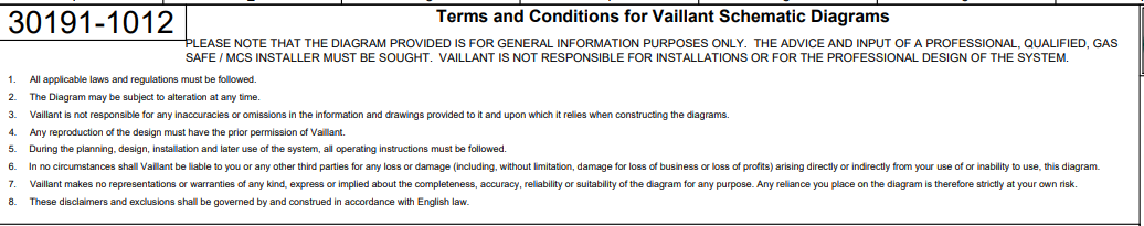

DanDee Posted August 4, 2023 Share Posted August 4, 2023 38 minutes ago, JamesPa said: You mentioned you had the book of approved system designs, any chance of a link please? https://www.vaillant.co.uk/downloads/aproducts/renewables-1/arotherm-plus/arotherm-plus-1/quick-guides/all-schematics-wiring-notes-1799366-2626556.pdf Link to comment Share on other sites More sharing options...

DanDee Posted August 4, 2023 Share Posted August 4, 2023 43 minutes ago, JamesPa said: Thanks to @DanDee for posting the link. There seems to be some ambiguity over who takes responsibility - see the text which appears above the schematics. I think the key question remains: Are their registered installers actually prevented (by threat of guarantee withdrawal) from departing from hq guidelines/rules of thumb or whatever they call them, or are they free to depart if they choose to, with Vaillant withdrawing only the relevant parts of any guarantee? The latter it seems to me is entirely fair, the former not so. That's just telling everyone that those schematics are just an example, and that ultimately the person planning and installing a system is the one responsible to make sure everything is technically safe and sound. It has nothing to do with any product represented in the schematics, or the actual warranty contract one is involved when buying Vaillant products. Link to comment Share on other sites More sharing options...
JamesPa Posted August 4, 2023 Share Posted August 4, 2023 20 minutes ago, DanDee said: That's just telling everyone that those schematics are just an example, and that ultimately the person planning and installing a system is the one responsible to make sure everything is technically safe and sound. It has nothing to do with any product represented in the schematics, or the actual warranty contract one is involved when buying Vaillant products. Which is very logical, however @sharpenerstates upthread that Vaillant take responsibility for the system design if a registered installer is used. Link to comment Share on other sites More sharing options...
DanDee Posted August 4, 2023 Share Posted August 4, 2023 3 minutes ago, JamesPa said: Which is very logical, however @sharpenerstates upthread that Vaillant take responsibility for the system design if a registered installer is used. correct, as the installer will use these schematics as guidance(even thought they are what needs to be done), presents to Vaillant what they want to do and Vaillant gives them the OK. It's just that they had to put some disclaimers on some of these documents, because ultimately it's what is being done on site that matters, warranty wise. Link to comment Share on other sites More sharing options...
sharpener Posted August 4, 2023 Share Posted August 4, 2023 1 hour ago, DanDee said: https://www.vaillant.co.uk/downloads/aproducts/renewables-1/arotherm-plus/arotherm-plus-1/quick-guides/all-schematics-wiring-notes-1799366-2626556.pdf Yes that's the one I have been using. Agree with your comments on interpretation of the boilerplate. I imagine that the degree of oversight by Vaillant will, like any other commercial relationship, depend inter alia on how long the installer has been on the approved list, how often he wants to install "specials", how much aggro there has been in the past, what warranty claims there have been etc. As installers get referrals from the Vaillant "Find an installer" service they will not want to do anything to prejudice this situation. That would include making lots of requests for design approval relative to the number of HPs they actually install, and putting in systems which may result in warranty claims or requests for troubleshooting. So as there is plenty of work around they can afford to play safe. Or so it would seem to me. Having been Business Manager of a contract R & D company I can see this from several different points of view. Link to comment Share on other sites More sharing options...
JamesPa Posted August 4, 2023 Share Posted August 4, 2023 47 minutes ago, sharpener said: Yes that's the one I have been using. Agree with your comments on interpretation of the boilerplate. I imagine that the degree of oversight by Vaillant will, like any other commercial relationship, depend inter alia on how long the installer has been on the approved list, how often he wants to install "specials", how much aggro there has been in the past, what warranty claims there have been etc. As installers get referrals from the Vaillant "Find an installer" service they will not want to do anything to prejudice this situation. That would include making lots of requests for design approval relative to the number of HPs they actually install, and putting in systems which may result in warranty claims or requests for troubleshooting. So as there is plenty of work around they can afford to play safe. Or so it would seem to me. Having been Business Manager of a contract R & D company I can see this from several different points of view. Given all of which is there any realistic chance of persuading Vaillant or a Vaillant specs installer to reuse an existing cylinder with a typical 0.7 sq m coil or is it a lost cause notwithstanding the devastating consequences of the wholly unavoidable continued use of fossil fuels they are effectively encouraging. Link to comment Share on other sites More sharing options...
