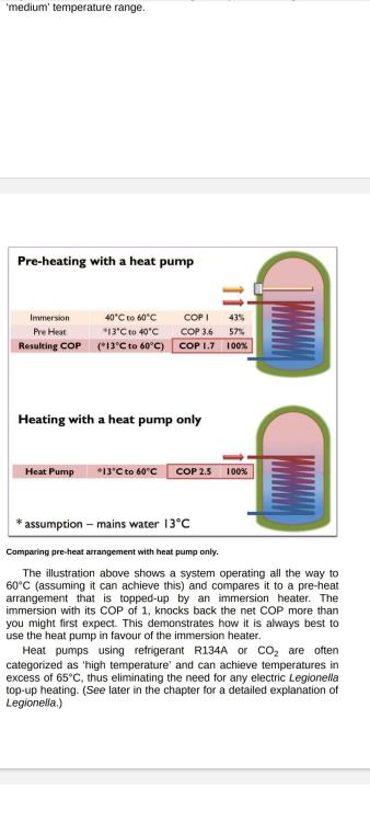

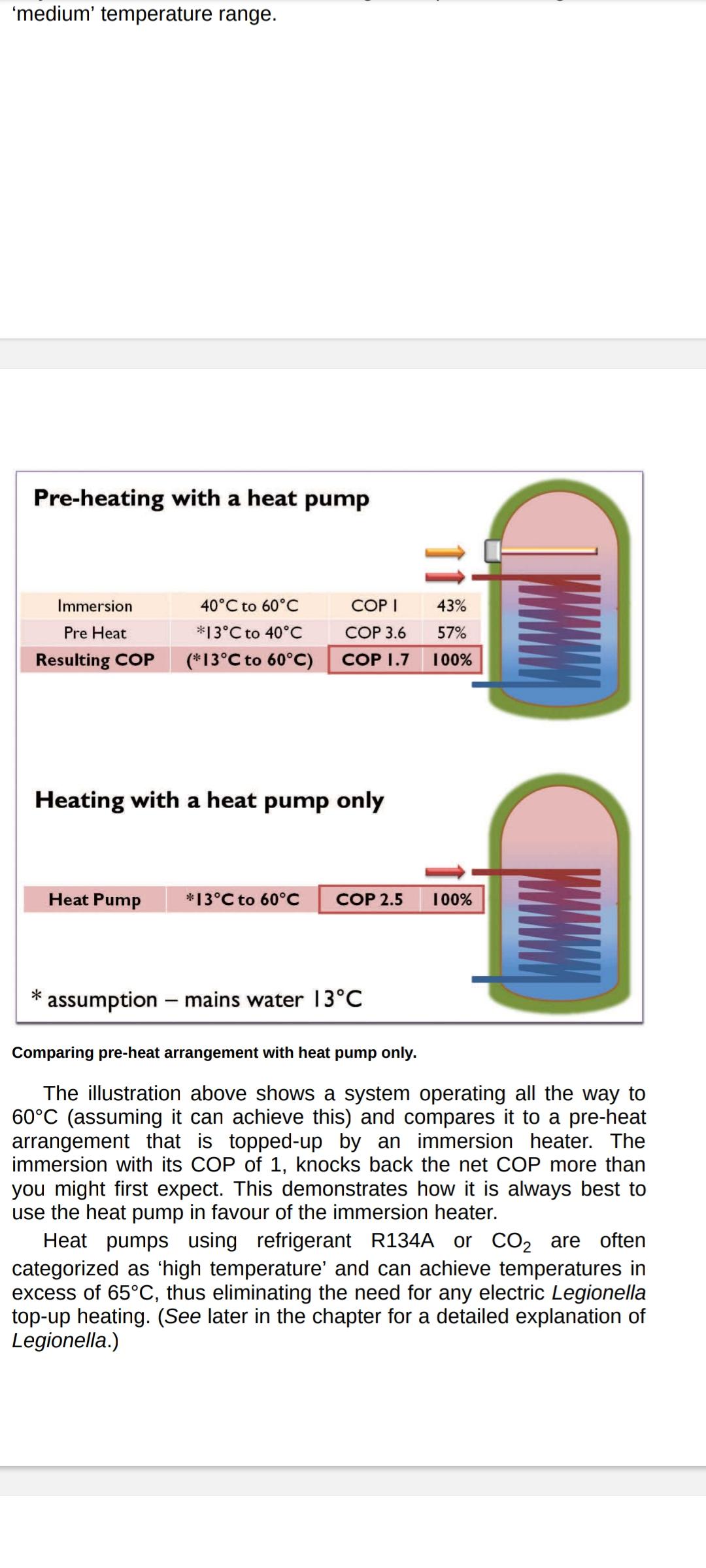

52 minutes ago, JohnMo said:
Still don't understand why you would bother. Run a normal heat pump so your tank temp ends up at 35-40, finish it with the immersion, your overall CoP will still be around 2.5. Basically run ASHP until it trips on high temp, find the temp of cylinder on its thermostat, wind back a degree or 2. Then the ASHP will not be locked onto a never ending heating cycle. Set up some simple logic to kick the immersion into life, heat to your ideal temp, job done. If your flow and return piping gives to much pressure drop, add a pump into the return line, set pump speed just high enough to overcome system resistance, wire so that it switches on off with the 3 way valve.
That would also be an option, and as you point out, fairly simple to arrange.
But an immersion will only ever be a COP of 1.  Even if the COP of the HP running at 65C, with defrost cycles etc is only 1.2, you are still using less electricity than an immersion.
I think alot of HP thinking is still based on the old R410a systems that couldn't even hit 55C. The newer r290 units can hit a Cop of 2 at 65C and 5kw from a nominal 5kw unit.  That's gotta be better than a 3kw immersion.
Attached is an illustration of heating cylinder to 60, if you don't need to heat to 60, the CoP will be better. Take from -
HEAT PUMPS FOR THE HOME
Second Edition
John Cantor
Second Edition
John Cantor
Exactly, and yes, if you can get away with heating only to 55 or 50C then great.
That's an optimisation that can occur after you've fitted the heatpump. You can dial back slowly until you hit the point you're running out of hot water.
