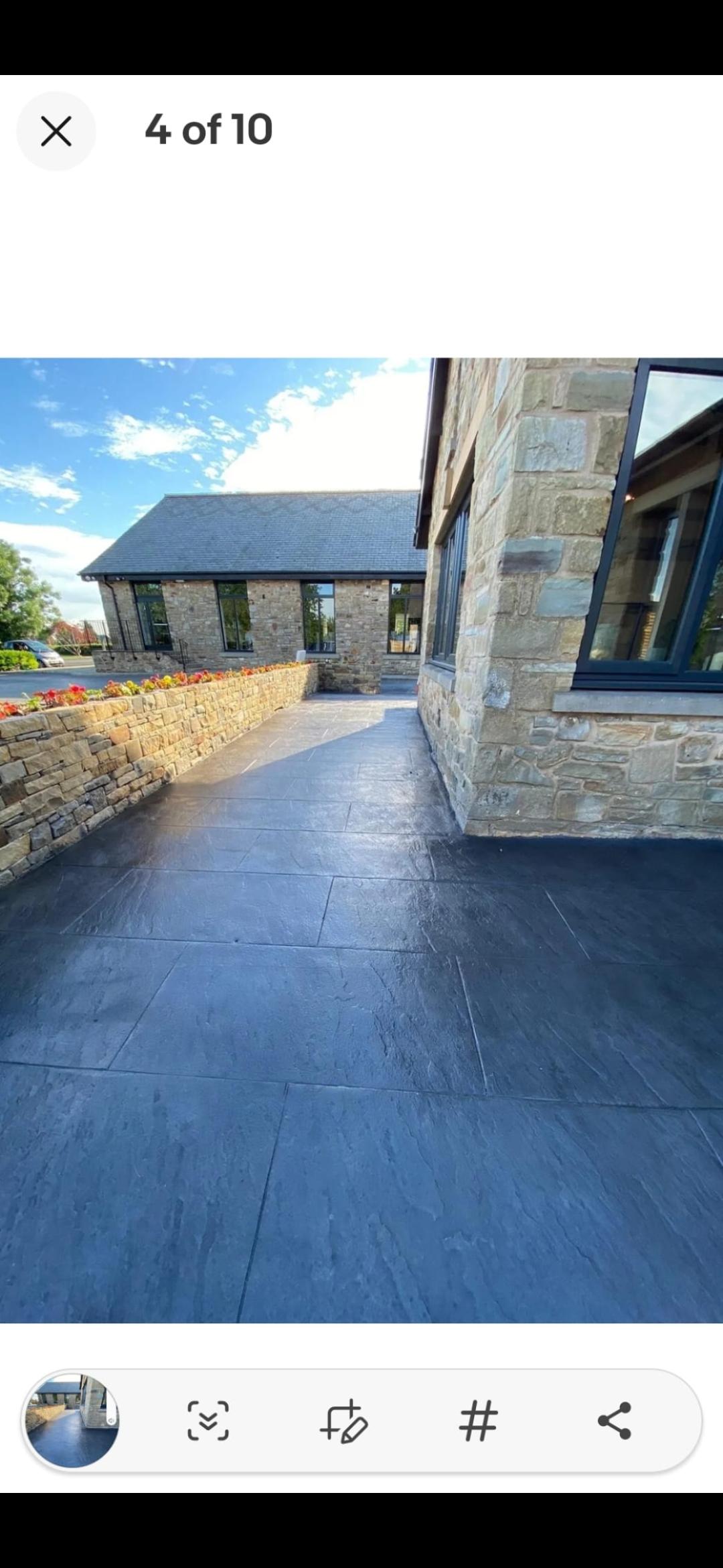

Alexphd1 Posted August 7, 2023 Share Posted August 7, 2023 Parents laid a printed concrete driveway in the early 90's so it approx 30 years old. It in amongst trees so there's a bit of roots close/underneath. It has lasted brilliantly, no cracks and still looks decent/good. They where debating in doing a imprinted concrete again or a reisin bound driveway on newbuild (approx 600m2 driveway and patio) but my sister is having a few major problems with the reisin bound so have decided on imprinted concrete. I am going on a two day training course in October to way up the possibility of DIY. Looking at a cobble effect for the driveway and a large tile effect for the patio * see picture below 1 Link to comment Share on other sites More sharing options...
saveasteading Posted August 8, 2023 Share Posted August 8, 2023 17 hours ago, Alexphd1 said: am going on a two day training course in October to way up the possibility of DIY. They should be teaching mostly about concrete laying and crack control in general. The imprinting is important but not the biggest issue in the long term. I've seen cobble effect so well done that it took a real effort to see it was concrete. Also some very bad, mostly with random cracking. I'd have fibres in the mix. Let us know if that is standard please? 1 Link to comment Share on other sites More sharing options...
Alexphd1 Posted August 8, 2023 Share Posted August 8, 2023 1st day is theroy, 2nd day practical laying 30m2. Link to comment Share on other sites More sharing options...
saveasteading Posted August 8, 2023 Share Posted August 8, 2023 1 minute ago, Alexphd1 said: practical laying 30m2 Sounds good. I am imagining a car park covered in 30m2 patches of variable quality paving. 6 x 5 isn't enough to need a contraction joint, but I seriously hope that one is included anyway. Its probably the trickiest thing. Otherwise.....they're just selling stampers. Link to comment Share on other sites More sharing options...
