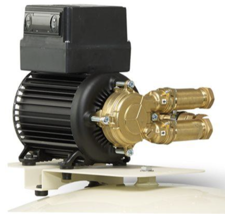

2/ My builder's go-to is
- https://www.stuart-turner.co.uk/product/mainsboost-mb-100sv-1-22-44452 and https://www.stuart-turner.co.uk/product/mainsboost-charger-wall-mount-mbc-12-28-wm-44726
image.png.a70ffd9fe9082c0ae3fbd39620fa19a9.pngimage.thumb.png.a979390c24b40933f38eb496c1c1bc5c.png

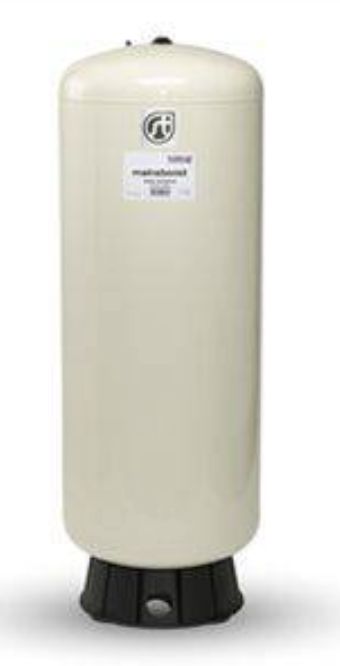

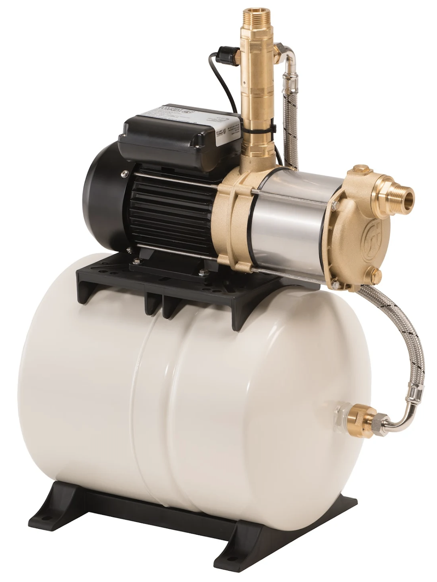

-> this is a large amount of kit. Do we really need a tank? Of that size? Can't we just use e.g.
https://www.plumbworld.co.uk/stuart-turner-aquaboost-abp-f120-50-1h-1-centrifugal-pressure-set-pump-44622-19703-1253840
Which might just fit under a sink. Do we even need a vessel?
3/ I understand it's best to put it close to the incoming water mains, and also our hot water cylinder is near incoming mains, but frankly we have very little space left in that area. Is it sane/possible to put just the booster system in the loft and then drop the water back down from there?
Edited by puntloos
I fitted One at my daughters. It didn't have a vessel. It increased her water pressure to 1.5 bar. There was a single main that supplies her and her next door neighbour. Without it her water pressure was dreadful. She is single so just has the kitchen, and One bathroom, so serves her well.

So what's the point of all the big vessels etc? I could understand it if we are in fact not allowed to 'pull' more water than given, since then you could use the vessel for temporarily pumping out more than is coming in, but in all other cases is the purpose only to resist certain start/stop conditions?
The vessel is basically an accumulator, which is a cylinder with a bladder inside. One side of the bladder is water filled the other is pressurised air. The pump fills the cylinder to a pre defined pressure - expanding the bladder. When you open the tap, the pump does not run, instead the bladder pushes the water out of the cylinder - the bladder deflated as the water is used. When the pressure drops to a pre defined point the pump starts and re pressurises the cylinder.
You are just filling a big bucket for use later. You are not using any more water than normal.

Just a quick note...you can't actually put a pump on your incoming mains which exceeds 12 litres per min...I think what you have there definitely would. You need a break tank to store the water then pump the stored water. Whole home boosters that just provide the 12litres per min are rubbish...I expect you have more than that currently.
Those accumulators are ok, although they need to be sized correctly. If you are going down the route of all this cost you are much better off spending a bit more and having a break tank you can then pump from as much as you want!

My understanding is that the accumulator can be before or after the pump...
If its before the pump it's purpose is to reduce the peak flow rate required from the mains. It fills slowly and the pump empties it quickly. It needs to be large enough to cope with showers. Used when the flow rate from the mains is inadequate. A flow sensor is used to trigger the pump so it runs as soon as you turn on a tap. Can be used if more than one house is at the end of a long/narrow supply pipe. A large cold water vented tank in the loft feeding a pump is an example.
If its after the pump it's normally to reduce cycling of the pump. Pump only runs when the pressure in the tank falls. So you can run a tap for a short period and the pump won't need to start. Can be used when the mains pressure is low but the flow rate is OK. Shouldn't be used if more than one house on a long/narrow supply pipe as it can rob the other house.

We have a Salamander whole house pump it works on negative and positive systems and you can choose 1,2 or 3 bar on the settings very easily.
we live in a converted barn, it was converted 20 years ago and not by us.
were listed and have 3 floors so just went for a whole house system that was easy to install. The rainfall shower that used to just drip is now very good.  We found 3 bar too much so it’s set on 2 but when we rent out we could change it to 1. It’s not really quiet but boxing it in and sound insulation and sitting it on something solid all helps.
