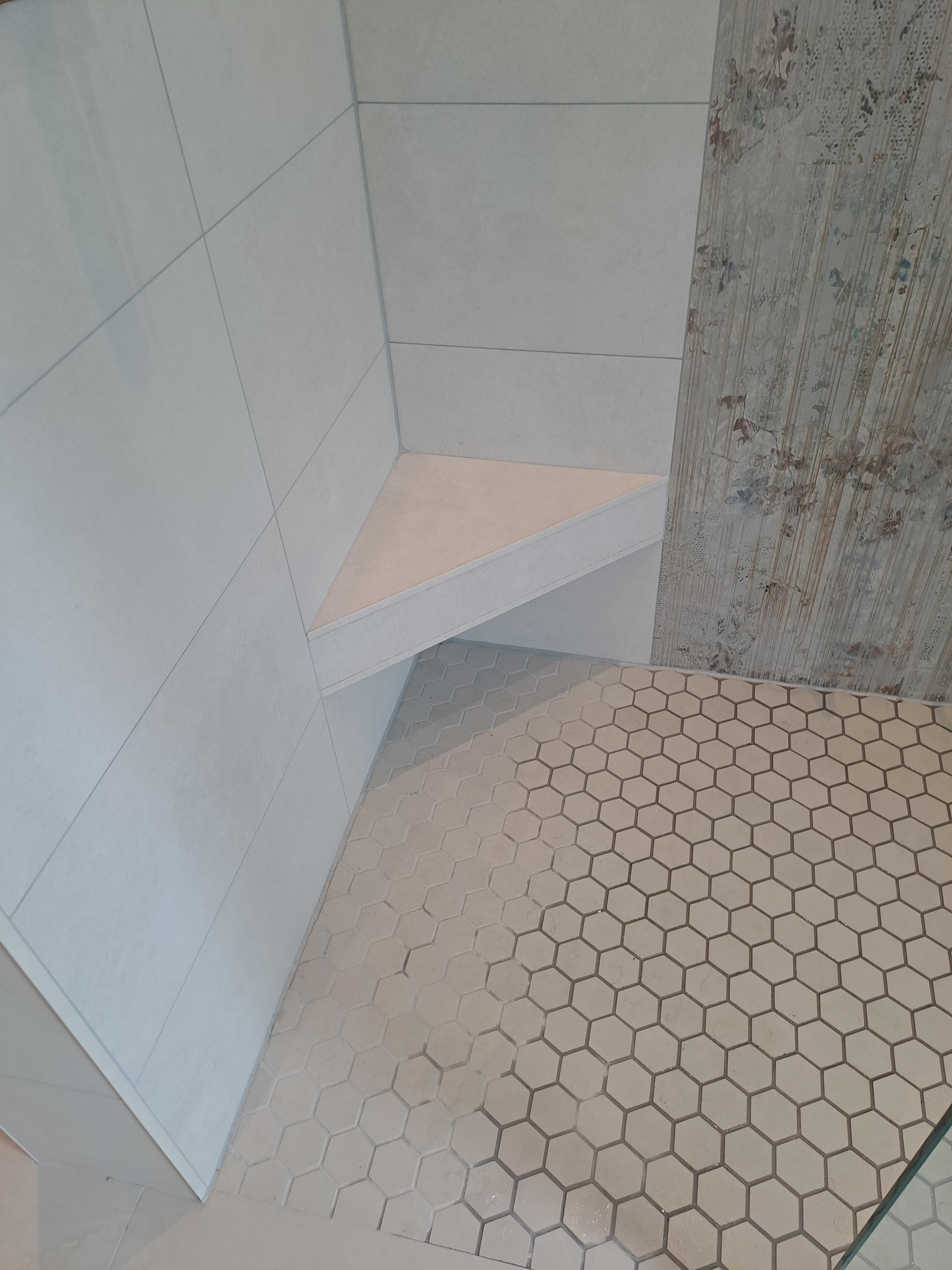

Brendan Posted July 12, 2023 Share Posted July 12, 2023 Before first fix plumbing I bought all the bathroom furniture at my builder's request. This included wall-hung vanity units for all three bathrooms. The downstairs shower is also supposed to have a seat and handrail to make it suitable for elderly relatives to use should the need arise. The bathrooms are all in the timber frame extension so essentially the walls are boarded stud walls, whether internal or external. From the pre-boarding photos I have, I can't see any extra bracing/noggins/ply board that would support these things. It is possible something was put in, but in the absence of photographic evidence I would assume it hasn't been (I have asked the builder if they can supply any evidence). The bathrooms are all fully tiled now, so I have no inclination to undo all of this to find out what's there. 1) Is the Hardie backer type board within the shower enclosure able to support any load, or is it more or less the same as plasterboard in this respect? 2) If there is no evidence of any support behind the plasterboard, I assume I am right that I am going to be stupid doing anything other than buying new floorstanding furniture? Picture of the downstairs bathroom pre-boarding, for example: Link to comment Share on other sites More sharing options...

Brendan Posted August 3, 2023 Author Share Posted August 3, 2023 It’s a shame they can’t confirm whether they’ve done any preparation for the shower seat that needs to support the weight of a person. Something that we talked about several times. Link to comment Share on other sites More sharing options...

Conor Posted August 3, 2023 Share Posted August 3, 2023 Hot does the shower seat mount? I made my own out of ply and made sure it was wide enough to screw in to a stud on each side. Link to comment Share on other sites More sharing options...
Brendan Posted August 3, 2023 Author Share Posted August 3, 2023 The shower is already tiled, so in the end I have opened the wall from the other side. They had installed a sheet of OSB (probably 18mm) with some extra noggins. I’ve taken the opportunity to add another 18mm ply securely fixed behind the OSB. The specialist disability bathroom sites I found generally recommend 36mm to fix a seat into. I could have just bought a floor standing seat, but I wanted something discreet that would fold away when not needed. Link to comment Share on other sites More sharing options...
