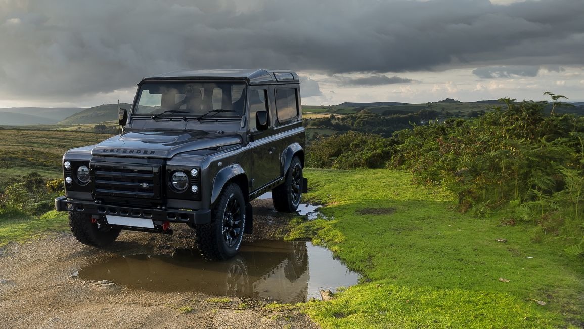

Barney12 Posted June 8, 2016 Author Posted June 8, 2016 (edited) Thanks. Yes passed my test before 97. im wondering if I do need a tipper, for the occasional bulk loads I guess I have a spade EDIT: I do rather love my Defender. Although it's more Chelsea Tractor than Panel Van. Despite that it still gets plenty of abuse. It's designed to be used Edited June 8, 2016 by Barney12
